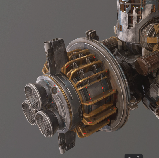

Here is a screen shot directly from the game, everything is so shadowed, but you can see the gold effect that I was trying to achieve. It took me a while to understand what it was, but the front gold ring has a gleam in the middle, due to two little "headlights".
I am not sure how I will drill the windows. No matter where you look they are all in perfectly straight rows, so nothing I will be able to eyeball. I have a miniature drill-press for my dremel, if I turn it to drill horizontally, all I need will be a kind of turn-table to turn the pieces and keep everything aligned.
On the nose, you can see that there are two openings on each side in the middle, as well as a larger round opening on the lower side. These are not in the in-game screenshot above. The Argo has two aerospace bays according to battletech specs, but they are never used in the game. Now this is a little bit of my own interpretation... As the Argo crash-landed on an airless moon and lay there for over 2 centuries, I am assuming that there just was not a priority to repair landing bays for a mercenary unit that had no aerospace fighters... the solution was to just quick and dirty patch up the bay door openings to ensure that the ship was space-worthy. After that, "out of sight, out of mind".
The larger round opening below the other two is not mentioned in any datasheets, but my interpretation is that this is a landing bay for larger shuttles and "repaired" in the same fashion. In fact, if you look closely, you can still see the very bottom of the circular opening behind the plate of steel covering it.
I have no idea what the producers at Harebrained Schemes were thinking of when they decided to do a last minute conceal of the bay doors, but the fact that they are there in the original designs but hastily covered up with scotch tape for the game, screams "Not now, but in the sequel you will get aerospace fighters!"

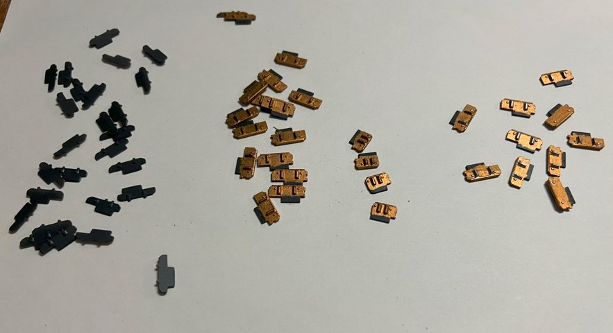

But can somebody tell me, whose bright idea it was to think painting all of these was a going to be fun?!?!?! :p
First pile primed front and then back, second pile coated with a copper base, and third pile steel grey finishing on the brackets and four tiny bolts... and the fourth pile that does not exist yet, will be to touch up where Mr. Butterfinger couldn't keep a steady hand.
I tried dry-fitting them in the reactor module slots... they fit but only with a bit of muscle-grease. I absolutely want it to be a tight fit, but these fins have literally the thickness of a business card and it feels like I am on the verge of breaking something when I am putting them in, so I will sand the tabs that insert into the reactor down by a hair.

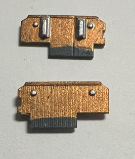

For the coolant fins I have 3 different variations in mind concerning the metal grey brackets. I have not yet decided which I like better.
Here a picture from my 3d design, It is difficult to zoom in on the actual pieces to see a difference, but I will try to get a before and after picture up.
  1. Completely in Bare Metal Grey... The problem with this version is that the little screws next to the brackets are harder to see and optically almost merge into the brackets of the same color.
  2. Brackets in Bare Metal Grey, but only down to the base of the bracket... Although it is almost too much contrast, I like this version better as No. 1, but it just seems like something is missing
  3. Brackets in Bare Metal Grey down to a base in Gun Metal Grey... I like this the most, but the potential for un-straight painting lines is x3 of the other two versions.
Once I start weathering and applying washes, my opinion might change dramatically, so I created 3 test groups that I will wash and weather to see how the final product will look.

Thanks for your thoughts. Yes, that did cross my mind, and generally that would be an option, but in my case, it wouldn't work as there are red lights at the tops of the fins and my idea is to let light travel through the inside of the (hopefully) transparent fin, to a spot at the top that is not light blocked. With my printer, you usually do not see any layer lines, but for some reason, if the surface is at exactly a 90 degree angle to the print bed, I get vertical lines (as opposed to horizontal layer lines that you often see in 3D prints). If I tilt the model just a couple degrees up or down, it is smooth as a baby's butt. As I printed these without sprues, there was no other option as to place them at a 90 degree angle.
I actually kind of like the texture on the fins... I am thinking ahead to the washes, that that should give it some nice characteristic. Besides, it kind of makes sense for the fins to have some sort of texture, after all their main function is to disperse heat (similar to a radiator) and the more surface space, the better the heat dispersal.
You can see the vertical lines quite well in the picture in the post before last. I printed them with Elegoo translucent (which was not very translucent in my opinion). In the meantime, I have printed a second batch using a transparent red (I think also from Elegoo but I am not sure). It did not turn out crystal clear as I had hoped, but definitely transparenter as the first attempt. The funny thing is that although it was the same print file, with the same settings, on the red transparent resin, there was almost no lining on the sides. I think I read somewhere that transparents need a bit more exposure time as normal resin, maybe that had something to do with it.
Aside from that, at least with my mediocre skill, I would say the chances are high that I would not be able to cut all the pieces so that in the end everything looks symmetrical. ;)
