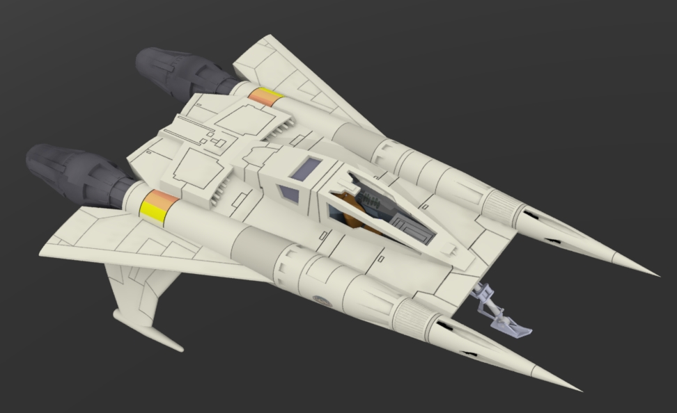

So i download the link you sent me and it was an OBJ file with texture maps
Looks great.
Same file without texture maps. most of the detials
go away but still not to bad.

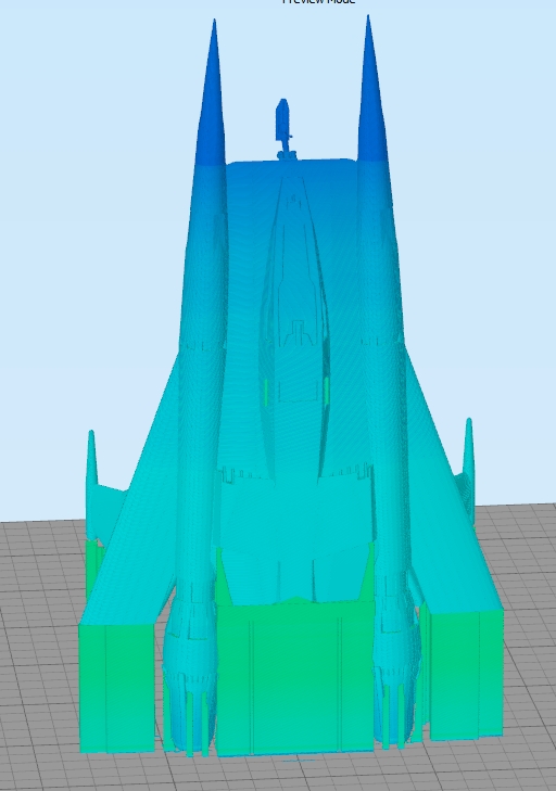

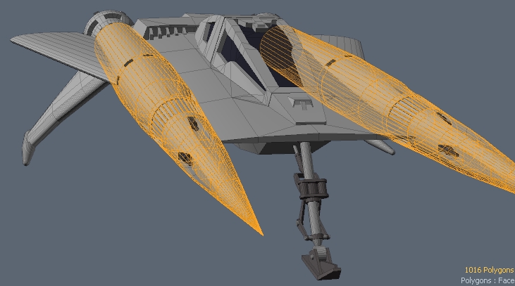

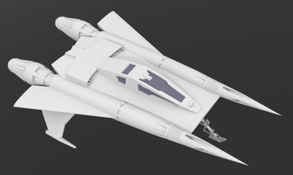

Ok slight problem none of these parts are welded together
The orange part means it's selected,. If I hide that part I get this
A lot of parts that are free floating. meaning they are attached to nothing.

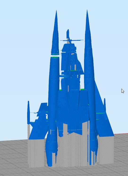

There are also overlapping polygons, un-welded vertexes etc. meaning if you load it into a slicing software you will get this
A giant unprintable mess
I was able to fix it somewhat by taking it into Zbrush, making a dynamesh and re projecting all the details onto it.
In layman terms I made it one solid piece and the re added the details to it.
Not great But I only spent a couple of minutes on it.
I think you can do the same thing with Autodesk Mesh Mixer or Meshlab. They are both free.

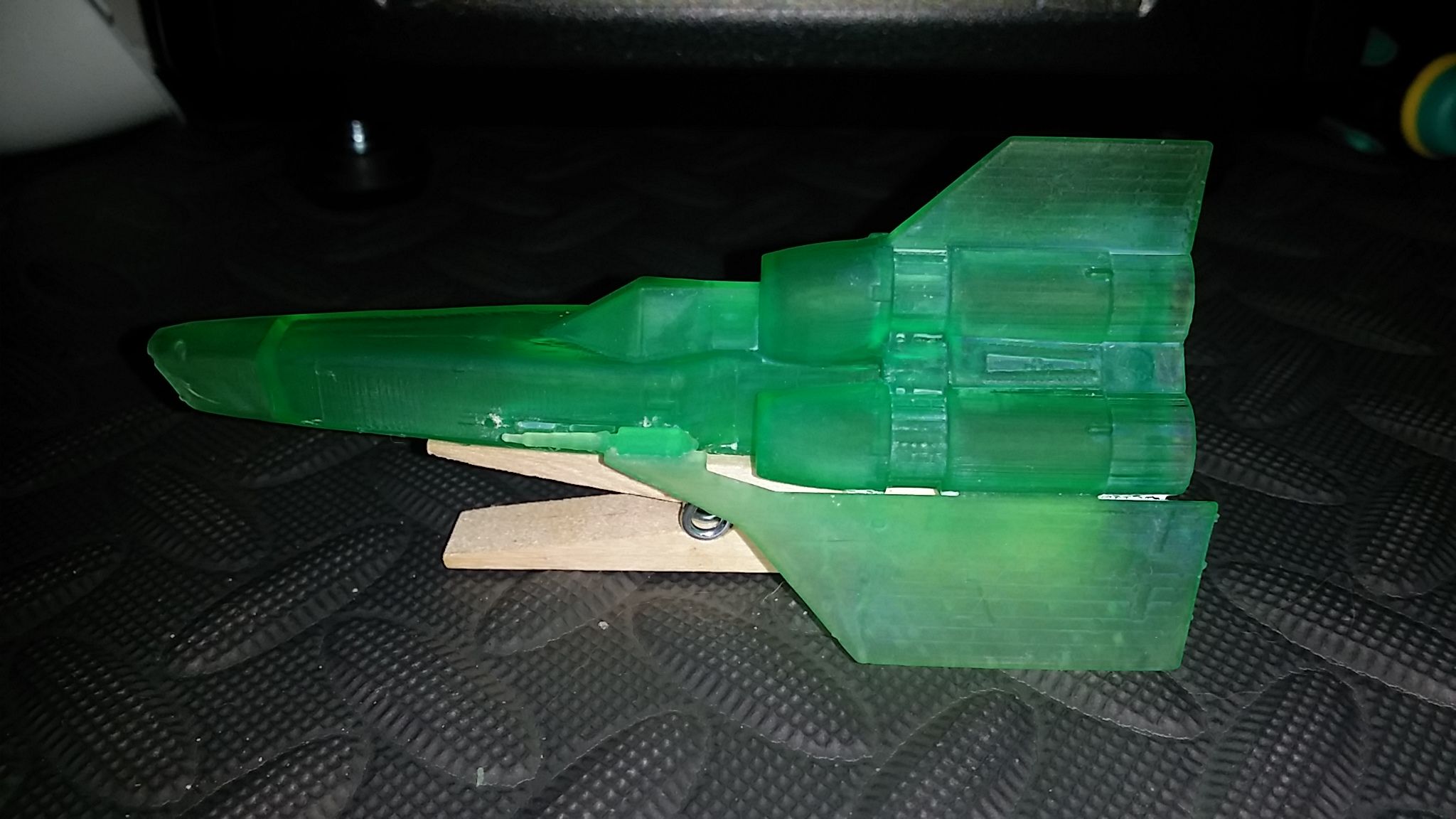

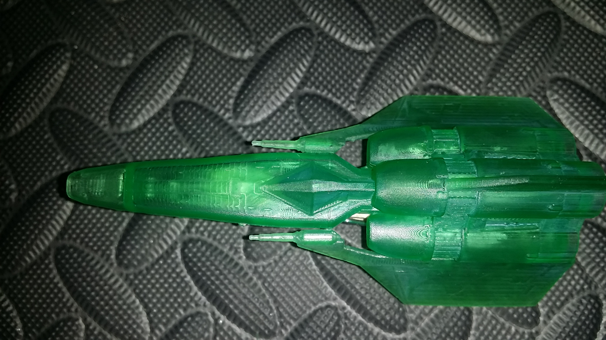

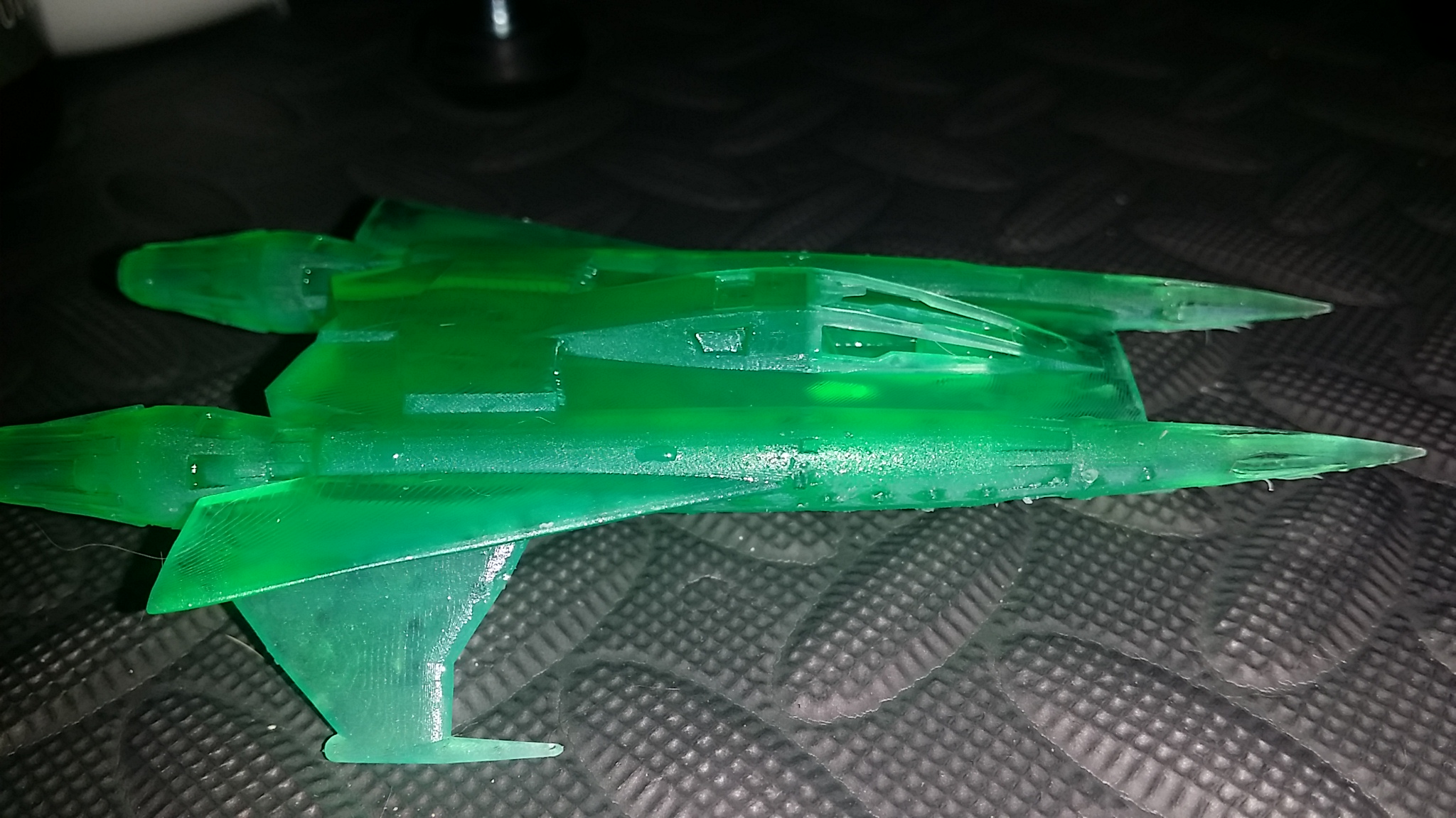

Okay first prints :)
I know this is going to sound like an excuse but it isn't. The prints look better in person, the resin I'm using right now is a bit translucent and these are right out of the printer and after the IPA and water bath, and are still wet in spots. This is also before curing. I cleaned up all the support structure area and learned that next time it's probably better to do the cleanup before throwing it under UV for curing. Once cured the resin gets hard. The Viper is already primed with white primer and drying. It's getting ready for detail painting and weathering. It is already taking on a different look than the translucent green resin. I'll have some pictures up later on after it's painted and show a side by side size comparison with my Bandai X-Wing and Moebius MK II Viper.

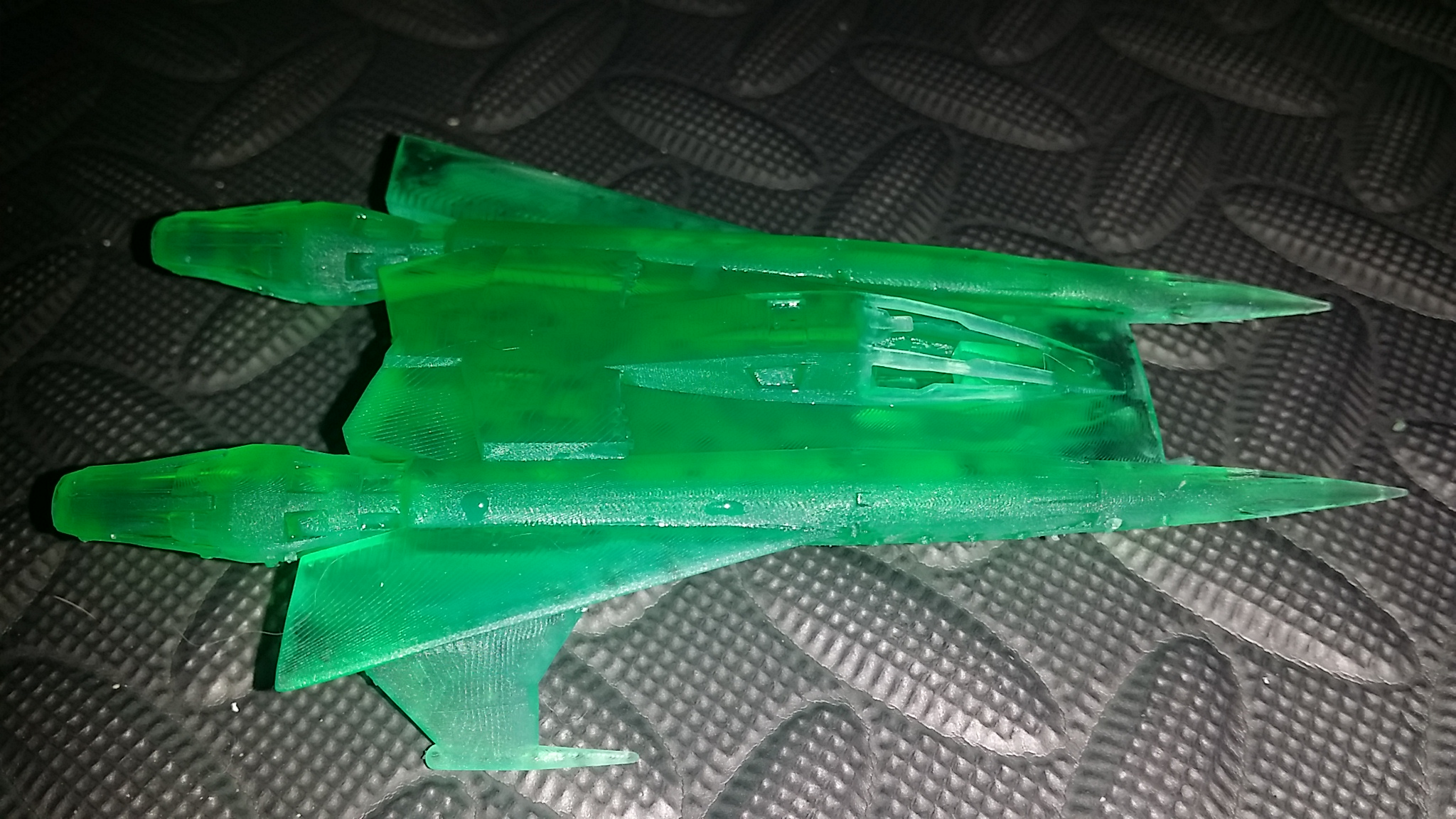

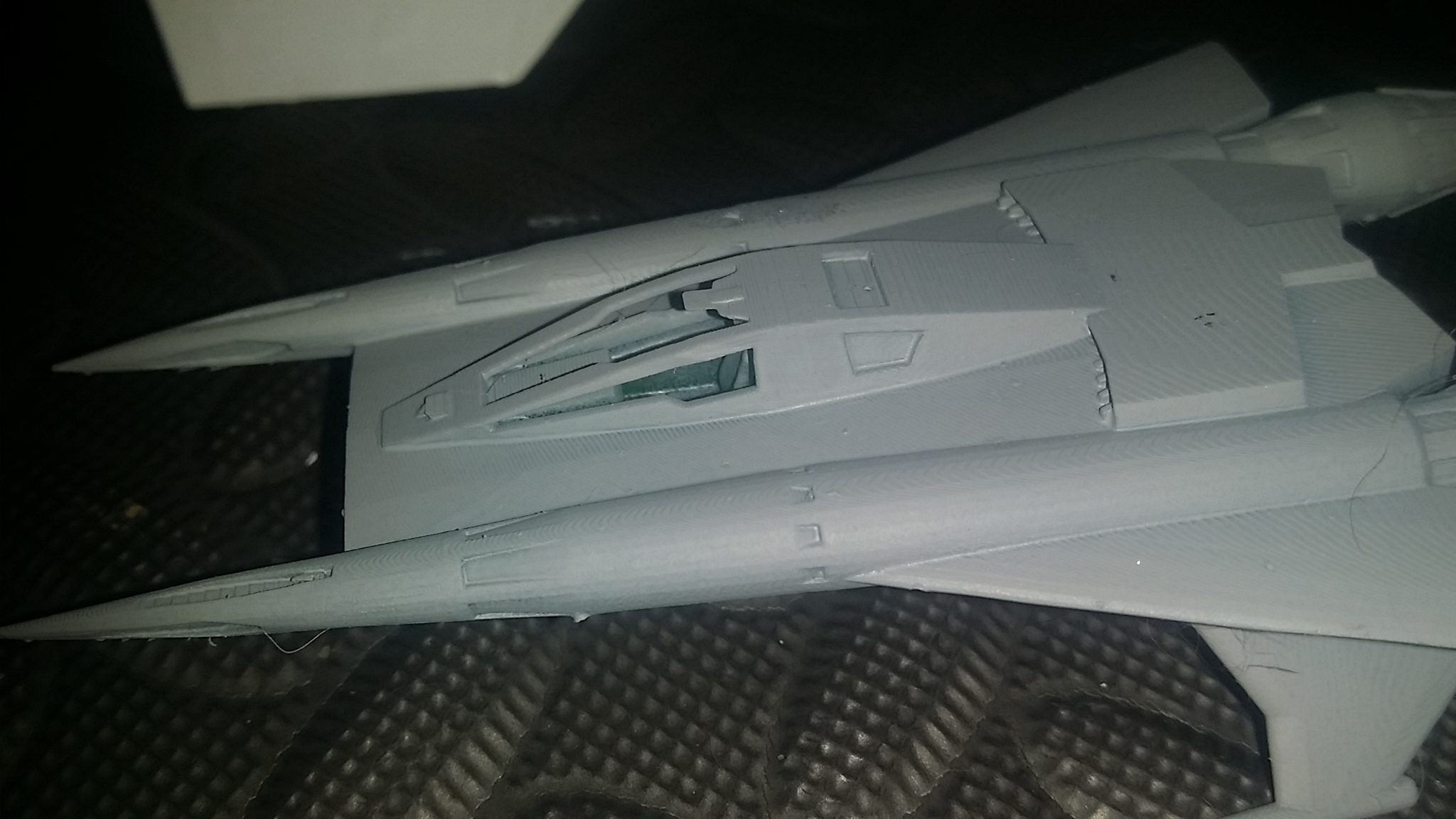

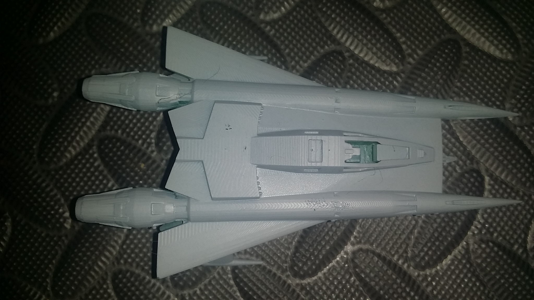

This next one is a ship I have been wanting for a LONG time! I particularly like this print because we didn't think this was a printable file and it ended up printing just fine.Even the cockpit console and seat printed, although the flight stick doesn't look like it's in there because it was probably too thin to properly print. Again this is before curing and right after the IPA and water bath. It looks a little scuffed because I started fine sanding the support contact points. The support contact areas really aren't that bad to deal with, but it was something I didn't anticipate. It also could be the way I did the supports. These are default settings and basically I don't know what I am doing yet as far as 3D printing and using the slicing software. Once I get some experience I'll learn what to tweak for the best prints.
Right now I have three snow speeders printing all on the same plate and printing at the same time. That print is almost done and then I'll clean them up. I haven't decided what I want to print after that. I have the Hammer Head fighter from Space Above and Beyond or I may print a launch rail for the MK I Viper since it doesn't have landing gear. Mainly I will be printing things I can't get in a kit or things that aren't in 1/72 scale. I don't know how far I will be going with 1/72 because these are tiny and I like my SciFi fighter and ships big and epic! I definitely will be printing a lot of blasters and phasers!
Is the Starfighter the same one you talked about a couple of days ago? Did you alter anything or print "as is"?
They all look great!
Same one... I figured what the hell... I imported it into the Photon slicer and it came up and looked like it was printable. I figured I'd know if it was printing if I could see it on the build plate, if not I'd abort the print.
For something that was supposed to be unprintable, it came out looking remarkably good. I'll be getting a cr-10s pretty soon, so this is good news that some files are printable.

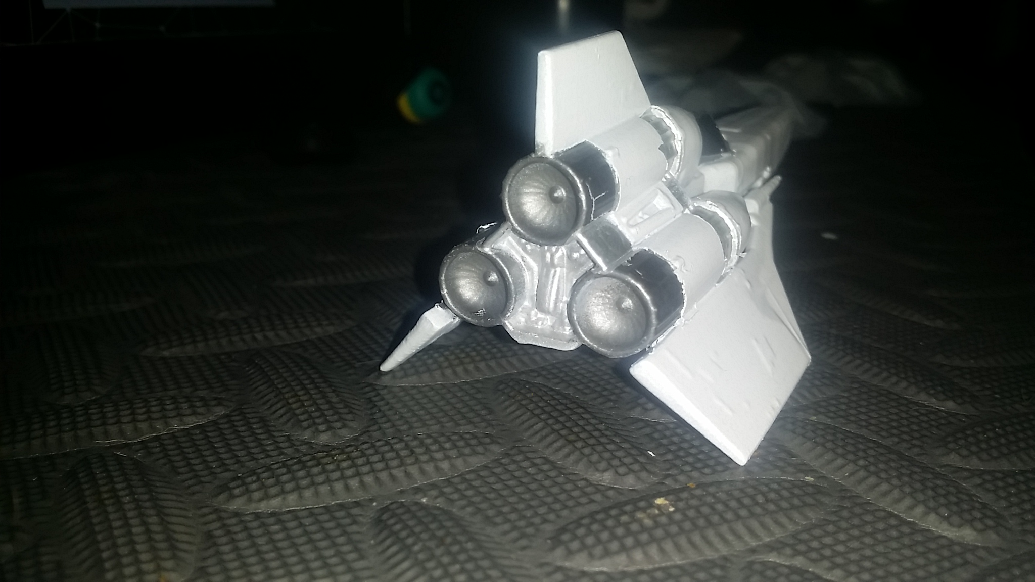

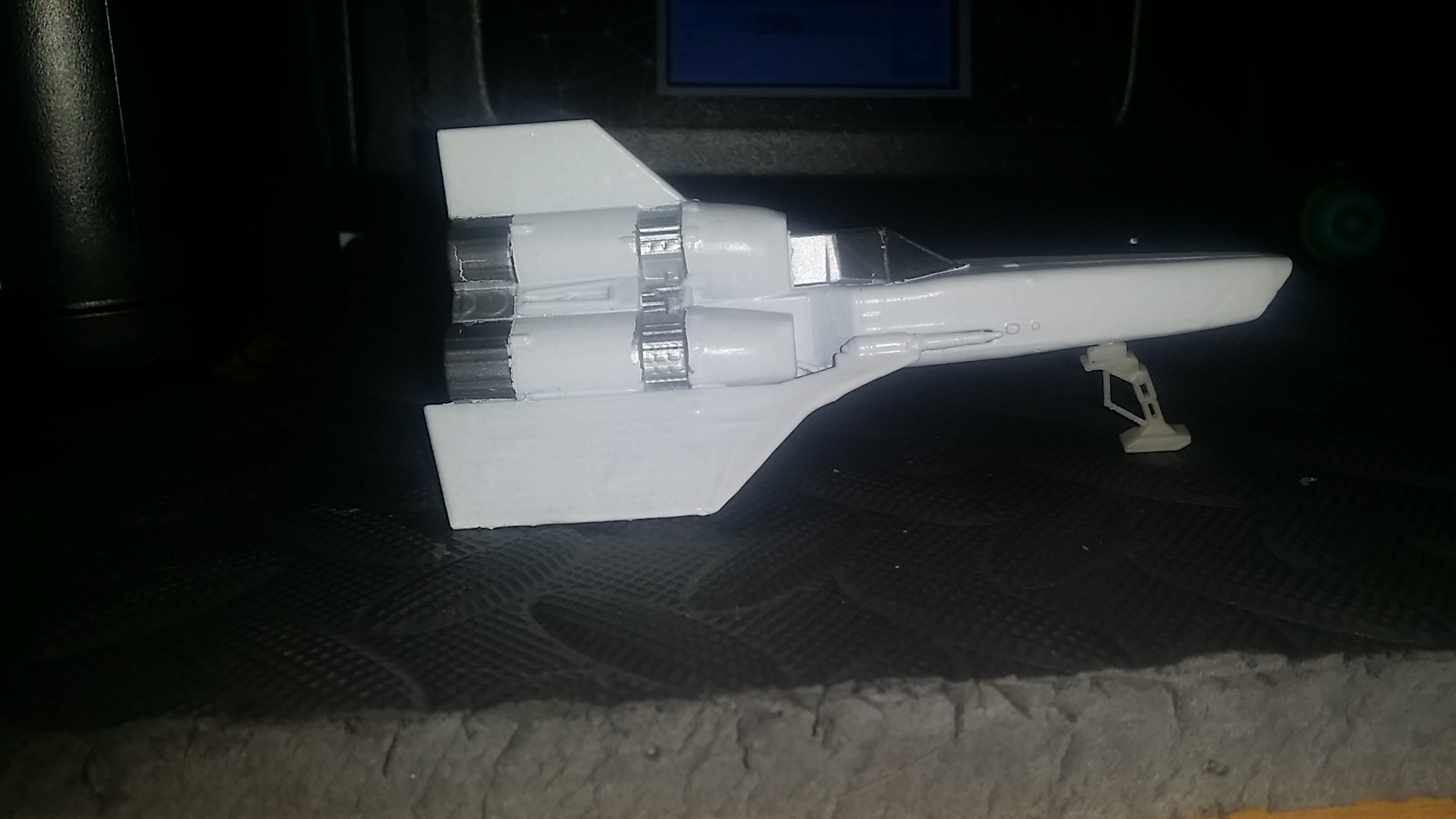

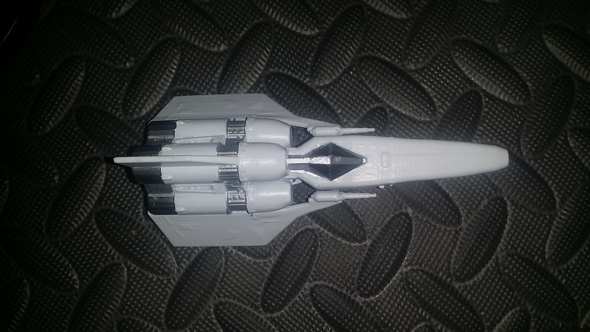

Here is the Viper with the initial painting started. The white is a white primer coat and I started doing some detail painting. This is nowhere near a 'finished' version, just the start. I'll add to the detailing, put the red strips on and start weathering it. Mainly I wanted to see what it is potentially going to look like. I have to make some landing gear or a launch rail.

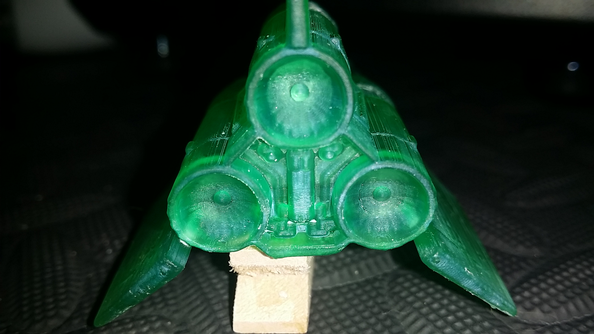

Here is the Viper as it came out of the vat and printer...
And here it is with the painting started.

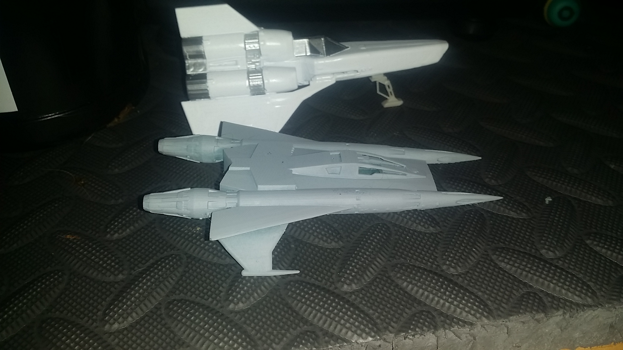

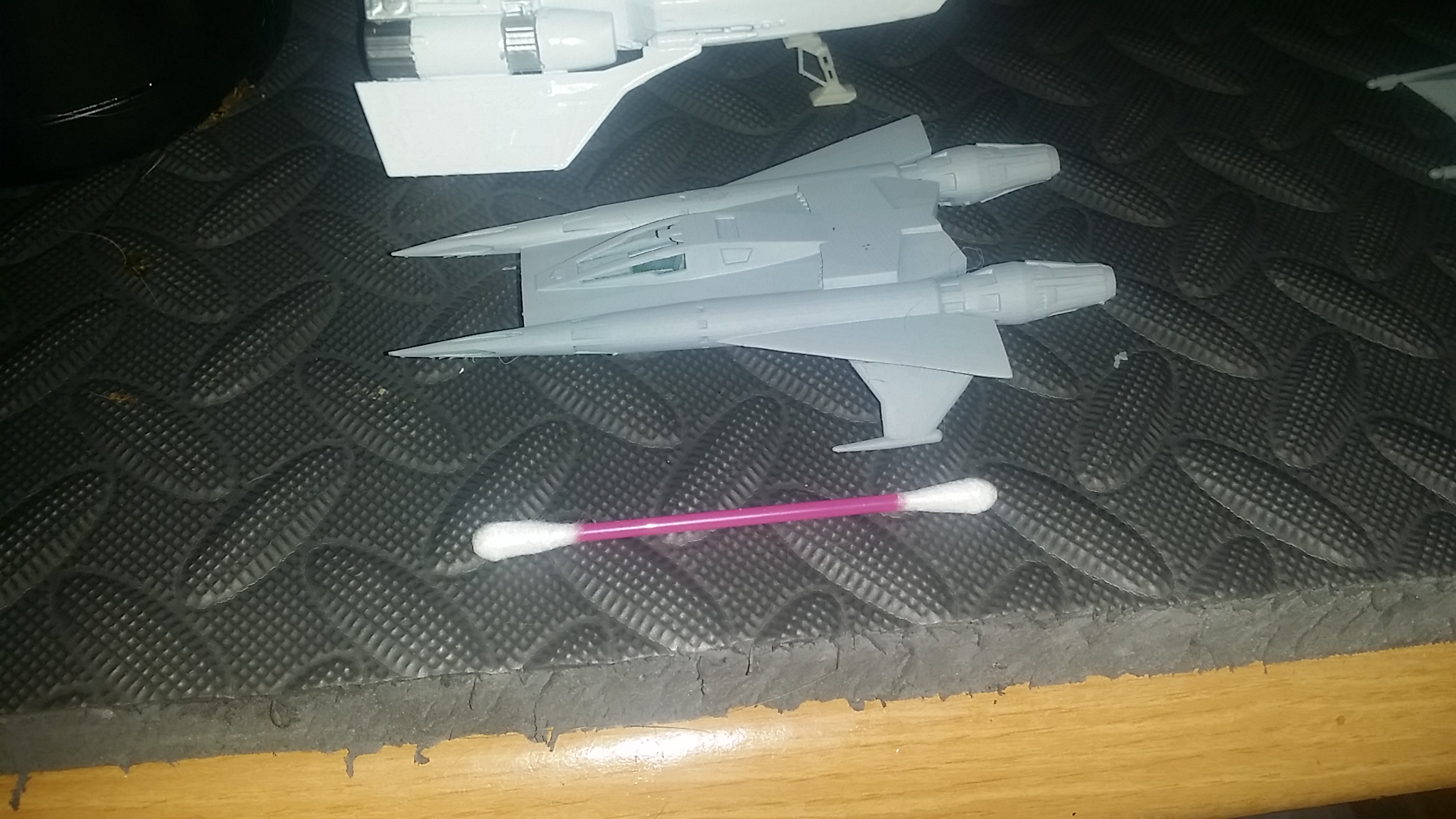

Here is the Starfighter/Thunderfighter with the first coat or primer. The Q-Tip in the last picture is for size perspective. First picture is out of the printer and rest are first primer. 20180515_021725.jpg20180516_072428.jpg20180516_072442.jpg20180516_072743.jpg20180516_072813.jpg20180516_072849.jpg
