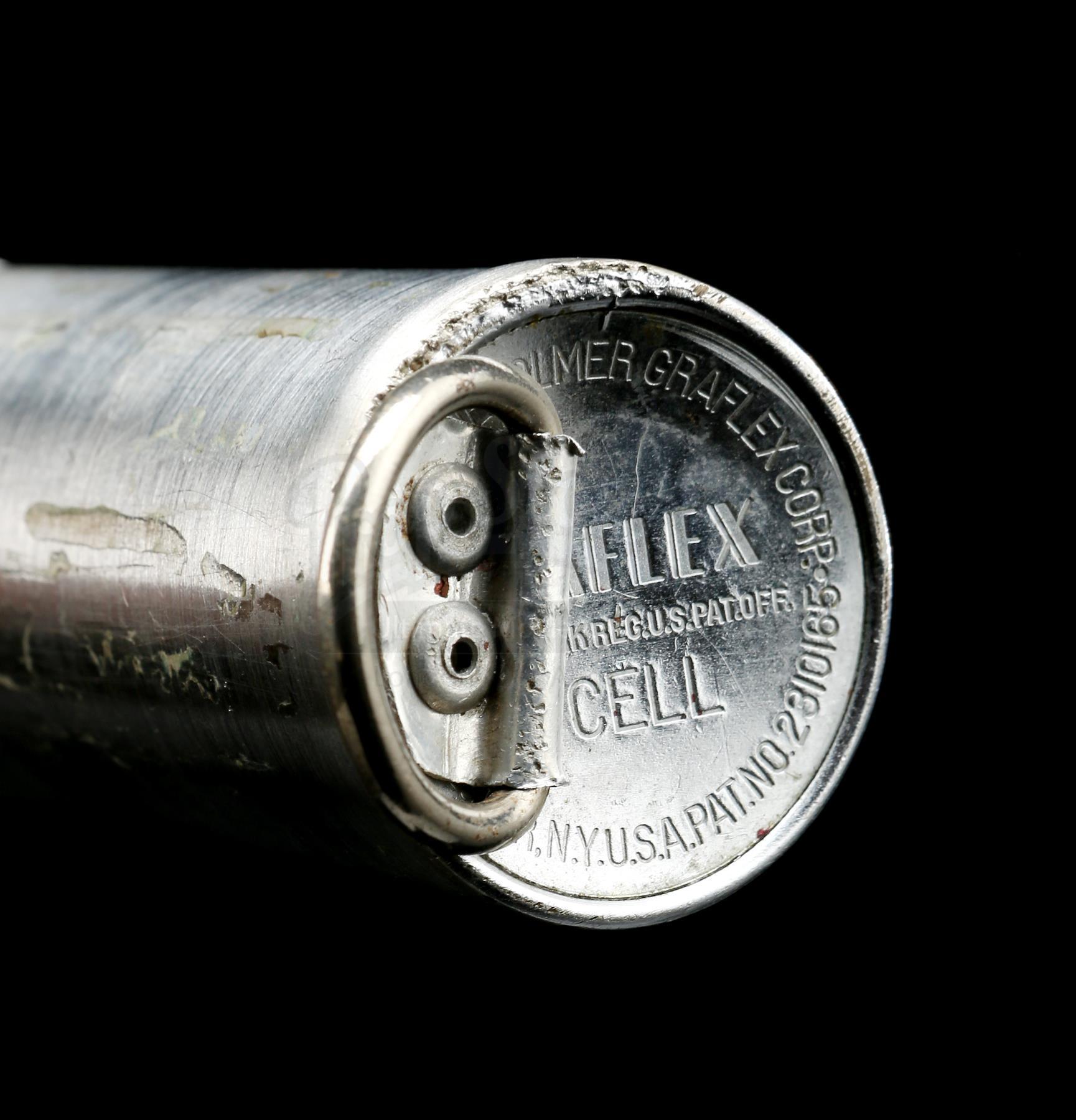

I think it is pretty similar to the elstree prop
quickly cut by hand (from a beer can?) , rivets not aligned , etc. Assuming the hero got much more "hanging time" it could be just wear, bending and deformation from the D-ring that make the clip look so asymmetrical.
I don’t think there would be deformation from wear and tear. As I’ve noted in the past, the prop sees very little action in the film. Unless the metal used was really thin and fragile (which sort of defeats the purpose of using it to begin with, in that case), I would presume that any wonkiness comes from how it was made, rather than on-set stress.

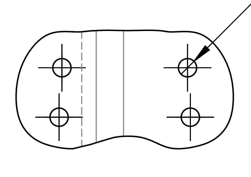

I’d be interested to see what Roy’s base design looks like without the folding, just to get a sense of how he thinks the original clip was cut to shape.

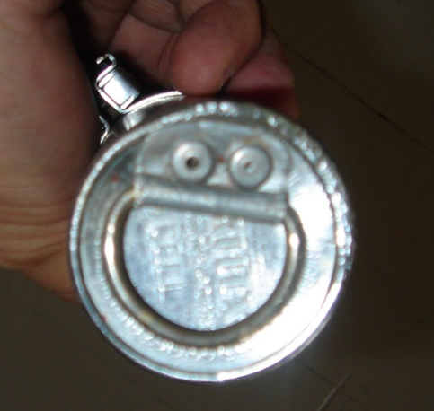

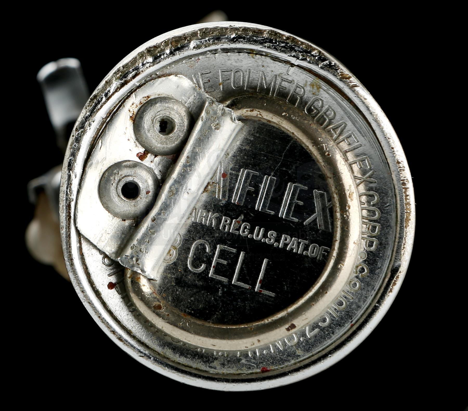

Here's the unfolded drawing. As you probably understand I have followed the shape based on that single back view image and reverse engineered it with this cut out shape as a result. Certain inaccuracies are unavoidable. But I didn't influence myself with the reasoning behind it nor by comparing it to the Elstree version. I do think the materials and the slopiness are similar and to me it does look like they used thin aluminium which is soft and easily bend and damaged.
As you can see from my unfolded shape it looks as if the initial cut was too wide and they cut or filed off some material on one side to loosen the D-ring. It's strange they haven't done it on both sides but maybe in the heat of the moment they just did it like this and mounted the bugger on the flash.
It's so dirty handiwork it would have been strange if it would have been the same as the Elstree D-ring.
Roy
Thanks, Roy! This provides some food for thought. Looks like I was right in that there seems to be a chunk missing. Hmmm.
I think most people that reject the new clip "design" do it just on the basis that it is ugly, but not because they see any error in Roy's interpretation of the pictures (that are the basis for the shape calculation). And that's ok, because sometimes when things look wrong or common sense tells you they are wrong - well, maybe there was an error somewhere that you can't exactly pin. For me the quality of that picture is so bad that I personally can only identify where the rivets are, but not the shape of the clip.
Anyway, here's a little test to see if in practice you can end up with a shape like this if you are a sloppy prop maker (which I'm not, so take it with a grain of salt).
Staring with a piece of aluminum sheet that I obviously cut too wide for the clip I have:
So, I take a mental measure where the clip is at the top of the sheet and do a sloppy cut at an angle, so it is OK at the top but it goes wider towards the middle and the bottom:
So it actually fits and I bend the sheet around the d-ring. However, since in the middle it is too wide - the clip cannot turn at all from that position. (which is exactly what happened with this clip the way I cut it)
Then I realize it is still too wide there at the middle. So I take the ring out, grab the cutters and just trim one of the sides at a random angle, because that's all I need for it to fit:
And now the clip fits and rotates as intended (and I have a very ugly clip, but hey - it works!) :
I didn't finish it with rounding and rivet holes, but I think I'll end up with something pretty similar if I just roughly cut it and drill the holes without taking any measures.

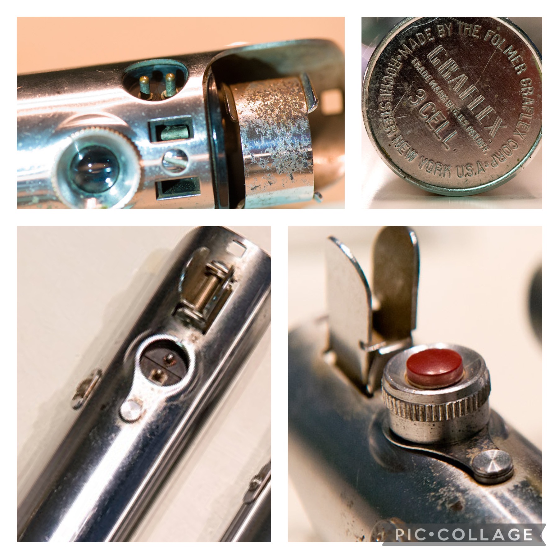

It's been a long time since I last posted here but I think it's time to start over.
First of all I have to apologize for my stubbornness for the fact that now I know very well that I was wrong. And I want to especially thank my friend Drew for this quote which is the one that started what I believe to be an important discovery.
If your collection was curated using the belief that Folmers have dull rivets, which lead to only gathering dull-riveted Folmers, your photos are just repeating your bias. That would prove little more than "dull-riveted Folmers exist."
I admit that in fact at the time I had no idea that there was a Folmer model with beer tab pin head in shiny finish but as often happens the truth is there under our eyes, you just need to know how to see it.
So I decided to question everything and started from the beginning, or rather from the only certainty I had at that moment: Ian's RAF-Flex.
Misfortune wanted this come to him without the original ears (and this is something I beg you to consider for later). Beyond this there are some characteristics to be observed of fundamental importance:
  • SHINY finish beer tab pin head
  • CHROME finish slotted screw
  • DULL finish and very wide aperture glass eye
  • STRAIGHT and ROUND head brass pins
  • SHORT knurling red button
  • Folmer NO PAT bottom

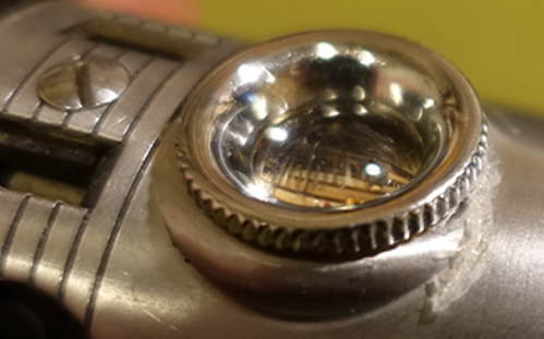

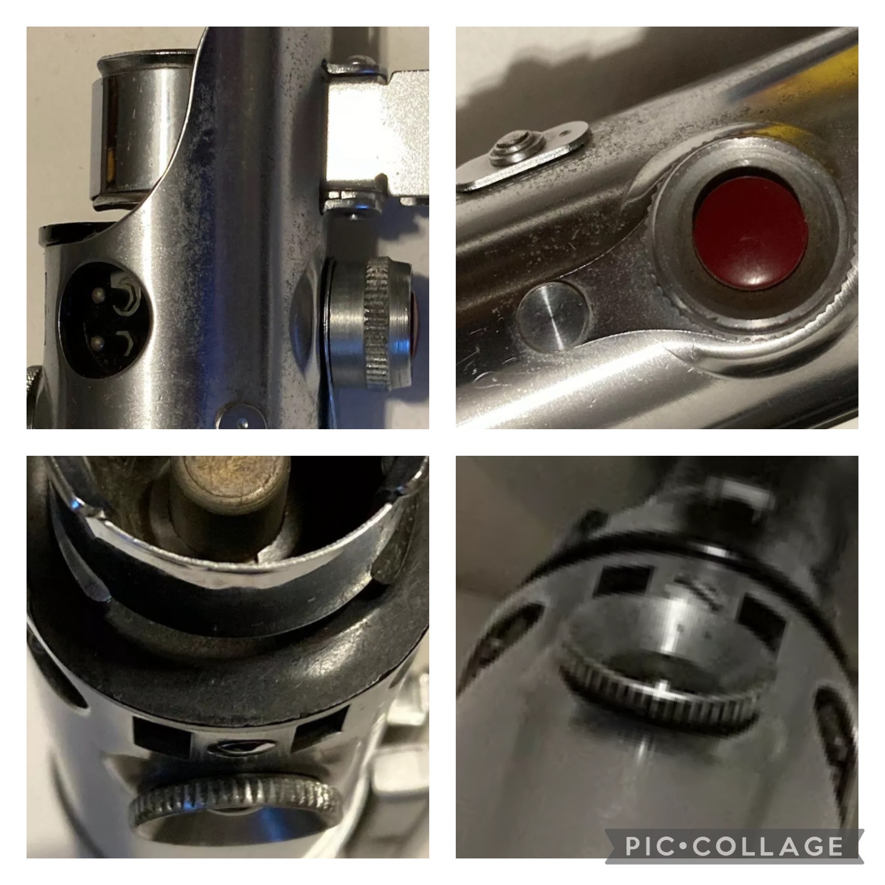

The thing that struck me most was the chrome slotted screw.. I only knew 2 types of Graflex that fitted that type of screw: Telegraph and 1928, the first 2 Graflex models, in chronological order. From here I started to think that the model I was looking for must have a correlation with these. My guess is that it was immediately after 1928 (but at the same time before what we usually call "Early Folmer"). From here I also began to think that the RAF-Flex could have, by default, chrome ears, as well as the Telegraph and the 1928.
And indeed…
I found the second Flex that I was able to check in the well-known Scott’s topic (Graflex Variations: Facts and vs. Replica) and it was also previously posted here. Scott himself intervened to reassure that they were "untouched" models, that is, with components not replaced or modified. I went to comb through his old topic and found these pics:
As you can see the characteristics are completely identical to those of the RAF-Flex seen previously with the exception of the ears which (even if rusty) sports clearly a chrome ring. From here I thought I was on the right path.
After a few months this appears in the JY here on RPF:
I remember the seller proposed it as a "good base" for ESB conversion. This in my opinion justifies the absence of the original glass eye and above all the presence of 2x long knurled red button that matches the typical ESB configuration. Beyond that, the other key features are all there (chrome ears included).
Not so long ago, my friend Nick Cline posted some pics of a fantastic purchase: another RAF-Flex! To tell the truth, the first time I saw the pics I was at the same time happy for him but disheartened by my research since I had immediately noticed that the ears mounted on his RAF-Flex were not chromed as I expected but simply brushed finish. So I asked Nick to send me some other pics and he was kind enough to send an avalanche!
After seeing them I felt more relieved, it is clear that the ears have been replaced with newer ones from an INC model (to notice the 4 holes inside the ring and the ring pin head).
Now, for those who might consider ears replacement unlikely, do you remember before, when I told you to remember that Ian's RAF-Flex comes WITHOUT the mounted ears..? I have spoken.
I also add a consideration matured over the years: I have often found Flex chromed components particularly damaged and plagued by rust problems (not only ears but also levers). it is possible that this really depends on the chrome finish and it is also possible that’s the reason why at some point they decided to change the finish from chromed to brushed.
All these are obviously just personal theories.

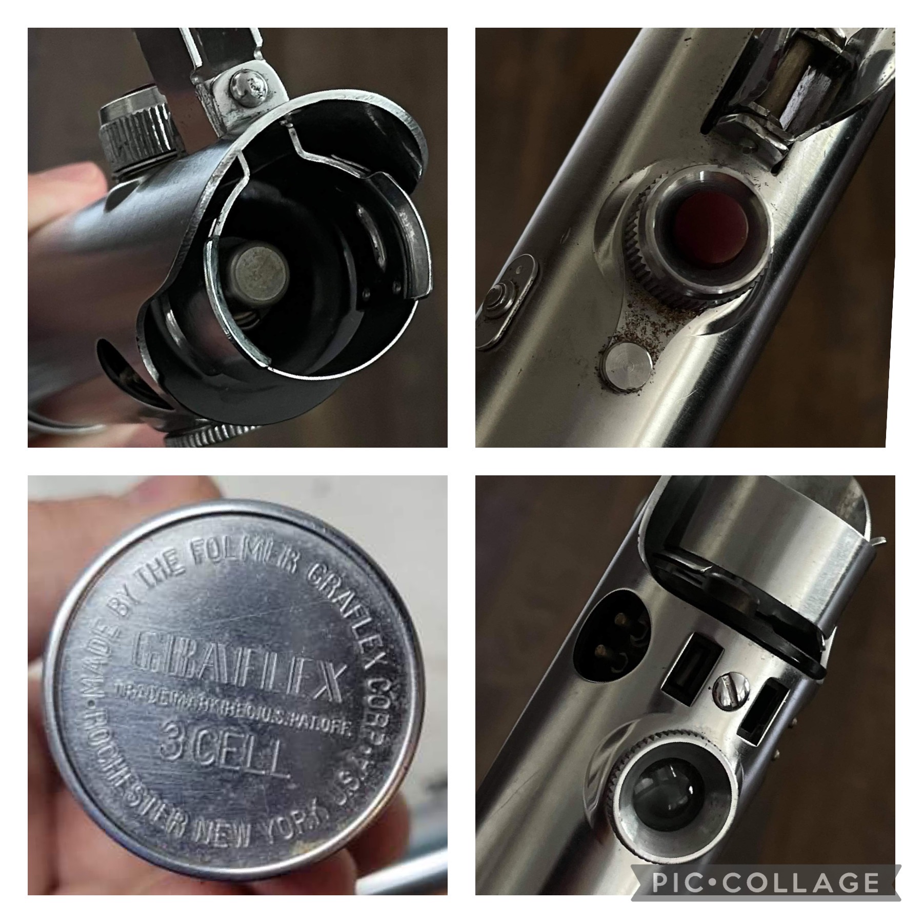

A couple more…
These two are from eBay, both quite recent. The first one comes from a SW collector so I’m not surprised by the glass eye changed with a LATE Folmer model which obviously clashes with all the other components which instead fully reflect my theory.

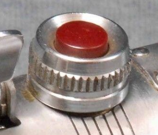

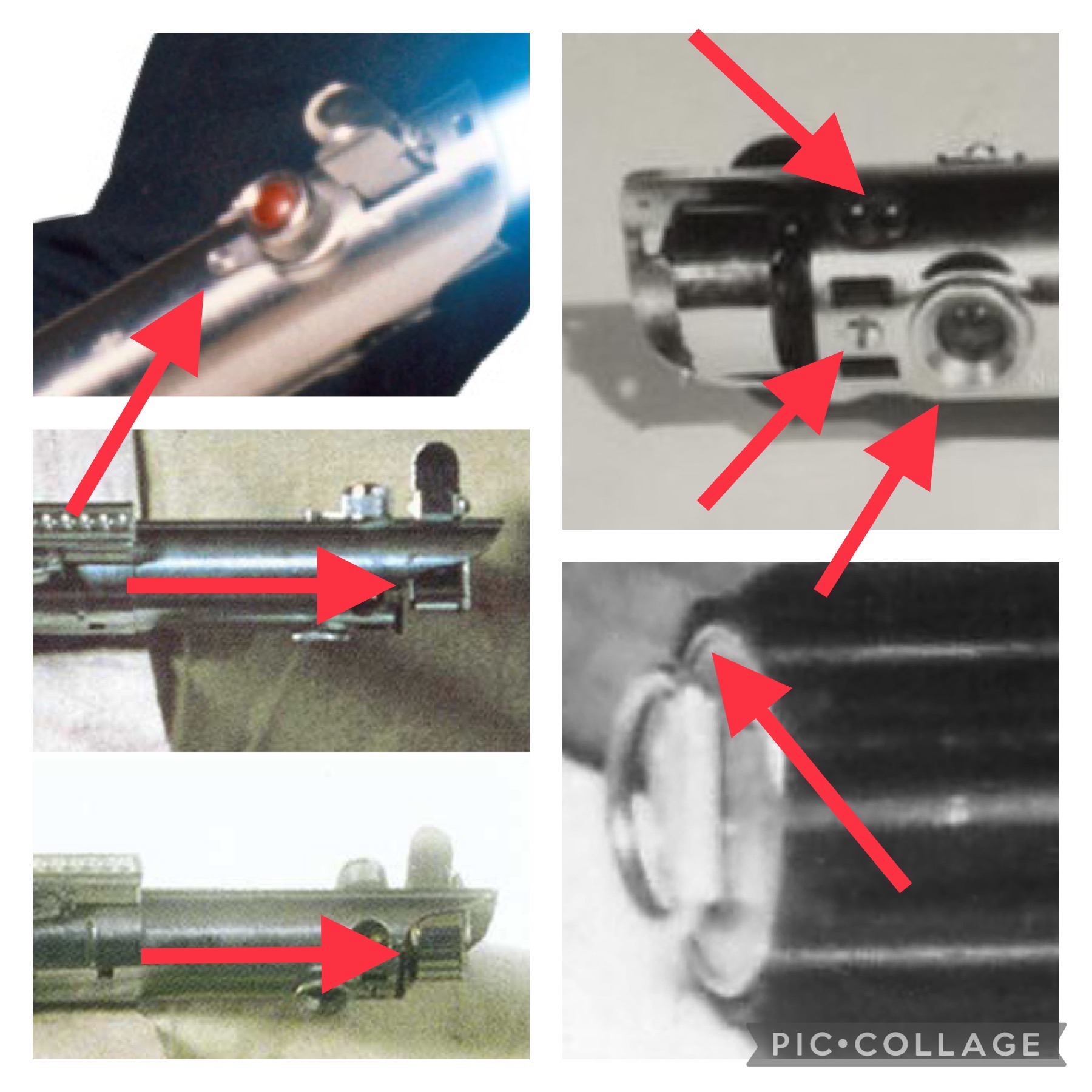

Now let's move on to comparisons with the actual prop. In this summary pic I highlight the key features:
  • THIN lip bottom
I don't want to bore you by going to recomment things that have already been taken into consideration on this same thread.
These two remain:
  • CHROME finish bunny ears ring
About the ears, I believe there are no words can supplant what is already quite clear to the eye: I am referring to the lower left corner of the photo above.. The difference in finish between ears and top half is evident. Below I put another one where I compare the original with the others I told you about before in this post.

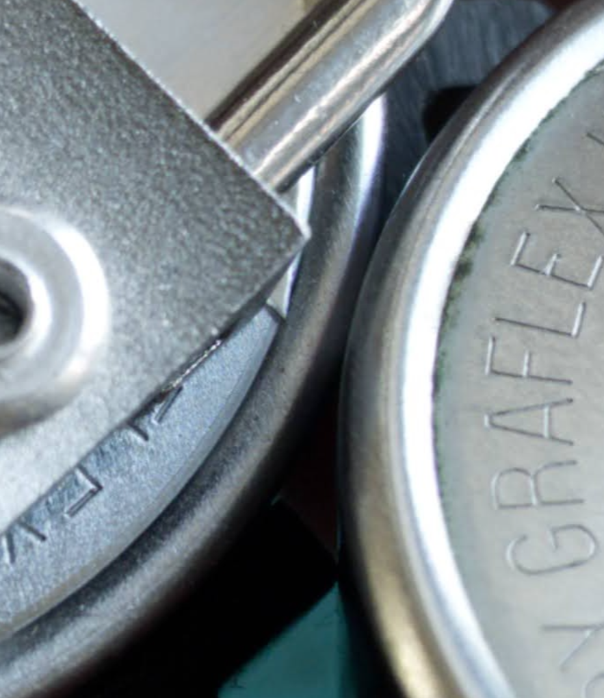

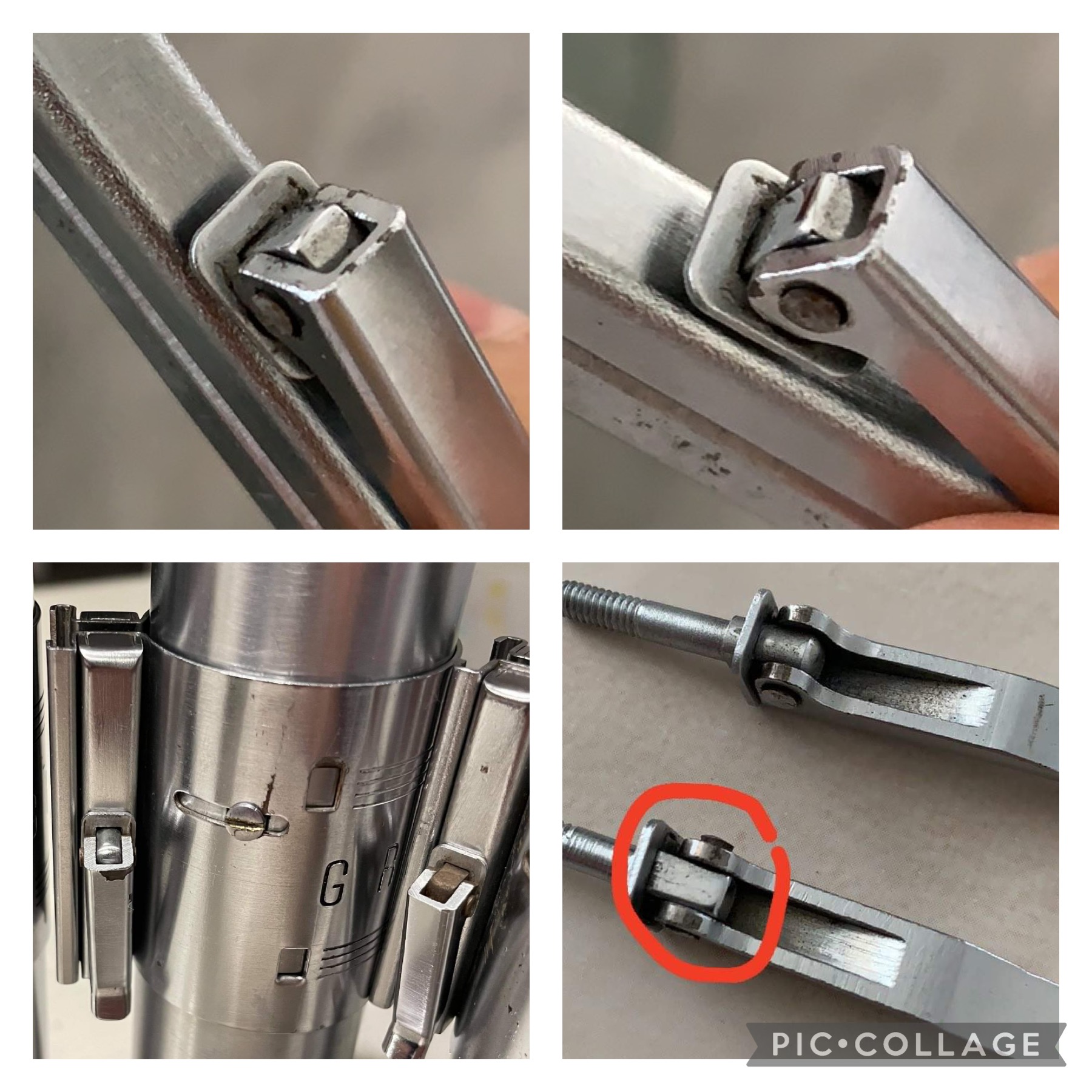

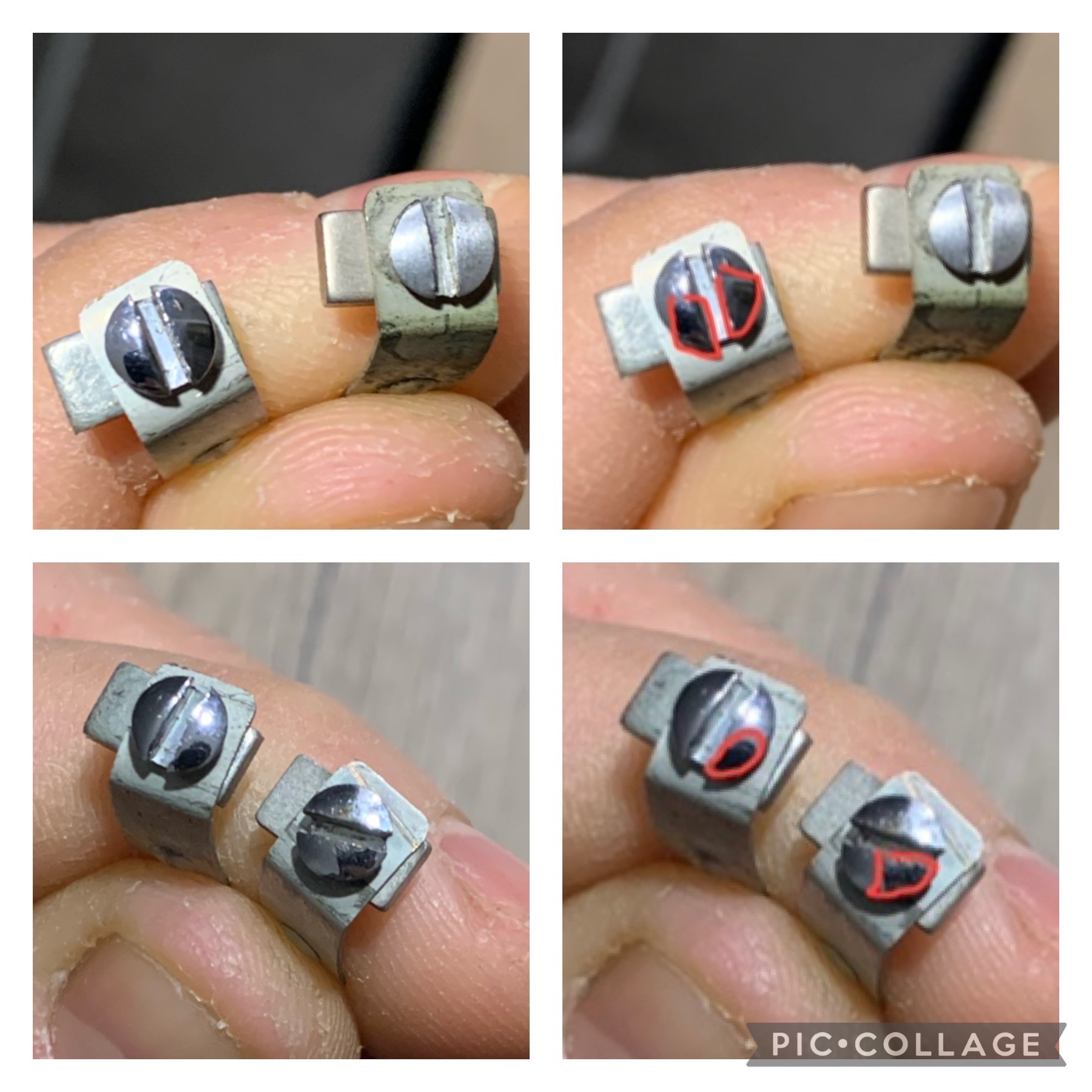

Regarding the slotted screw, this is the most important reference, in my opinion:
I don't know how many of you actually own (or at least have ever held) a genuine chrome slotted screw. the finish is particularly different from the more common brushed ones but even more evident is the reflection they emit when they are hit by the light. the contrast on the chromed screw is so evident that it creates particular "black spots" that cannot be found in the brushed, which instead reflects the light in a uniform way. To better understand what I'm talking about here is a comparison photo between the ones I own..
Now, if we look closely at the image of the actual prop we can see how these spots are present on it.

I know I'm not alone in owning Graflex flashes in a variety of finishes -- the high chromed "1928," a shiny brushed finish, and the satin brush finish. I had hesitated to read too much into the chrome finish in the old photos because of so many unknowable factors in lenses, film, processing, and reproduction -- but the photos are going to be internally consistent, and I think the key diagnostic features are visible in the photos.

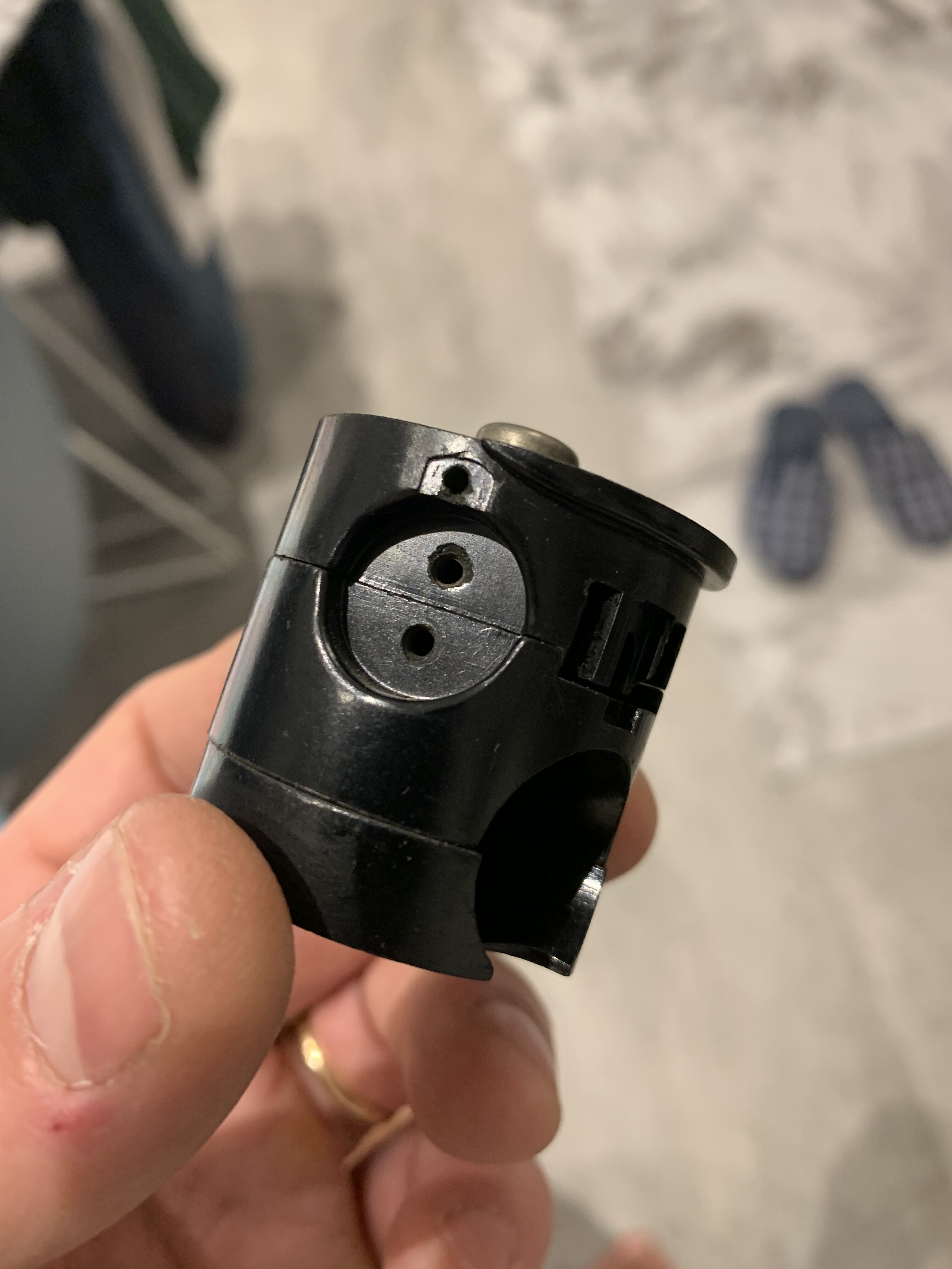

Since you've removed the bulb socket one thing I'm curious about (sorry it's little off topic) - did it have the small holes like it was meant for a telegraph flash?
This is what I've found on one of mine, that I decided to replace since the lip was broken (now on my "ranch saber" build, which serves as my dump place for broken/rusty parts):
However, just like with the rivet, let's not assume the Folmer no patent are the only one stamp with thin lip in existence, just because we have not seen one.
(Collected from other threads and/or ebay, not sure who's the current owner):
This last one is an Inc. It's converted to Maz Box, so unfortunately you can't see the stamp - It's lip is much thinner than the usual Inc. Not as thin as the thinnest Folmer no patent - but if this one exists, it only proves that there could be others even thinner.
I also lean towards Folmer no patent because of the other flash features, but since we don't know from how many flashes they mix and matched the prop I always keep in mind there's possibility it could be one of the other 2.

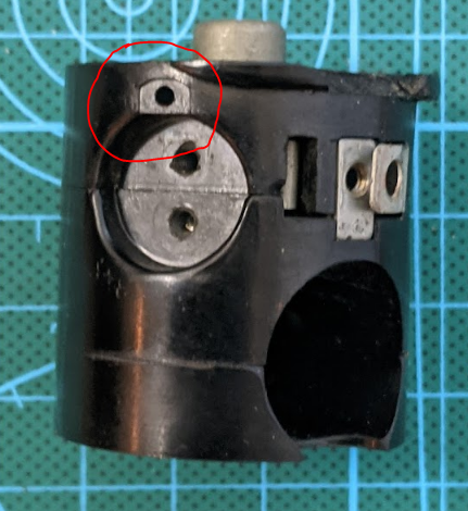

I'm not surprised at all that you found those particular holes on the bulb socket. I have the same holes in the bulb socket of my 1928:

Then the 2 Folmer no patent with shiny beer tab rivets that I was able to get (one 3 cell, one 2 cell) had everything else right except the screws are dull.
All of them had the type of "rusty dot" clamp lever though. So some parts swapping must have happened beyond just the button on the ANH prop, if they swapped the clamp maybe they swapped the bottom as well.
