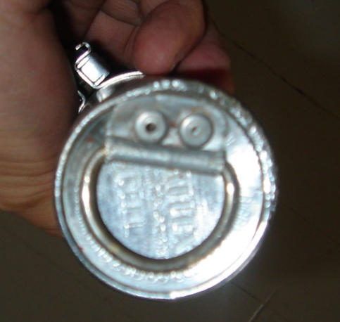

Comic overreactions aside, that seems a little too asymmetrical, even for handmade. It's worse than the Elsetree clip. The end-on photo is so blurry it's hard for me to tell if this is what we're seeing or not.
I agree with you. There is some uncertainty to this shape. Nate and I had lengthy discussions about it. We also improved the image quality and this is the shape it reveals. The shadows and the blurr make it probably look softer than it really is. Still, this is better than we had before.
Agreed, Roy. I wouldn't say the clip shape is 100% accurate, but based on the reference photos we have, it is a definite improvement over the original in terms of screen accuracy. It's interesting to note we now seem to know why the D-ring on the real prop is slightly lifted away from the base of the Graflex due to the "spur" on the clip that juts out from the side shown in the new blueprint.
Remember, people, most of us thought the mystery rivets were a strange and ugly reveal, two years ago, and now people routinely place them on their replicas. This asymmetric clip surely falls into the same camp. That being said, many more sets of eyes are now on the case to confirm/deny/discuss these new findings.
This research is a search for the truth, not to confirm our suppositions and biases about a prop thrown together just to look good onscreen.

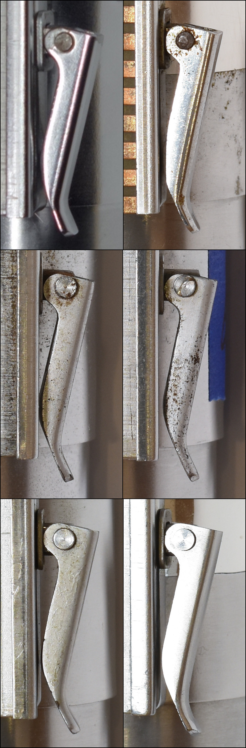

So are the Folmer gang swapping out there Levers/Clamps for INC because the lever pin looks like a larger INC?
I'm using one like the levers in second row of this photo:
I think that's a Folmer variant, as the pins are in the same location as the rusted pins -- and there seem to be far more smooth-pinned flashes out there than levers with the rusted pins, so looking at this a variant would explain that shortfall. I also think that explains why the pin looks especially large in some of the ANH prop photos if you compare it to an Inc -- it's not necessarily a size issue, but placement. I think that for the Incs, in the third row, the pin was reposition to make the lever stronger.
(I've gotten this style clamp on Folmers flashes both with and without patent, so I don't think it's diagnostic to that end.)
I don't have one that's like this, but after seeing Drew's post in the Graflex facts thread I also believe the middle row levers are what we see on the ANH saber. Before I thought It's just a beat up "regular" shiny rivet lever (3rd row).
The first one is the folmer, a small rounded brass rivet on the inside, whereas inc ears have inset dimples pressed on the inside in 6 places. External finishes are very similar however.
My graflex bunny ears are like the folmer pictured but with a silver colored rivet. What does that say about it?
Some are brass other are silver, but otherwise the same size and shape. I guess the "silver" ones are just the same but chromed. The brass ones don't look like they were once silver and the plating was worn off from use though.
So does that mean it's a Folmer? I got a Graflex inc model and the top, bottom, and clamp seem to be worn in a manner that leads me to believe that they are all the same flash.
Well, the stamp is only on the bottom part. And they were sold separately if you want 2cell 3cell and so on. So it is kind of hard to claim that a top or the clamp are "Folmer" or "Inc", just that some combination of features of the other parts are most commonly found today paired with a Folmer or Inc bottom part. At least that's how I see it.
But based on the recent discussions I don't remember anybody to have a flash with this kind of bunny ears rivet and Inc bottom part.
So yours sound quite interesting combination - what about the other features - like the pins, etc ?
Could you post some pictures ? (probably better in the Graflex facts trhead Graflex Variations: Facts and vs. Replica )
It is probably an Inc variant then of some kind most likely. But We’re finding more and more how much these small details vary. Read through the thread and you’ll see! There is overlap in consistency details from flash to flash it would seem!
I have found the second row type lever on a folmer clamp, which is the one I use on my ANH. It’s cool because the lever has a similar rust pattern to the real prop as well!

I can’t get behind the new D Ring Clip theory.
I am convinced it’s shadow and the angle of the photo, I cannot buy into the theory they made something so asymmetrical.
Star Wars is wonky, dirty and used, sure .. but with so many off the shelf solutions, I can’t see them hand making that and doing it a disjustuce.
The current offering seems the most accurate and realistic to me.
Also, why would the Elstree prop—ostensibly an abandoned FX attempt—have a nicer-looking clip than the hero prop?
The jury’s still out on this, but I tend to think that the hero clip would look pretty similar to the Elstree, assuming they were made around the same time by the same people from the same materials.
If and when Roy makes his asymmetrical clip, I would suggest that someone shoot some photos with both the new and symmetrical clips and compare them against the reference photos to see how they stack up.
I think it is pretty similar to the elstree prop
quickly cut by hand (from a beer can?) , rivets not aligned , etc. Assuming the hero got much more "hanging time" it could be just wear, bending and deformation from the D-ring that make the clip look so asymmetrical.
Mind you, I’m not saying the Elstree looks perfect, but it’s also not that terribly wonky. The wonkiness mainly comes from the offset rivets and the lopsided rolling of the clip around the d-ring, I think.
Not at all to knock Roy’s work on this, but just feels off to me that the shape seems SO weird. I mean, it shouldn’t be that hard to cut a strip of metal (with reasonably parallel edges, round off the ends, then fold it over on itself.
This hypothetical version seems to have a weird zig-zag thing going on, like it was made from metal cut diagonally, or perhaps that it even has a chunk missing, which they tried to compensate for when rounding the ends.
I’d be interested to see what Roy’s base design looks like without the folding, just to get a sense of how he thinks the original clip was cut to shape.
