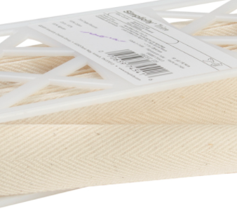

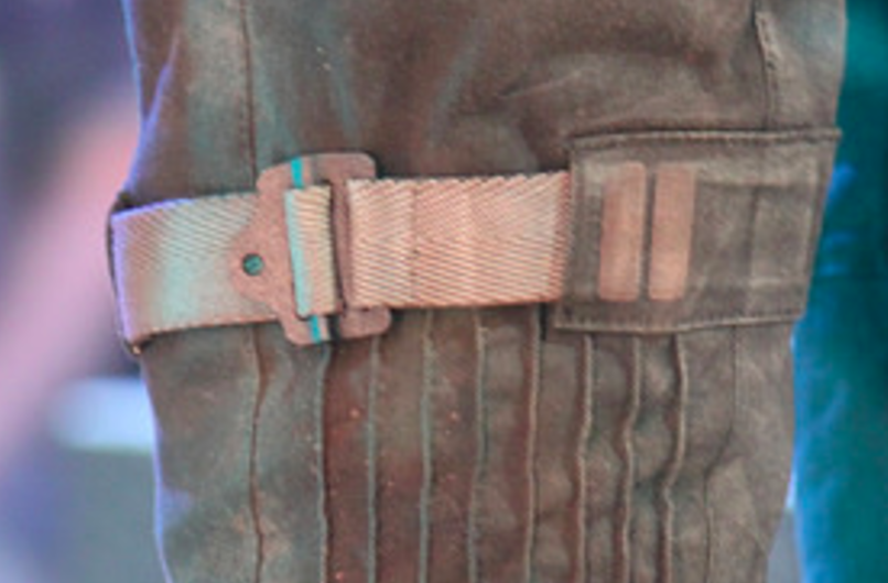

The webbing on her pants just below the knee looks like sand/off white colored 1" twill tape with a herringbone weave that was then dirtied a bit.
You can get it at JoAnnes: http://www.joann.com/1.0in-natural-...5k_cMy1__h0vmPo4k2lkA3dcQYwCPXgoXWRoC_Bvw_wcB

On her right side the little nubbin' below the wire greeble is definitely the male end of a glove snap like this: http://www.zackwhite.com/Line-16-Glove-Snap-Nickel-Plated-Snaps-1000-Pack_p_3747.html

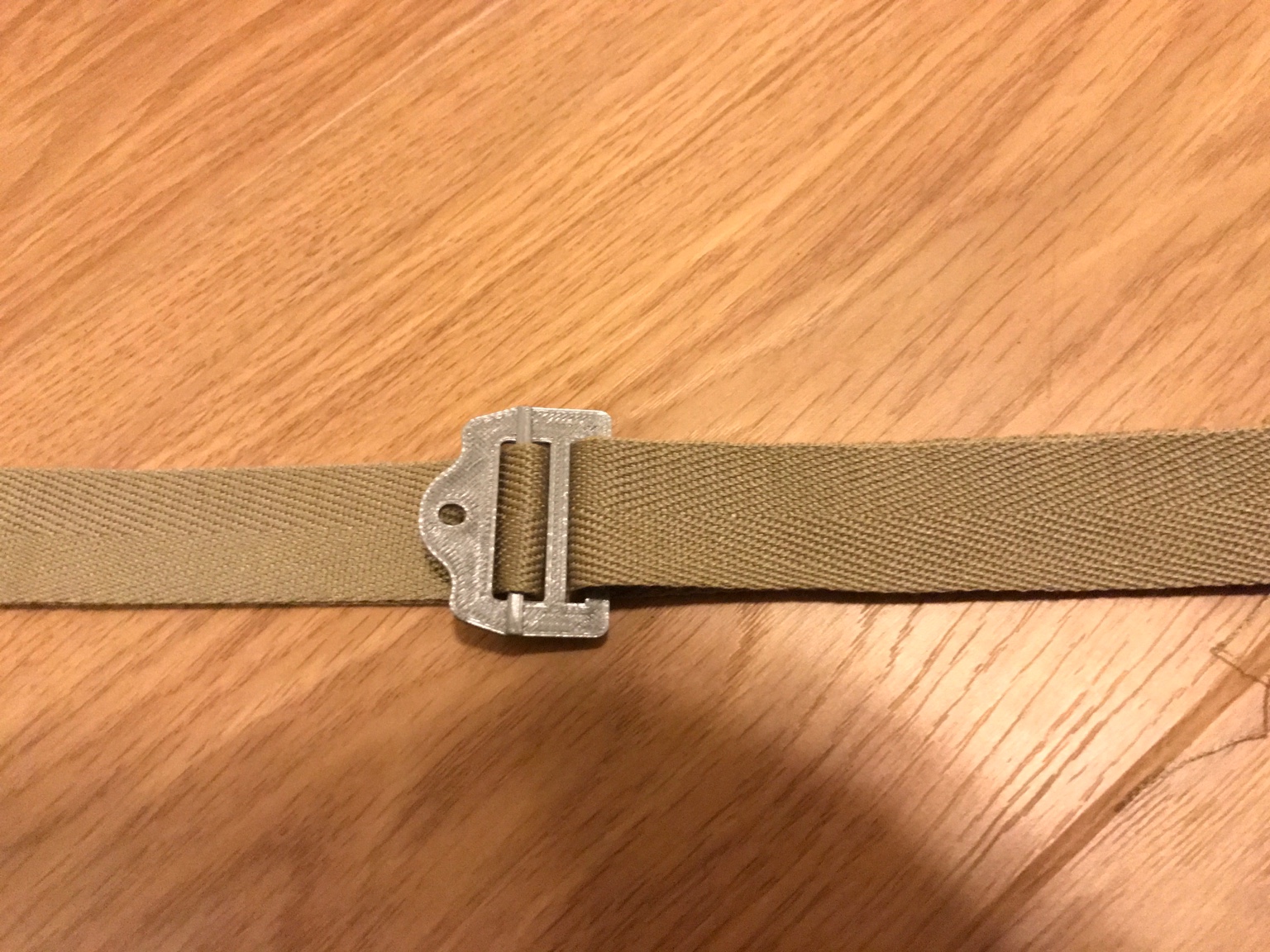

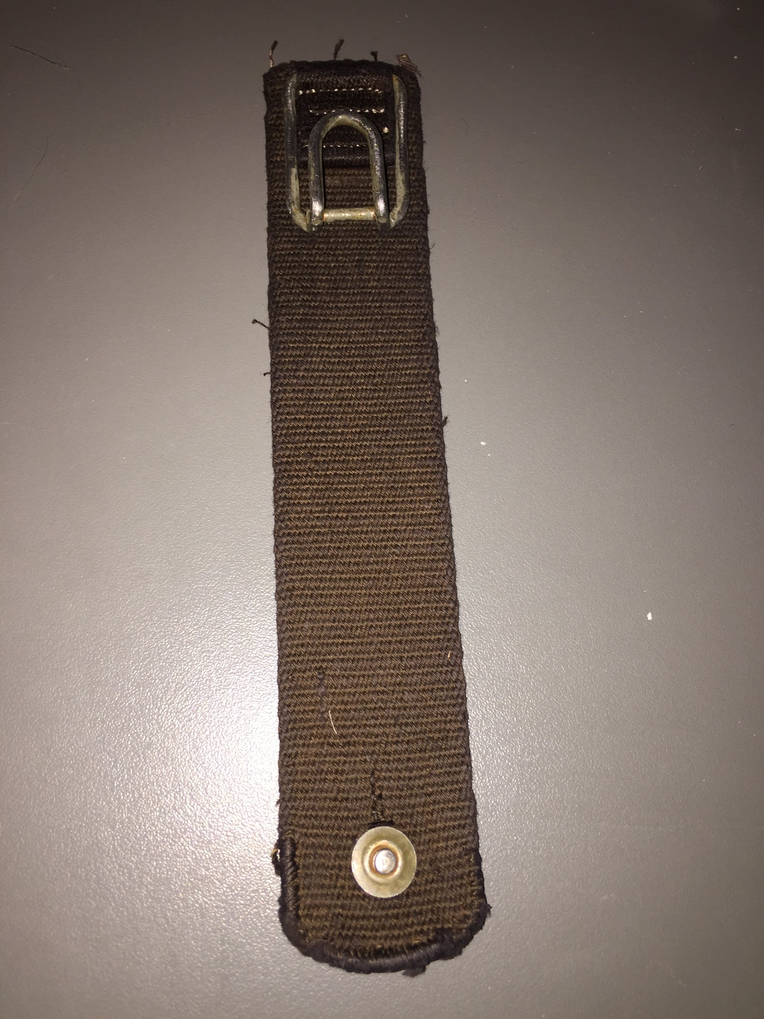

I was thinking it might be something like that until I received the Czech military suspenders/backpack straps. The narrower sections are both sewn and riveted to the wider parts. One side of the rivet looks a whole lot like a snap. (I have dyed the whole thing -- a bit too dark right now, but only removed the narrower connecting straps on the bottom... the finishing of the rounded edge is the same as well. I had to remove and flip the direction of the hook and finish the top edge.)

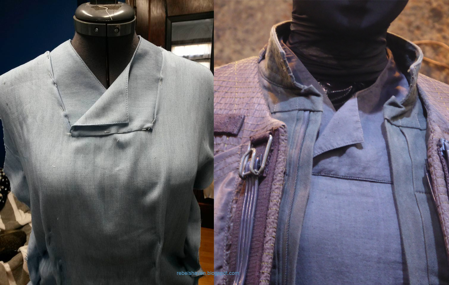

Also it definitely does have a tab collar on it, that looks like it is one rectangle of fabric that is folded in half, NOT two pieces stitched together, then flipped. It's probably top stitched on like a men's dress shirt collar after the front and back of the vest are already assembled.
You can see that detail best in the Entertainment Weekly headshot:
A small standing collar, probably lined with whatever you used to line the front flap (I used a layer of felt on each side. Regular interfacing was too stiff, and batting was too puffy.) It is much much easier to attach it to the front back piece of the vest before sewing everything together. (Believe me, I've taken that vest apart and put it back together in so many different ways. So much hand sewing when you've put things together and then taken them apart in places the machine can't get to.)
callisto inspired me to get back working on my vest this weekend. After going through the more recent photos I came to the same conclusion as CarpElgin about the front web. It needs to be wider than the 1" I original estimated and the Czech backstrap is perfect at 40 mm. I wish I had got online 4 hours ago CarpElgin would have saved me a lot of time.

Here's my collar drape test. Finished last night, then I saw spectreseven's screen cap so I'm feeling better about it! Going to make the front of the flap less square though...
