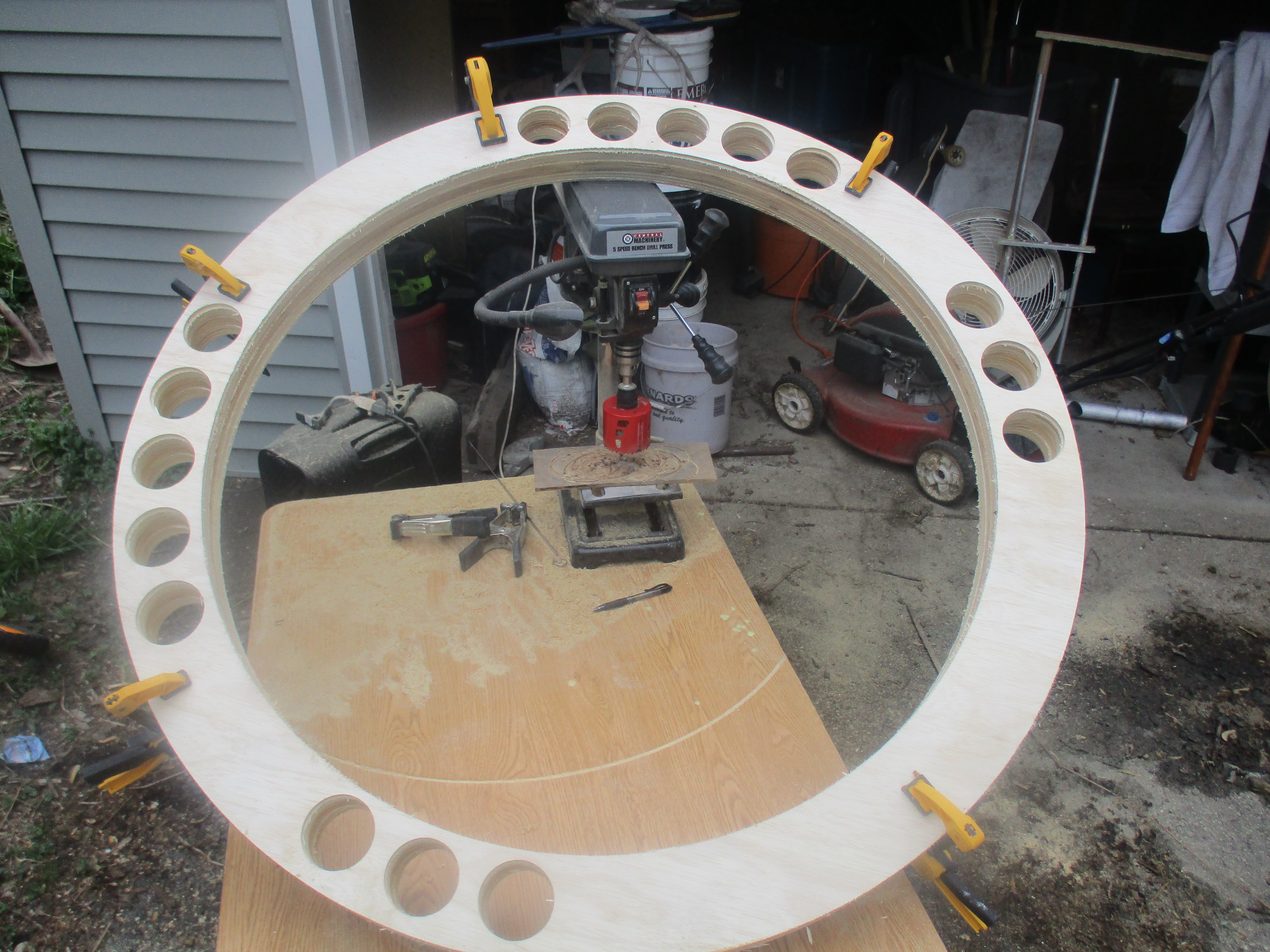

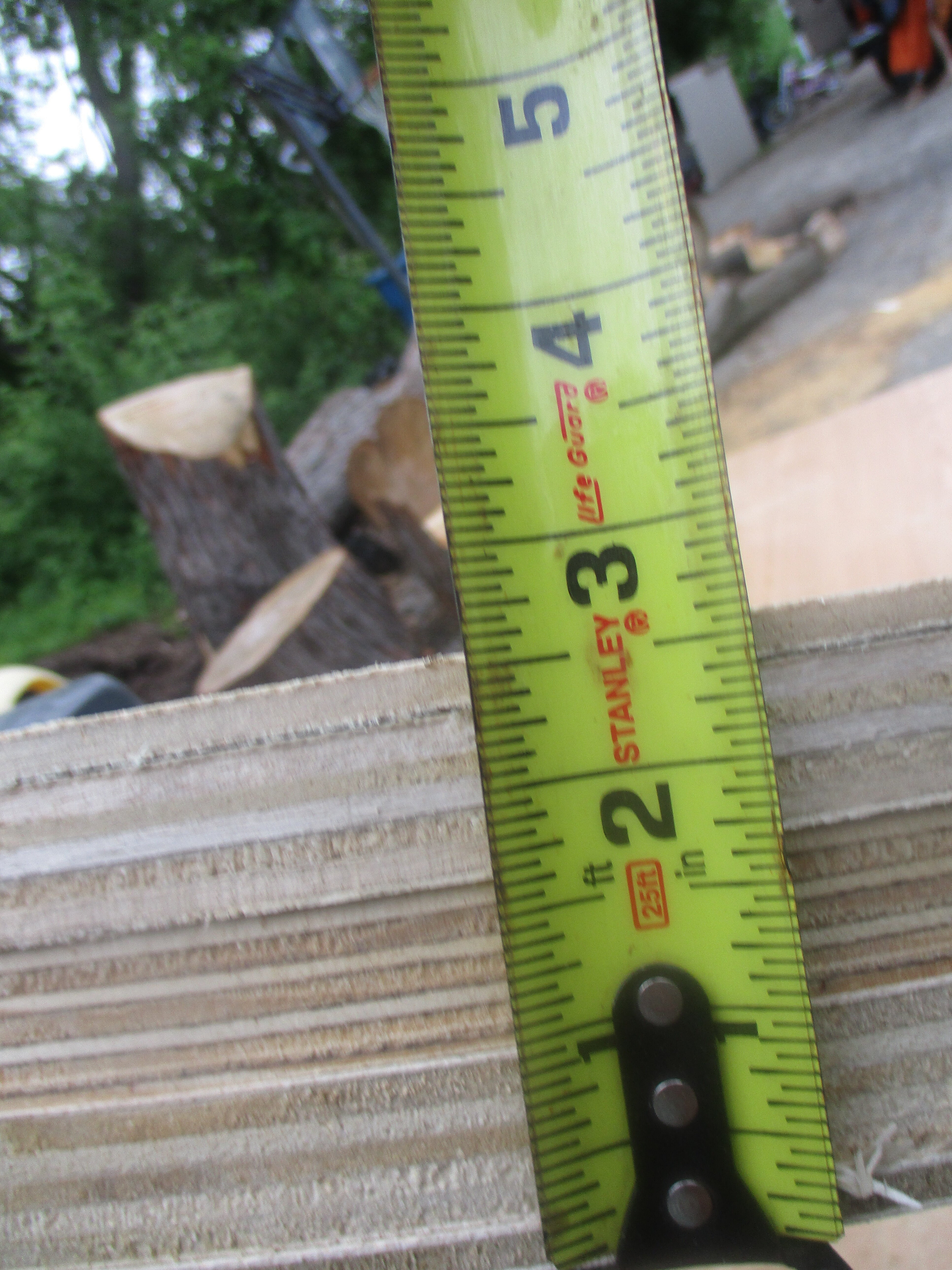

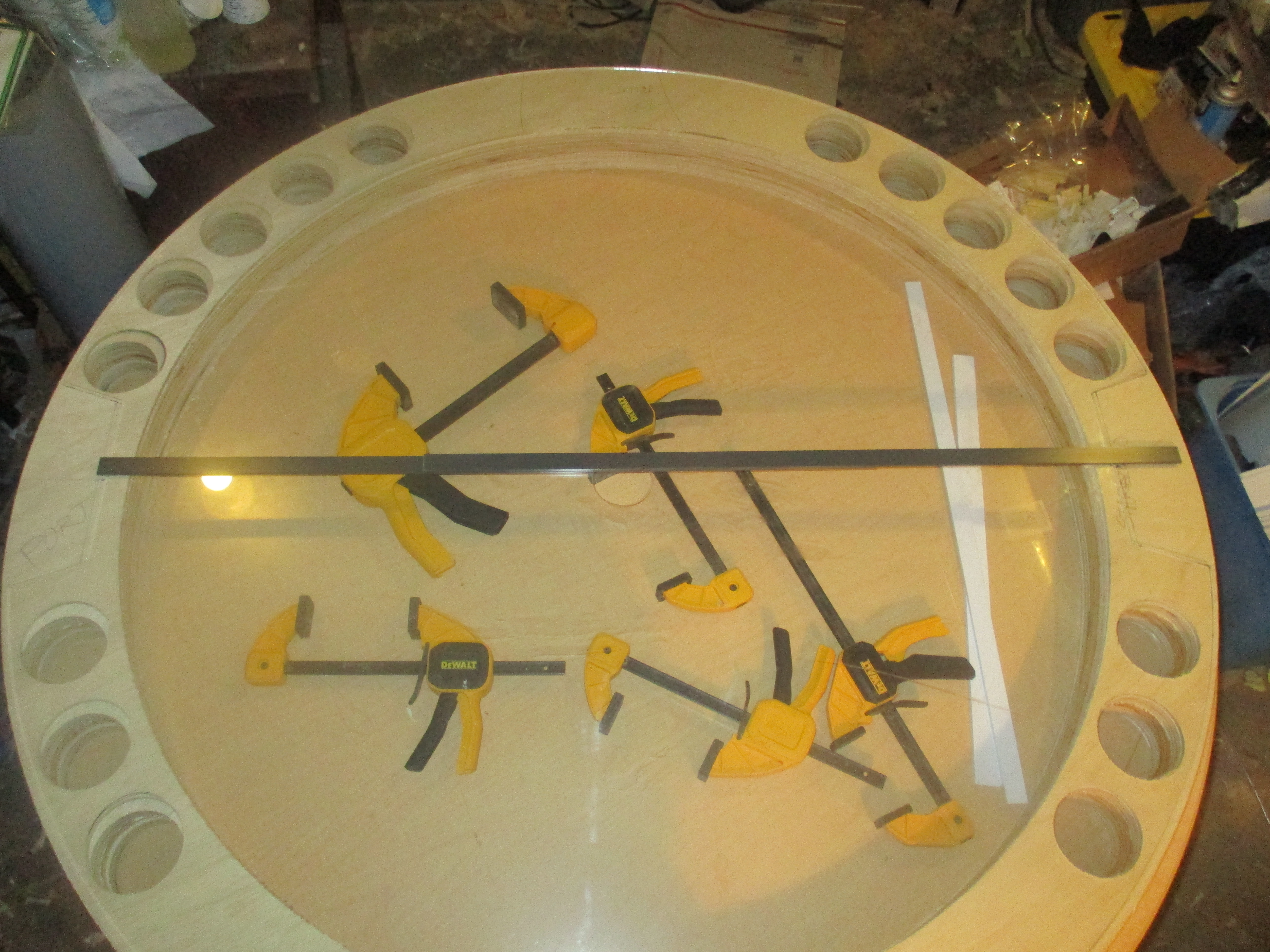

Okay, the cutting part is done -- now for a LOT of sanding.
All in, I'm just at 2.5" for width, but I'll likely sand some of that off to achieve a flush-mount edge to hang my domes on so they have more surface area contact with the wooden ring. Plus I'll likely put some custom spacers on top and bottom to seat it perfectly and securely.
This "looks" like it's slightly over 2.5", but keep in mind this is before sanding, clamping, and gluing all the rings together.
All those "lightening holes" save you about 7 pounds of weight.
More anon.
More anon.

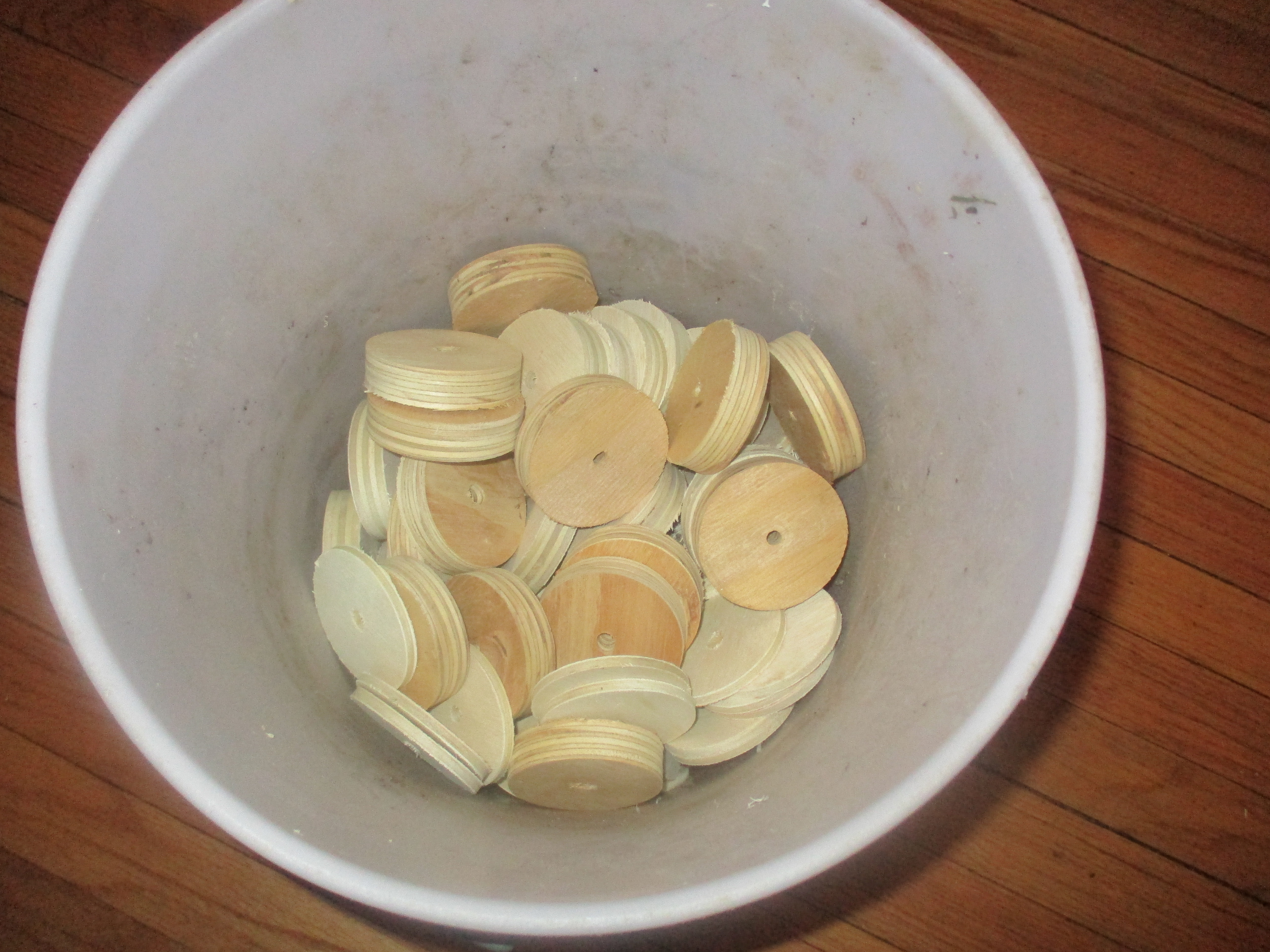

Man those lightening holes are probably
$ 30 worth of plywood, ; )
Yeah, I actually saved them for the fall for kindling in our woodstove -- Falcon Fire Night should be as fun as S'Mores Night, no?
They also make really good "wheels" for young kids making toy cars out of household leftovers, so they are for sure not going to waste.
Hey, I didn't even think about wheels. Great idea.

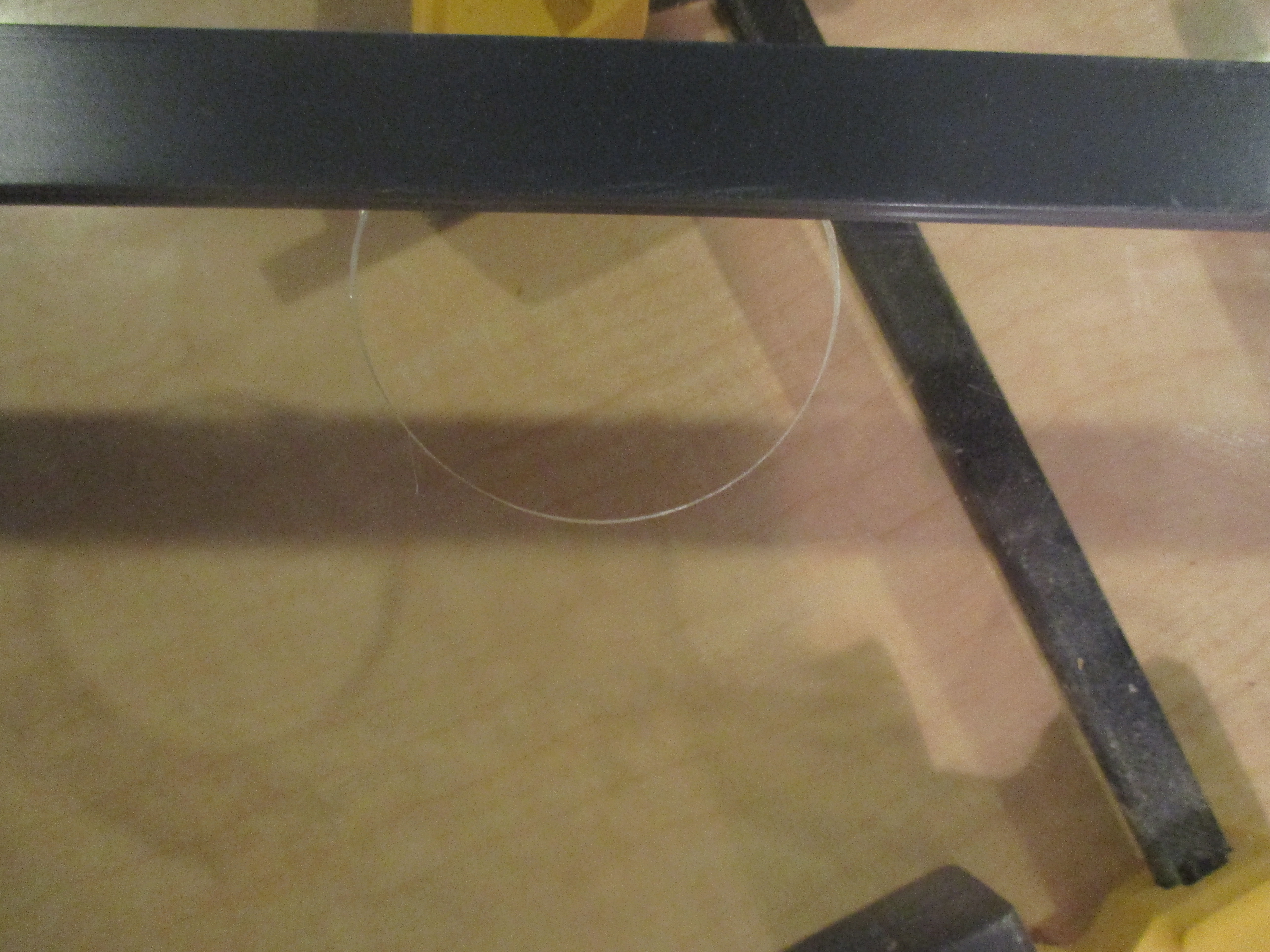

Figured out my armature geometry problem... it was in the CNC-routered acrylic pieces all along, and NOT in my hand-cut rings or hand-welded aluminum armature tube. This is great (but expensive news), as it means I didn't screw up, but that the machine shop with the CNC router did.
So my rings are perfect circles, the 2.25" hole is perfectly centered, but the docking ring notches are NOT centered to the center hole -- how/why that got screwed up is beyond me.
But here's the proof, up close:
Where the bottom of the black Plastruct strip cuts across the center ring should be in the DEAD center, but is clearly off center, by 1/4 or 1/2" too much to the north of dead center.
So it's BACK to the CNC shop, to see if they can make right this mistake that cost me half a dozen dead Benjamins...
Anyway, I AM very happy that the mystery is solved, because it took three years to get to this point, the original acrylic having been cut in June 2019 before I started my thread.

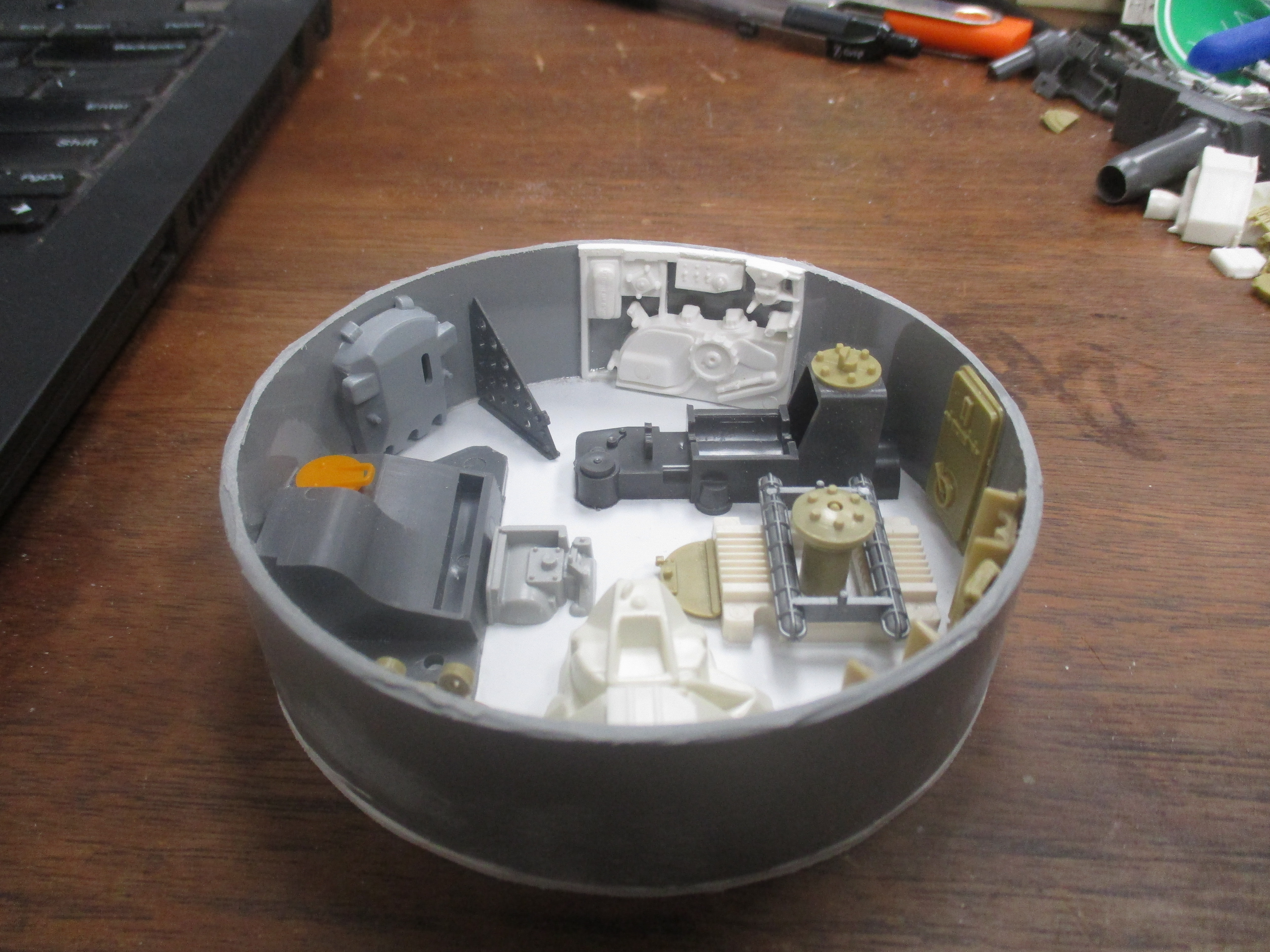

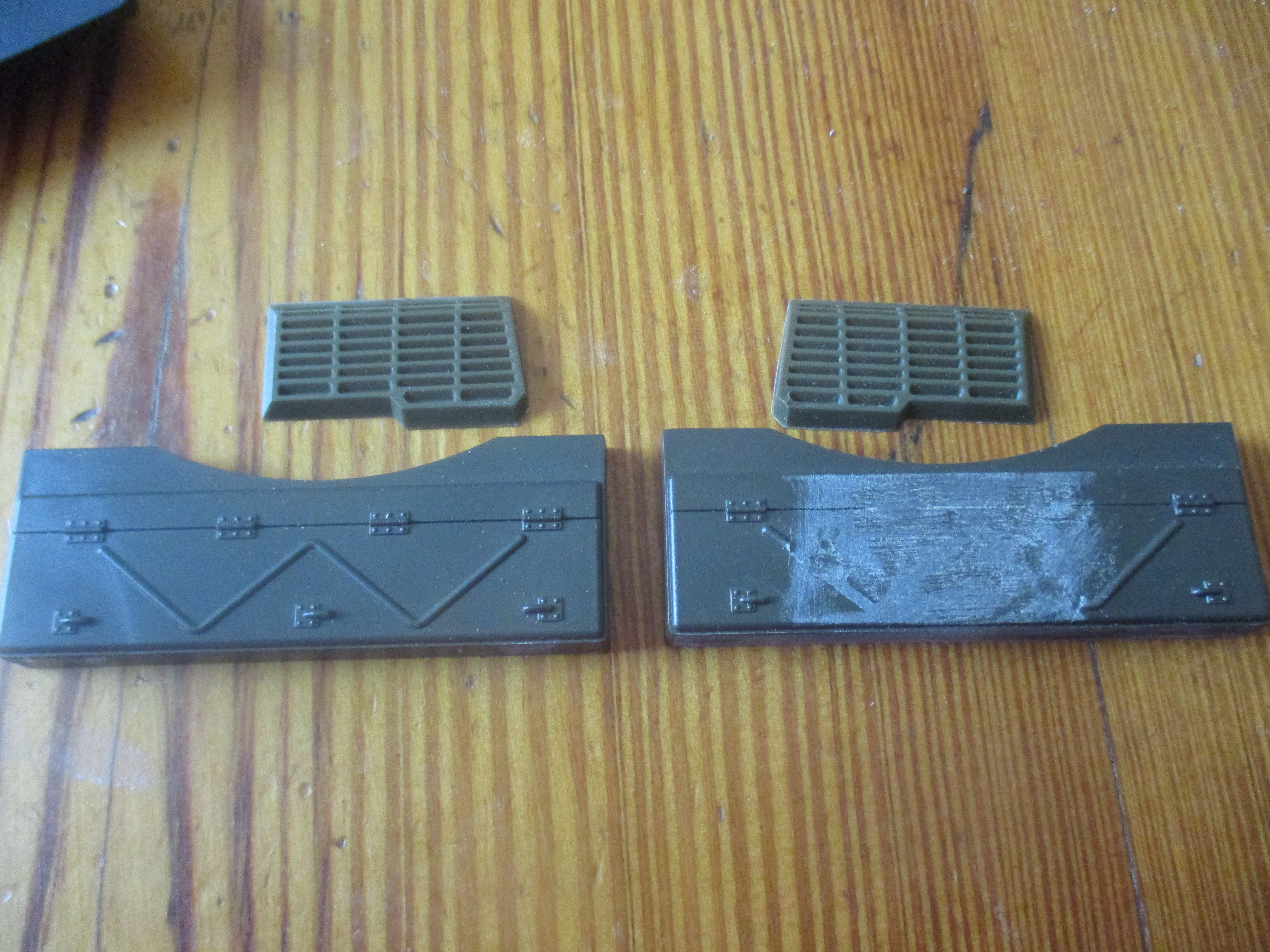

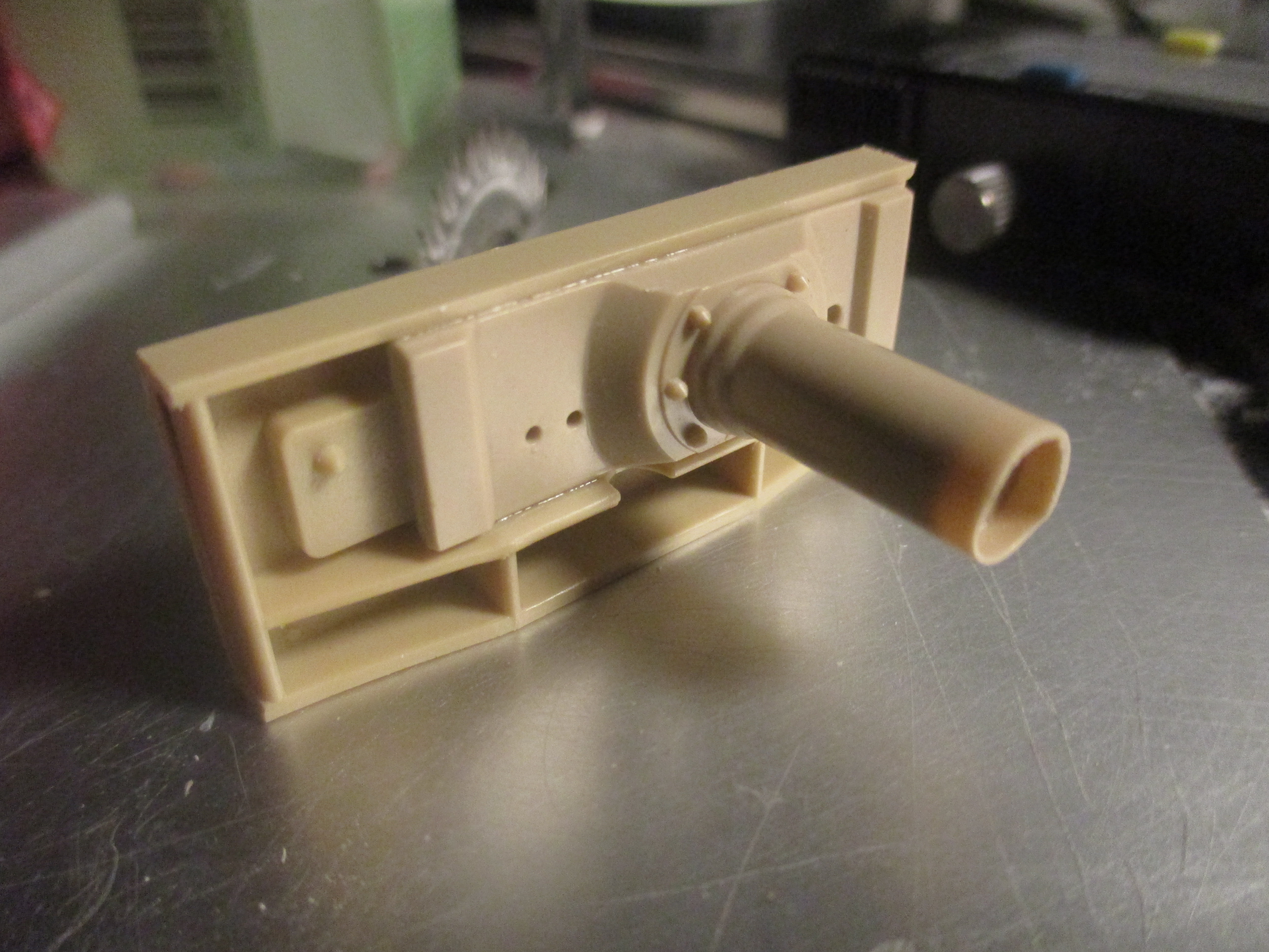

So Bandai Stug IV is definitely in that mandible maintenance pit, but heavily cut down on left and right sides.

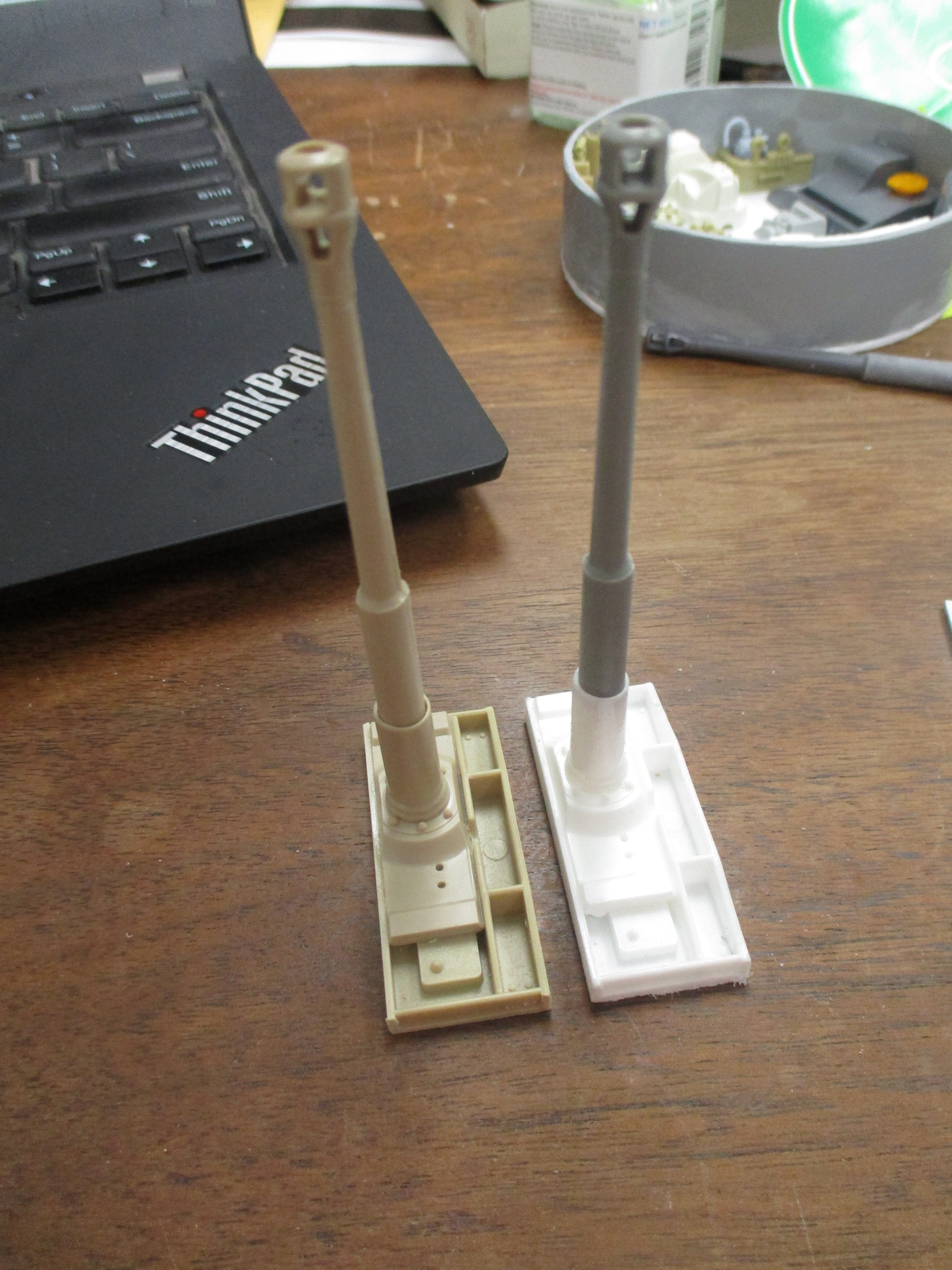

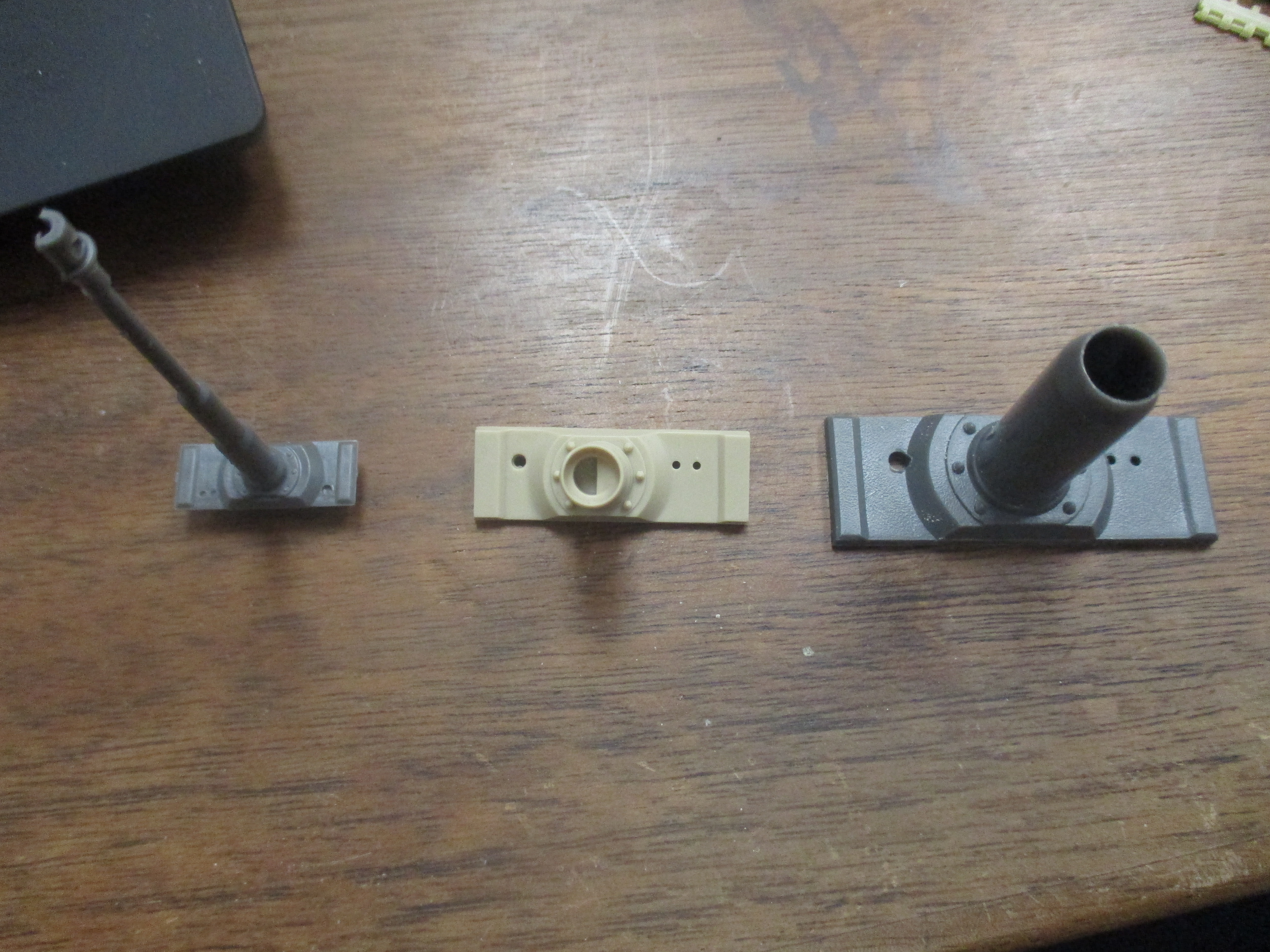

But whose Tiger I Barrel fits in there? Is it the Hasegawa 1/72? The Bandai 1/48? Or the vintage Tamiya 1/35?
Well, wouldn't ya know it?
Goldilocks strikes again!
(BTW, notice how the first picture makes the barrel on Goldilocks "disappear" almost entirely, and then in the picture above she's sprouted a long barrel -- THAT'S a good example of how easy fooling the eye is with the wrong reference photographs. In fact, in the first picture, the only "proof" there IS a barrel on the middle one is the shadow it casts on the table.)

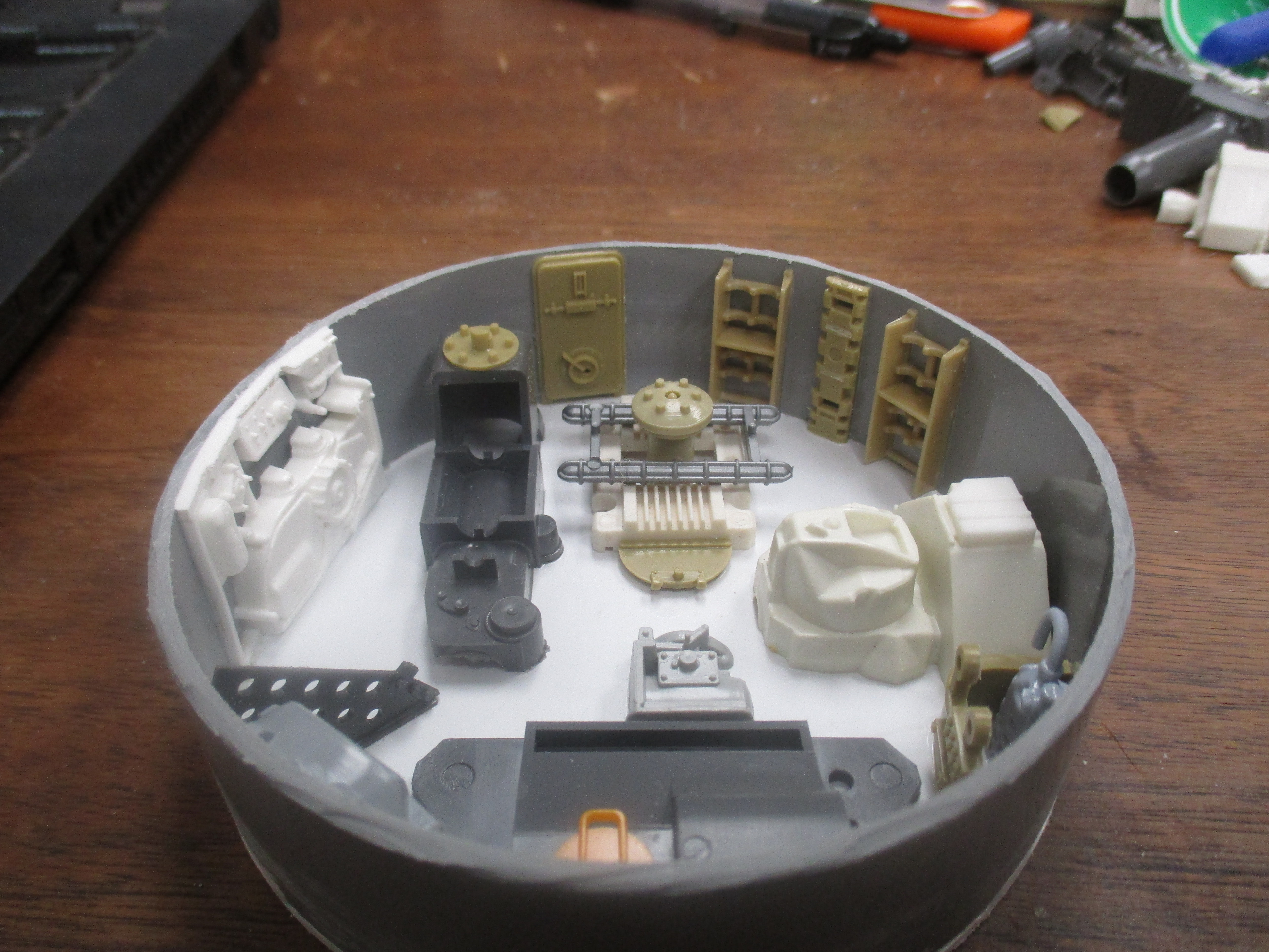

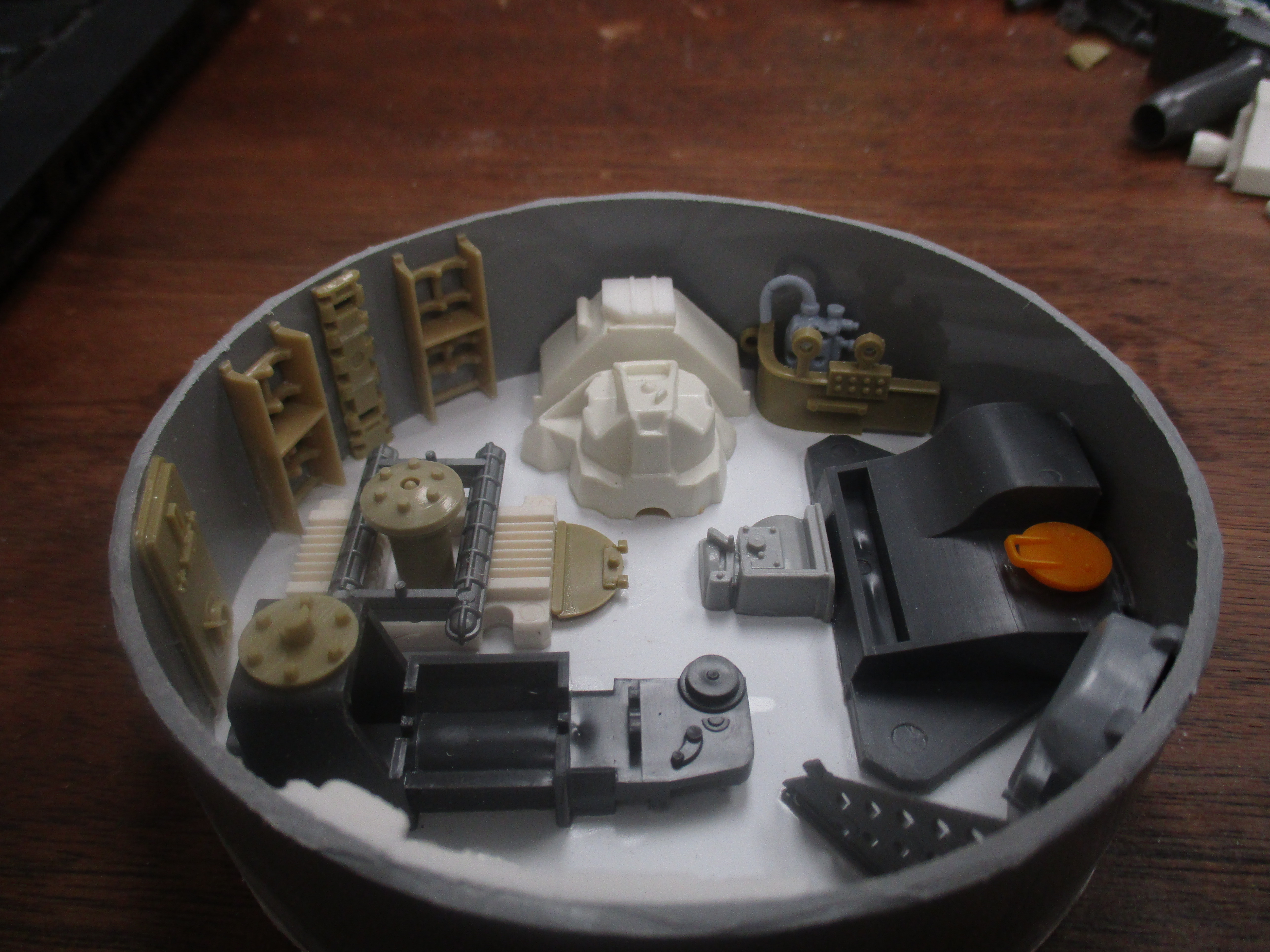

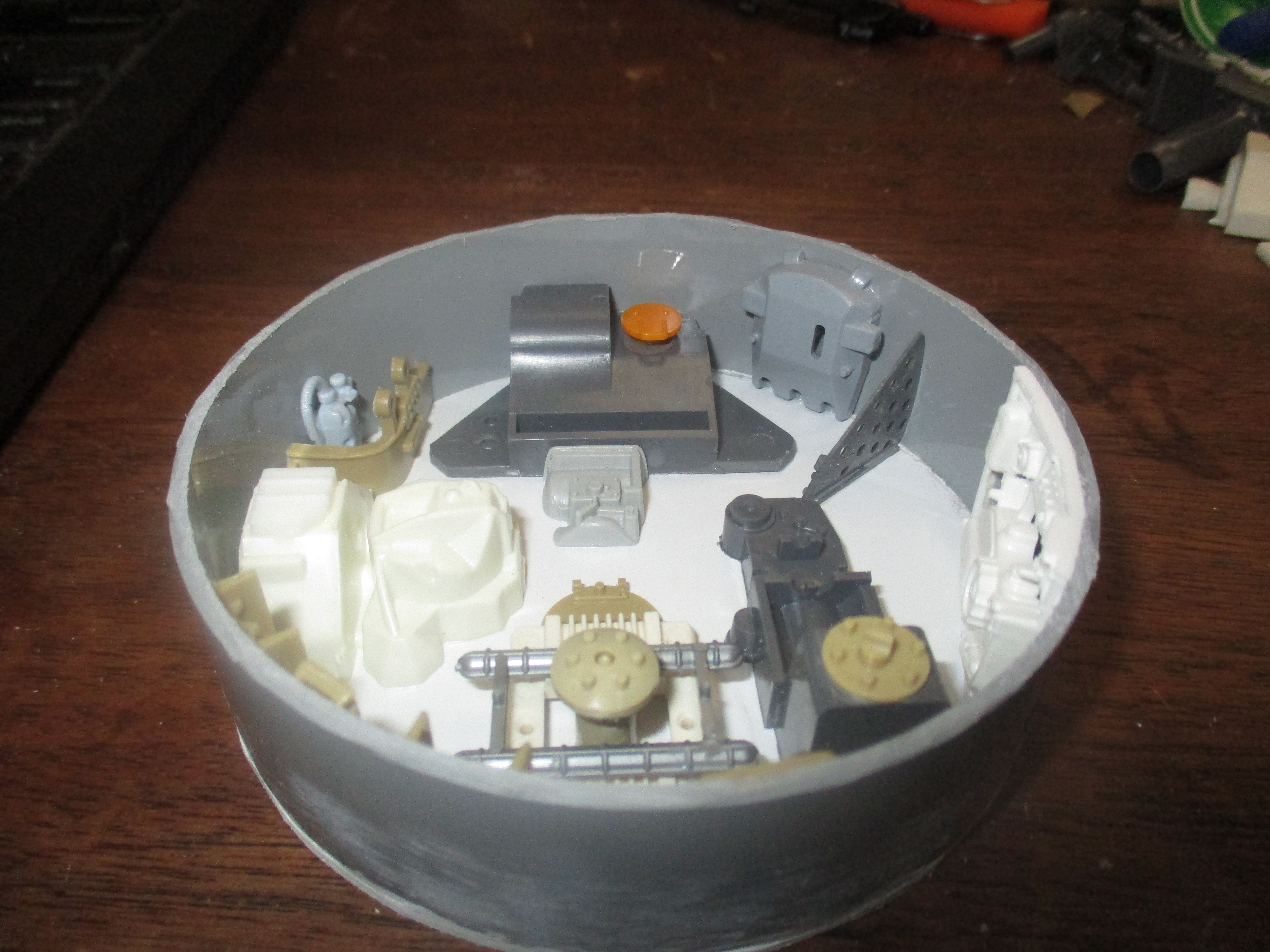

In other mandible pit progress news, I credit John Coffman for inspiring me to get this one knocked out:

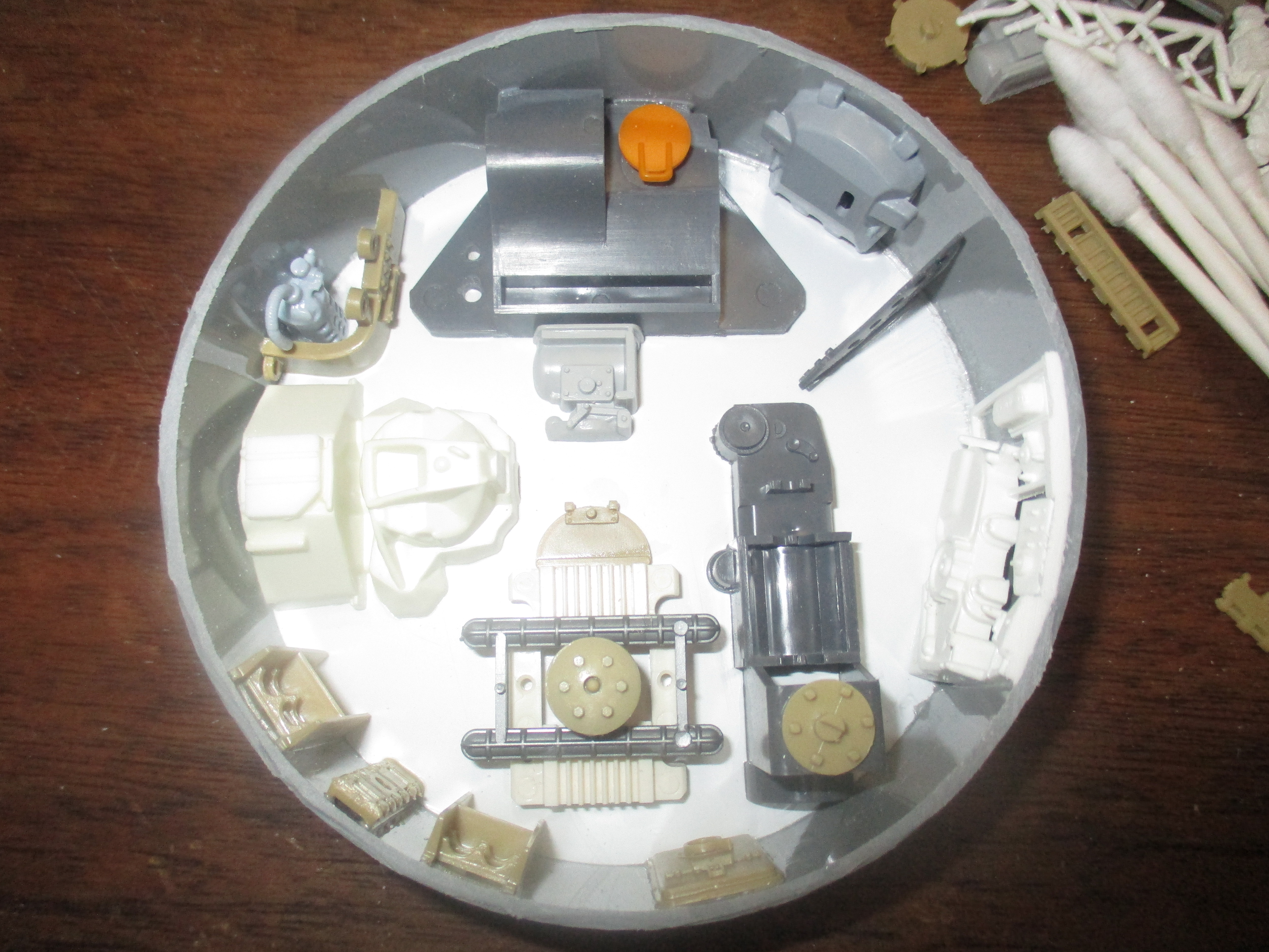

I'm stilling missing a Sealab part, but otherwise think it's all there. VERY hard to be certain of geometry and placements on these little guys, and I think I'm off by a couple of mms in various areas here, so may end up doing it over. But meanwhile, here are some angled shots to see the sidewalls...
There's also one un-ID'ed part on top of the Hanomag piece, a part that covers most of the front slot, but I haven't found it yet.
Pretty sure that piece is part of a machine gun.
Also, since you mentioned the Sealab, I emailed masterpiece models, and they are getting ready to offer their Sealab kit again.

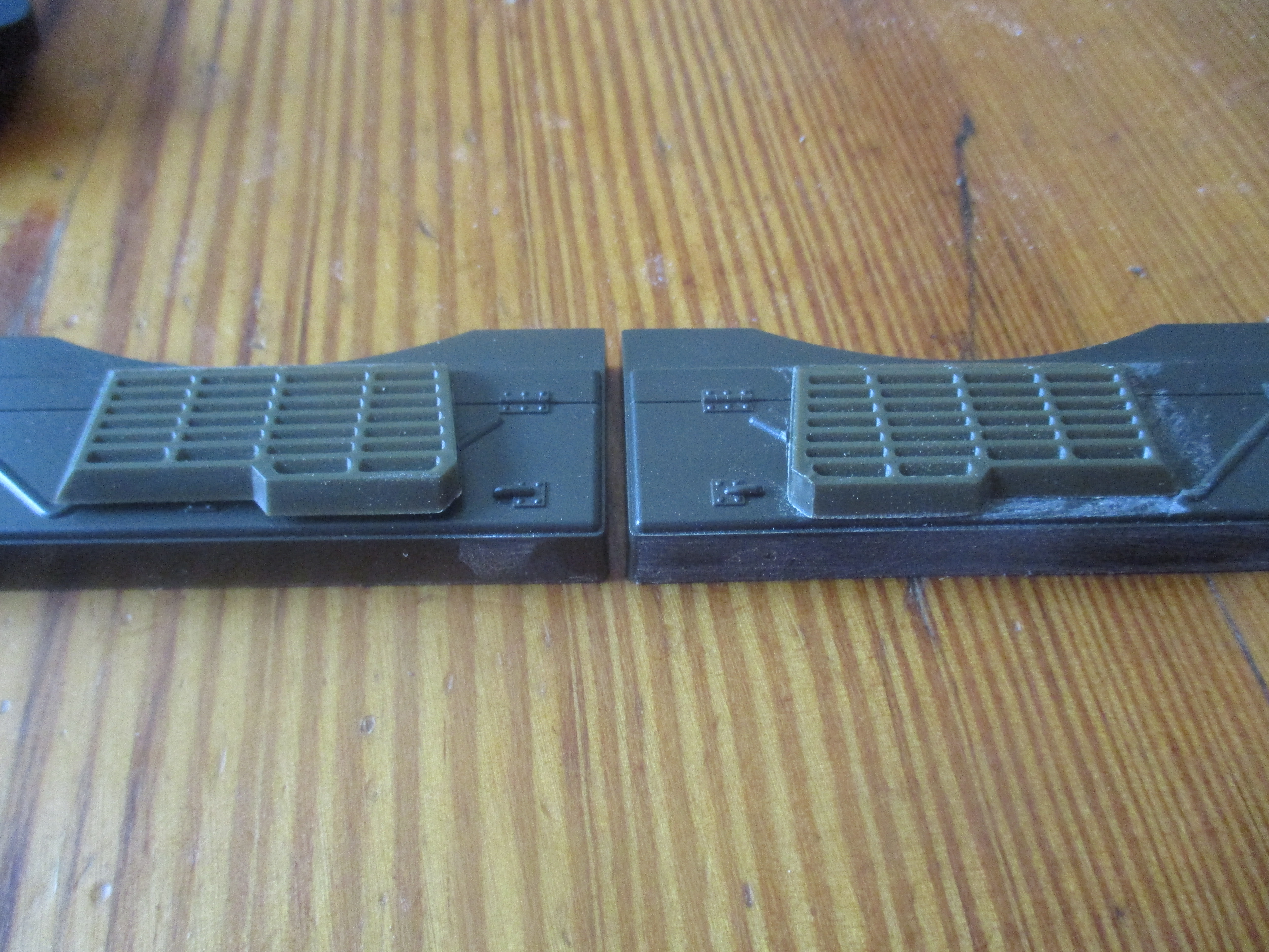

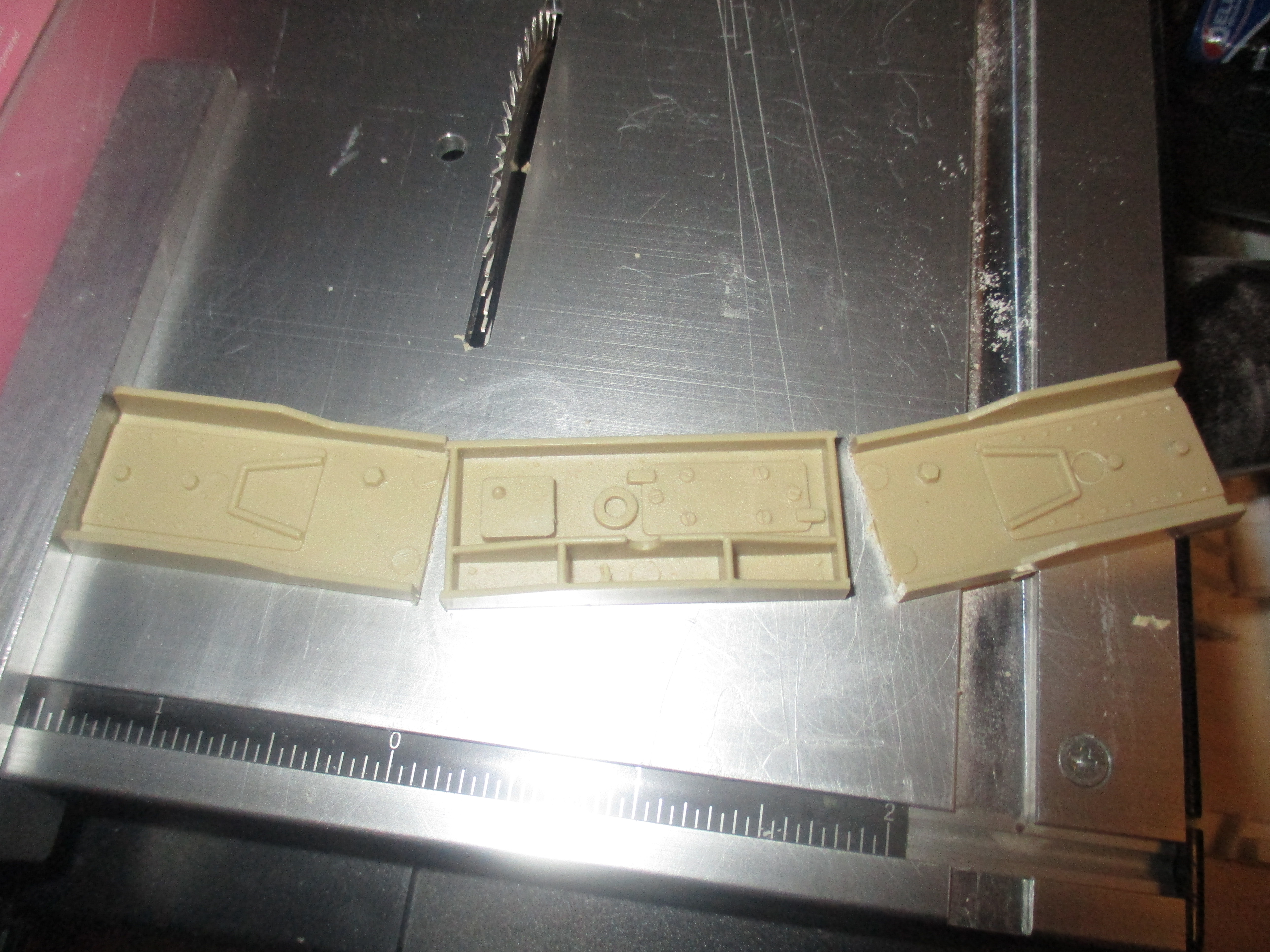

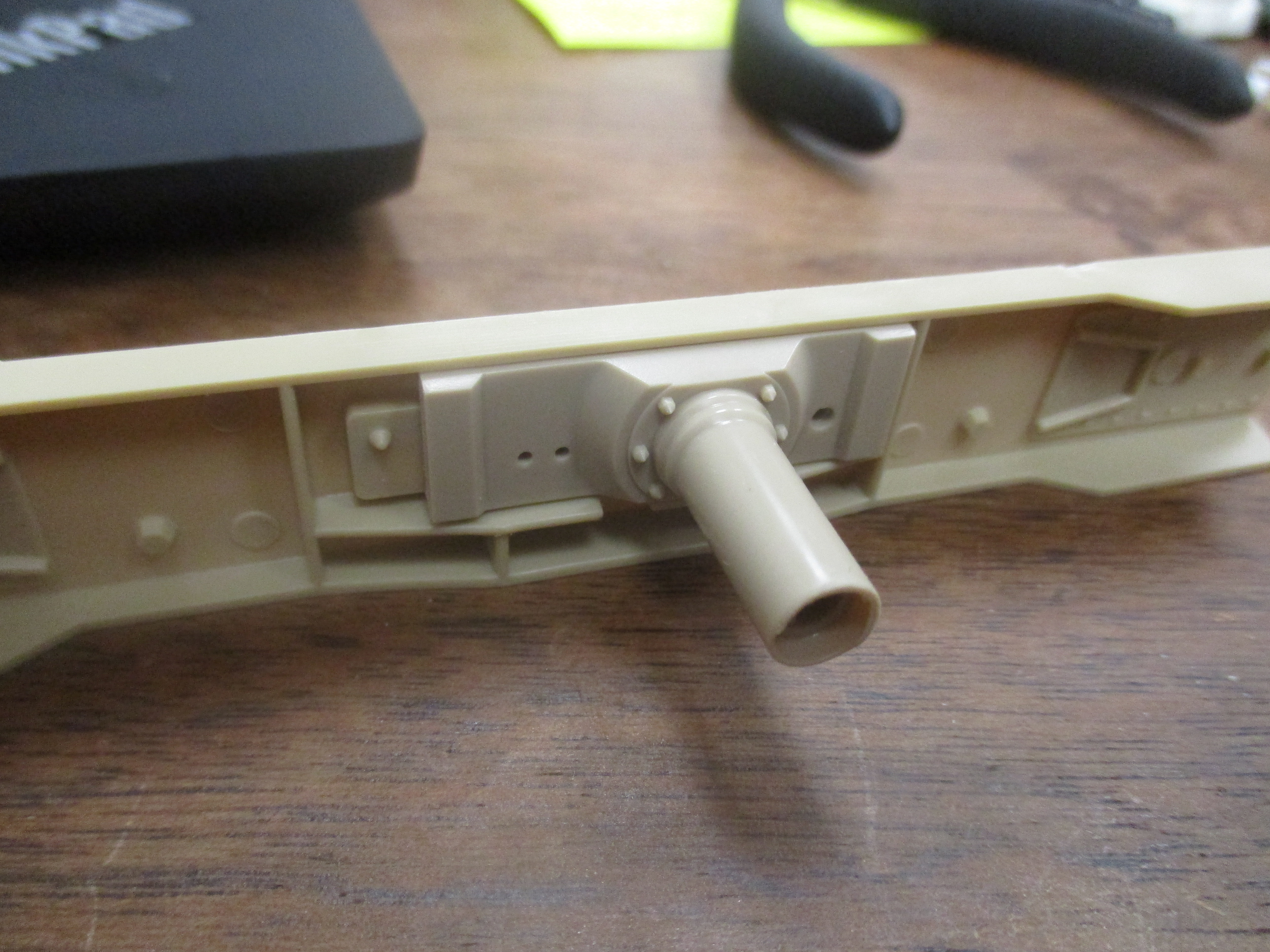

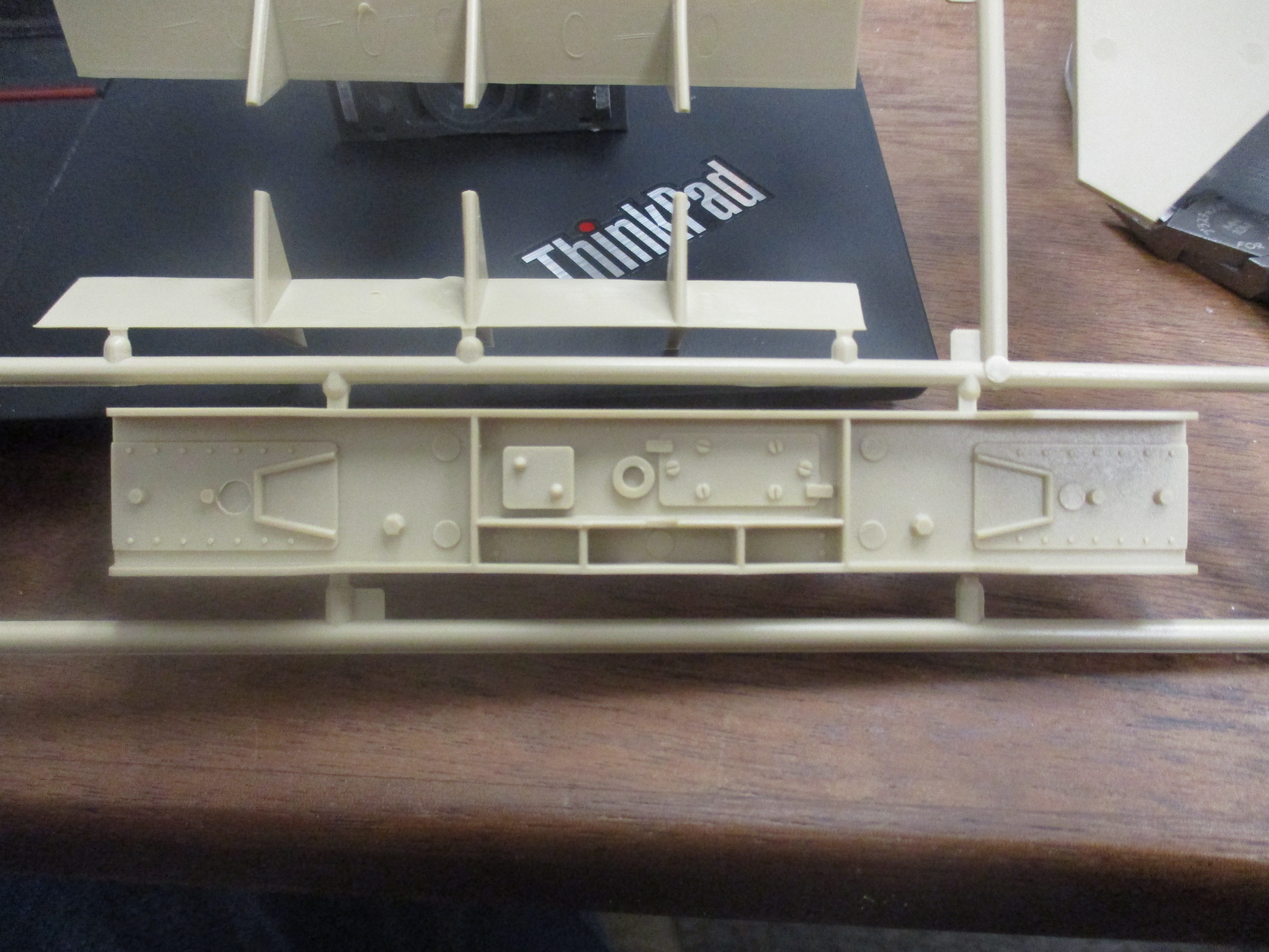

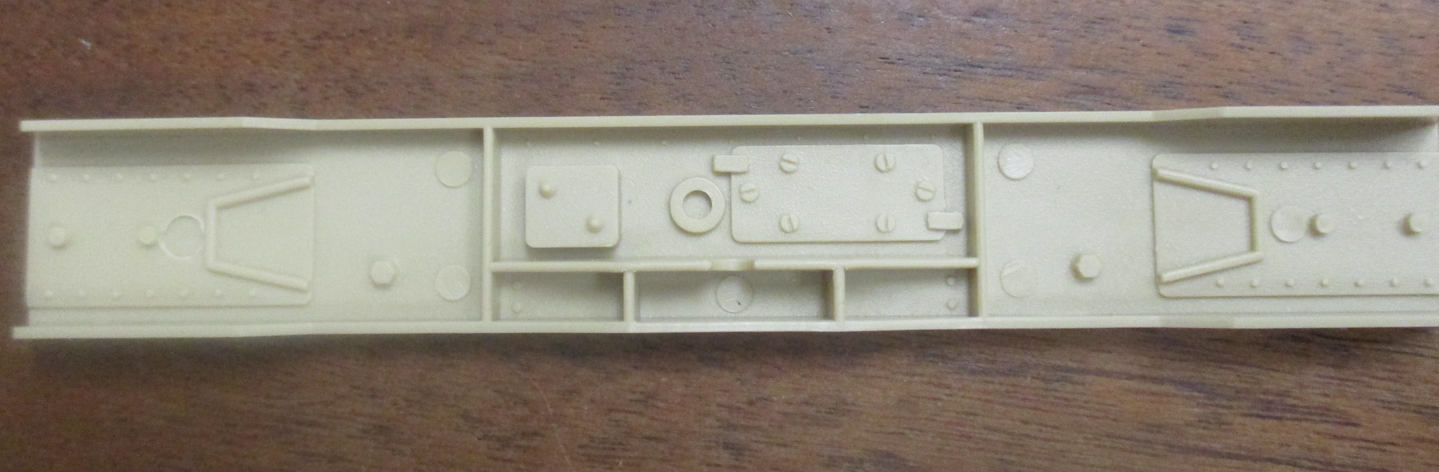

Stug IV piece in its original glory at full length
Then you slice off either end.

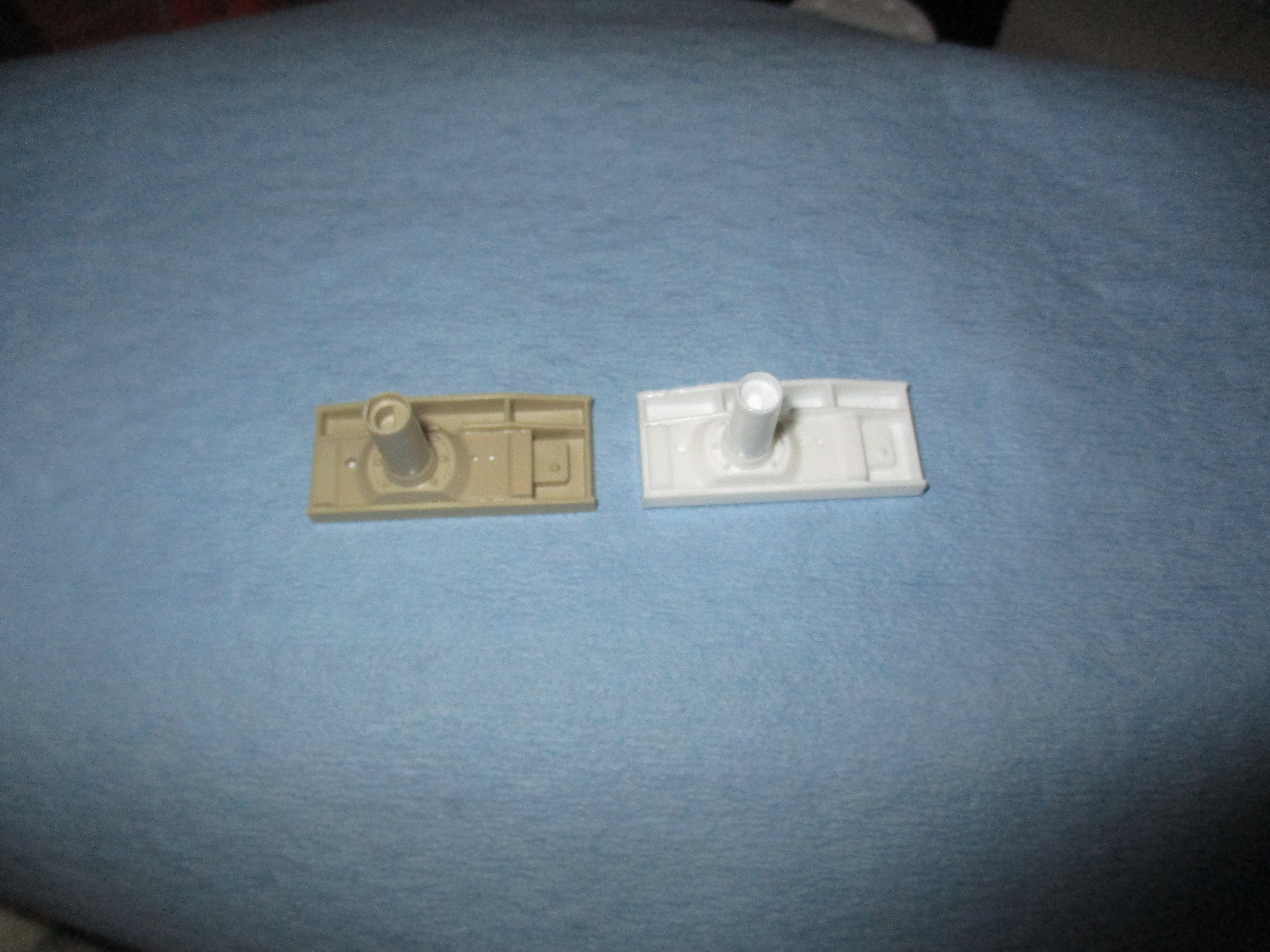

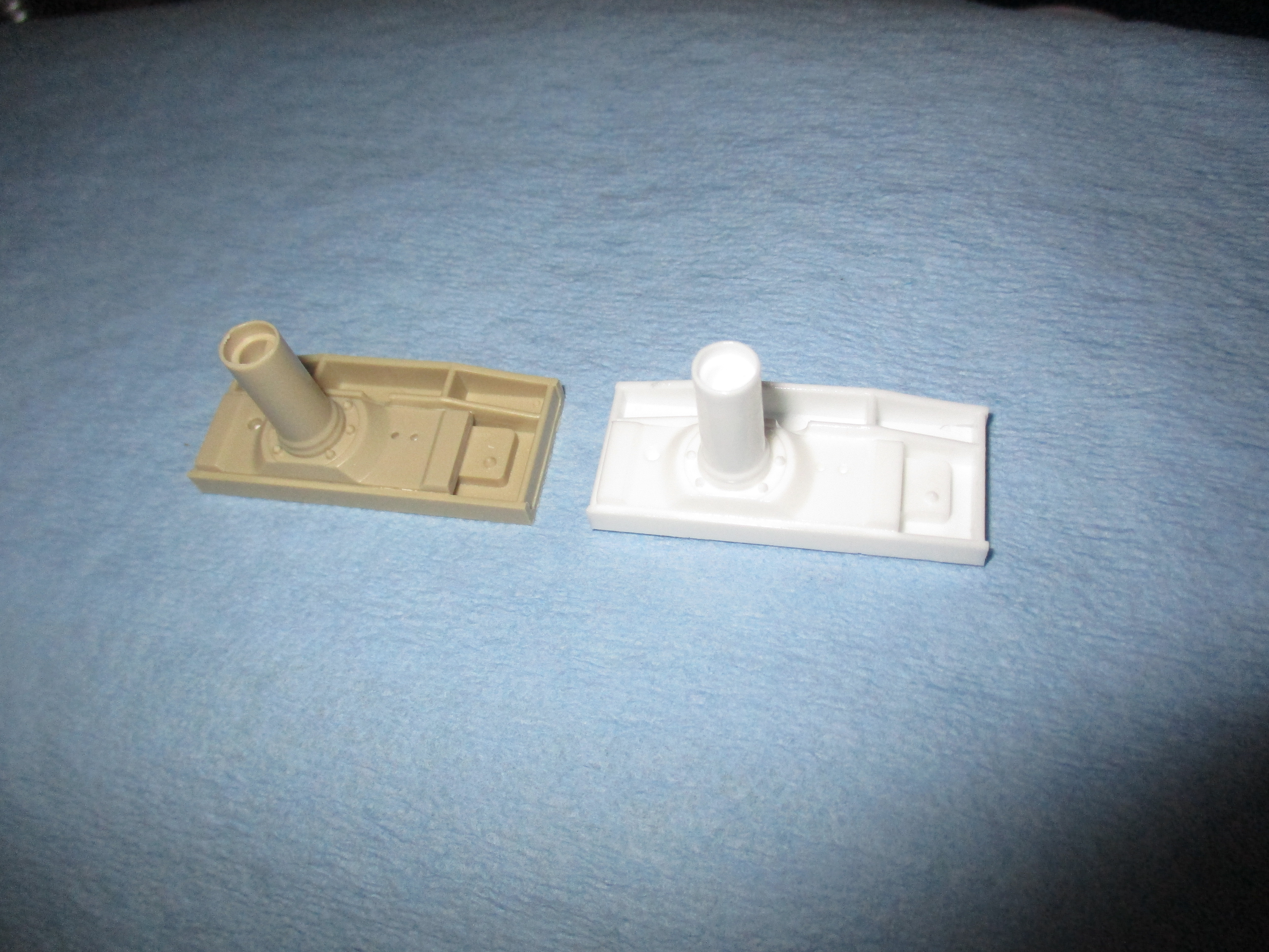

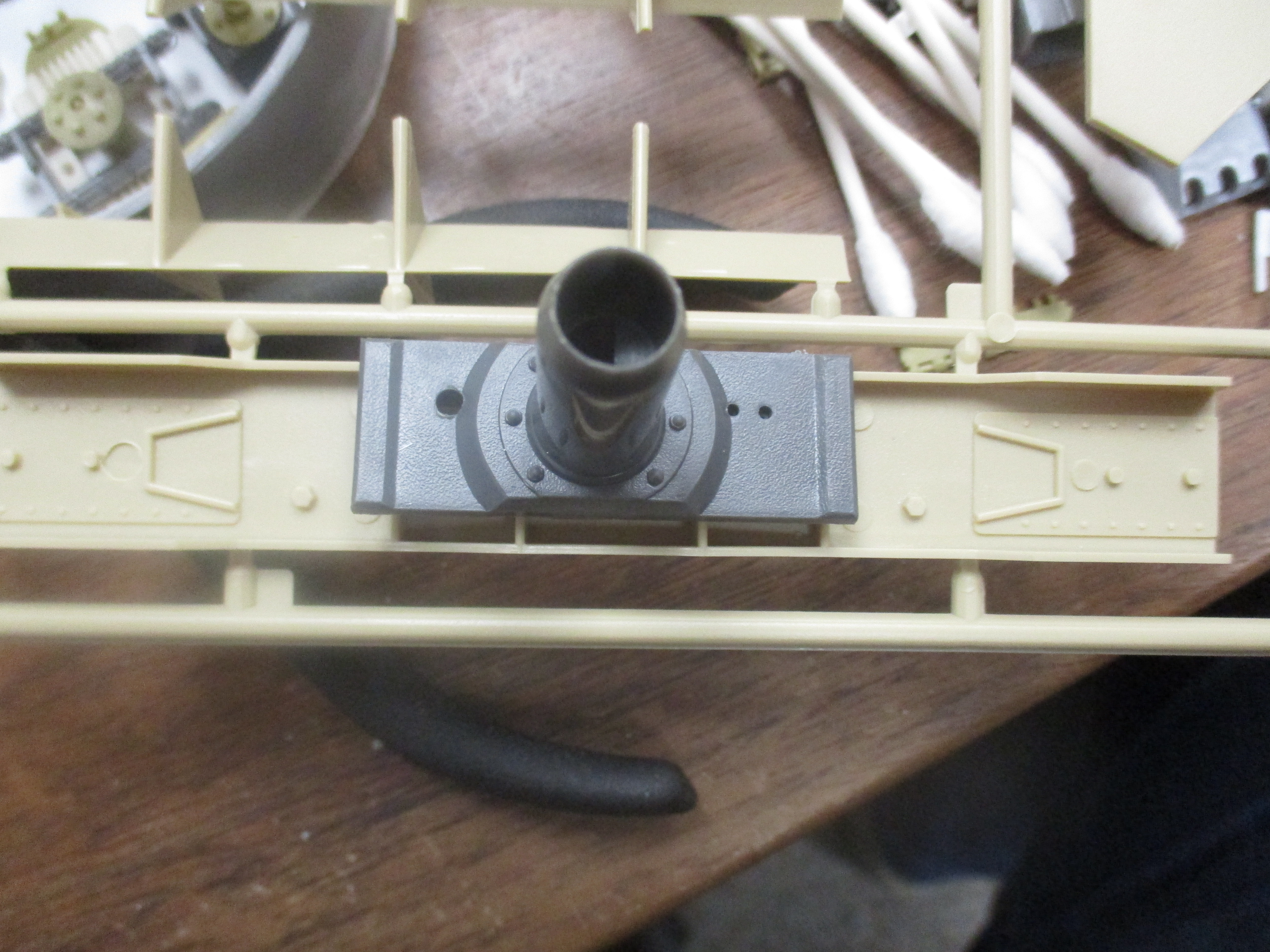

Then you figure out which greeblie fits in there: the Tamiya 1/35 Tiger I barrel was definitely too big.
The Bandai 1/48 Tiger I barrel is the right one, and you glue it in "to the right" of the upper section of the Stug greeblie, after doing the appropriate slicing/sanding off of some detail so it sits flush.
Two build philosophies: exact replica, or super-accurized model?
On the left -- exact replica. On the right -- super-accurized.
