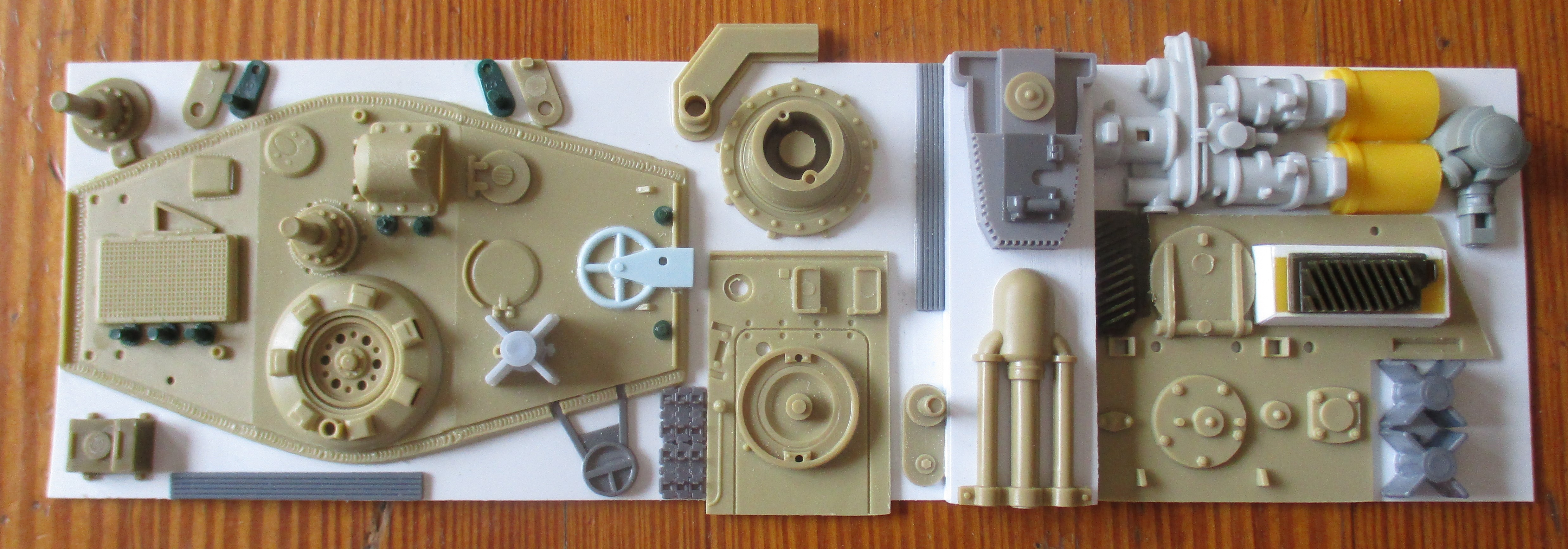

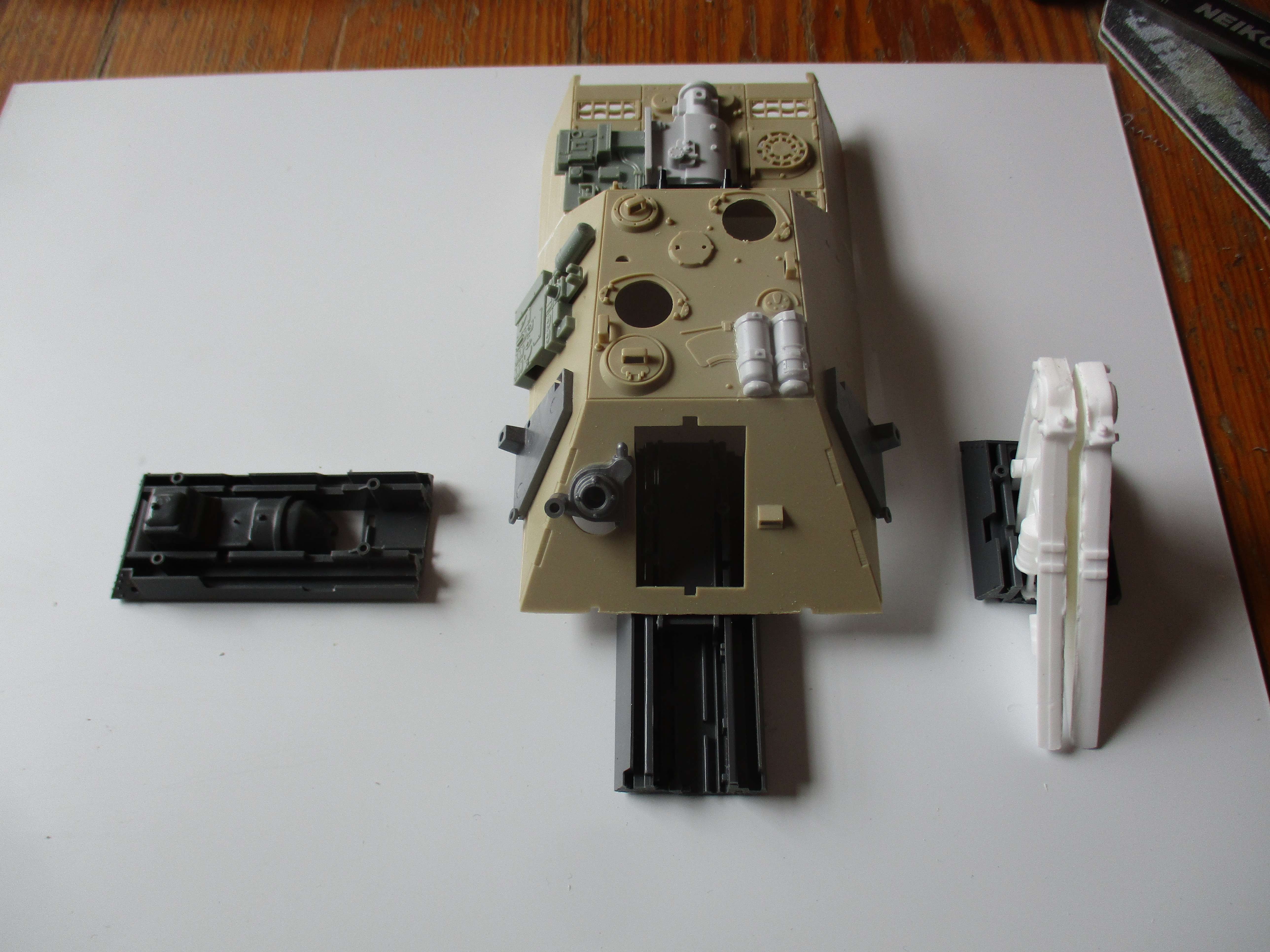

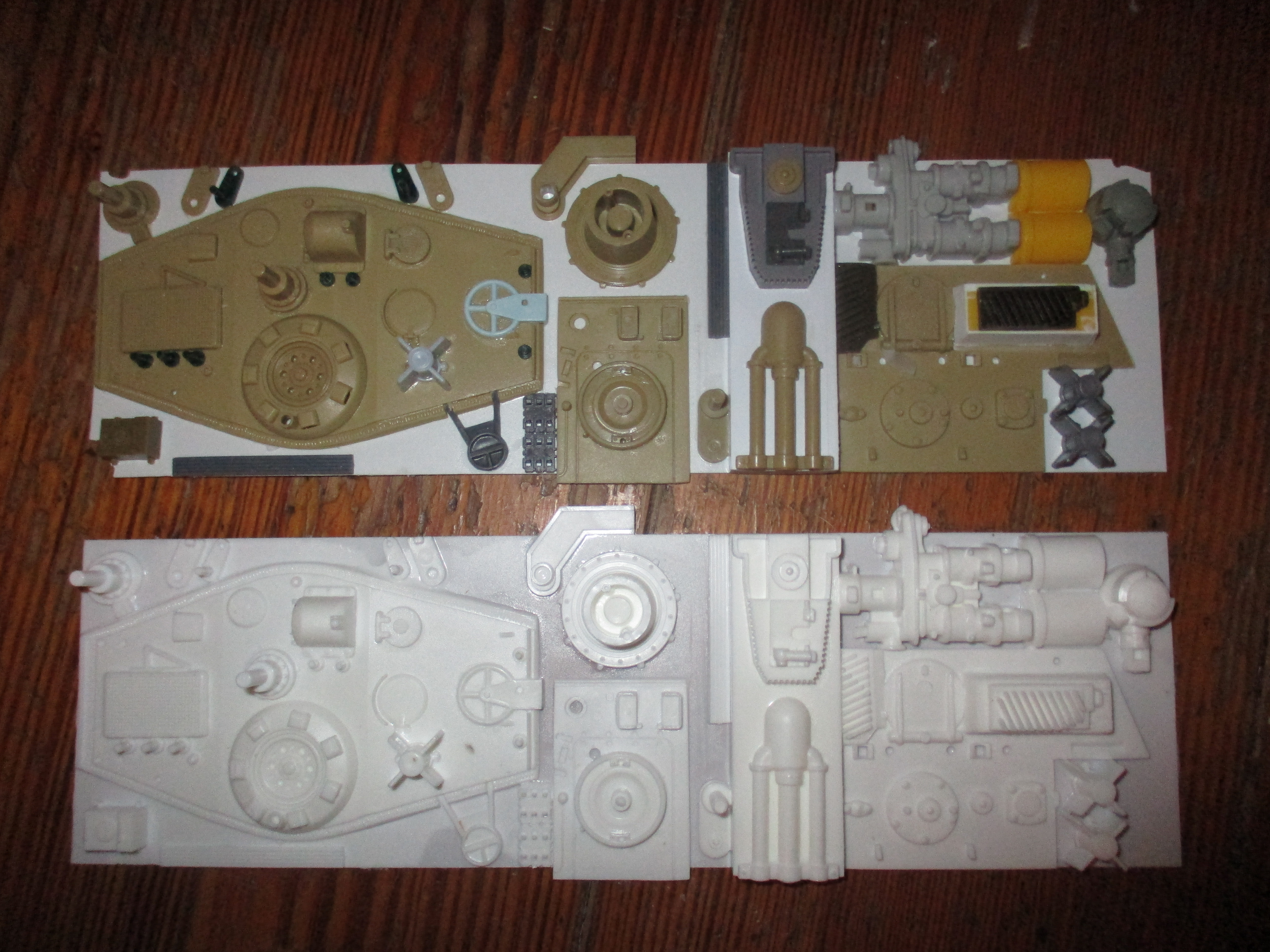

I couldn't find the exact piece that goes underneath the Tamiya 1/35 M60A1 engine grille piece (#C15), so I cobbled it together from a similar size greeblie from the Payhauler 350 plus some card stock.
If anyone knows what piece this is actually from, I'd be keen to know and fix it again.

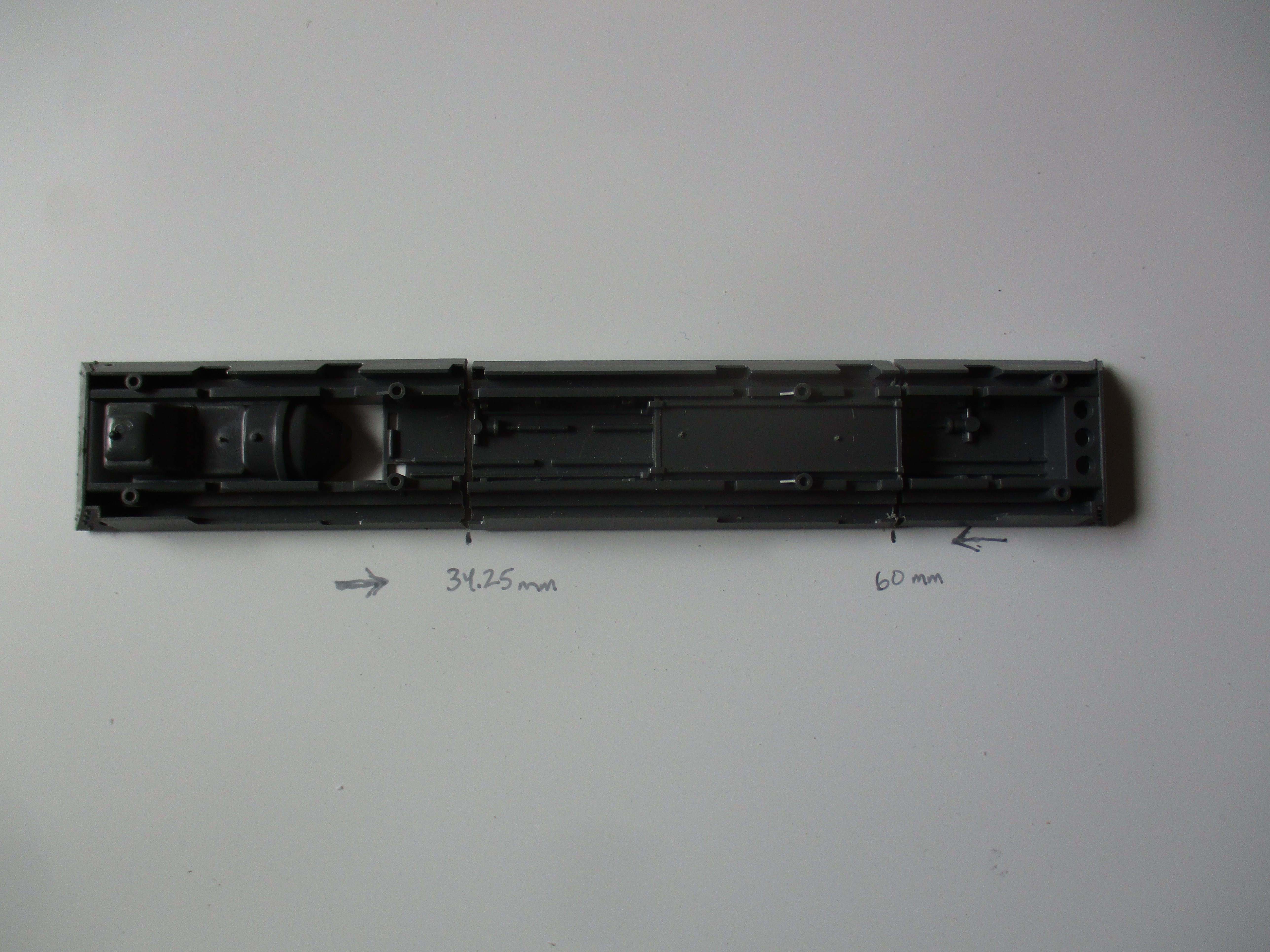

If you cut this one just right in two key locations...
You get three uses of one 8rad upper hull section, and (I think) a perfect imitation of how ILM approached their "leftover" pieces.
Left to Right: Port Side front mandible sidewall dressing, Jagdpanther maintenance pit greeblie, and Hummel vane assembly base.
In retrospect, I would have made the first cut 34mm from the end, as the .25 took off just a scoche too much of the detail visible on the reference material.
Yup -- already done. Want one, er, two, er three? If so, PM me ASAP as these molds will break down soon since most of these castings are already accounted for by others. The first ten are already gone, so you'd be getting a later "pull" which means more routing out of the undercuts.

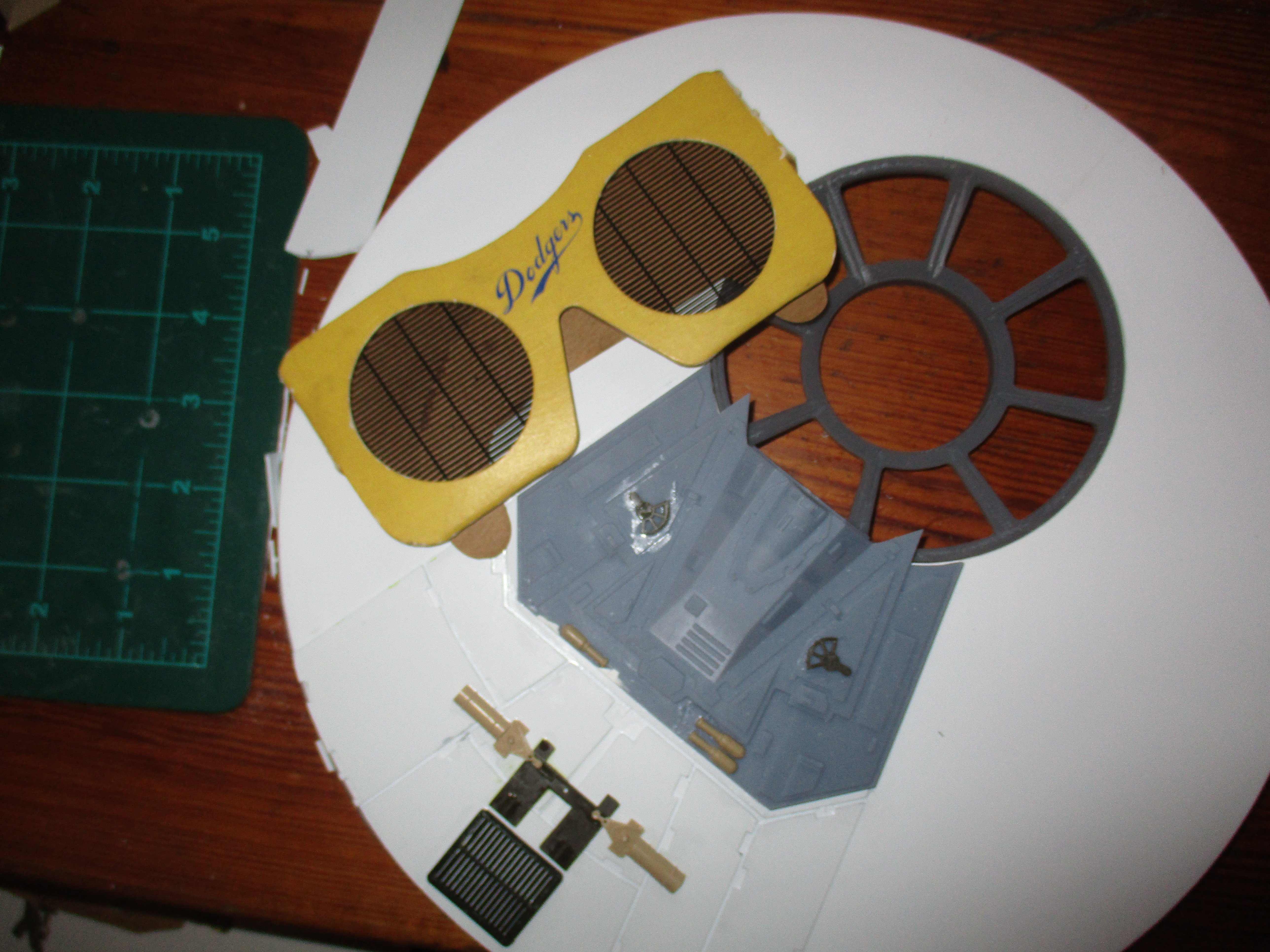

I found some more Koolshade!
But it's, like, literally, for Koolshading your eyes...
Apparently this was the way they marketed the product in the 1970's for Brooklyn Dodgers Fans. (And no, the eye-pieces are NOT, alas, large enough to cover an engine vent ring. That was the first thing I thought of as well).

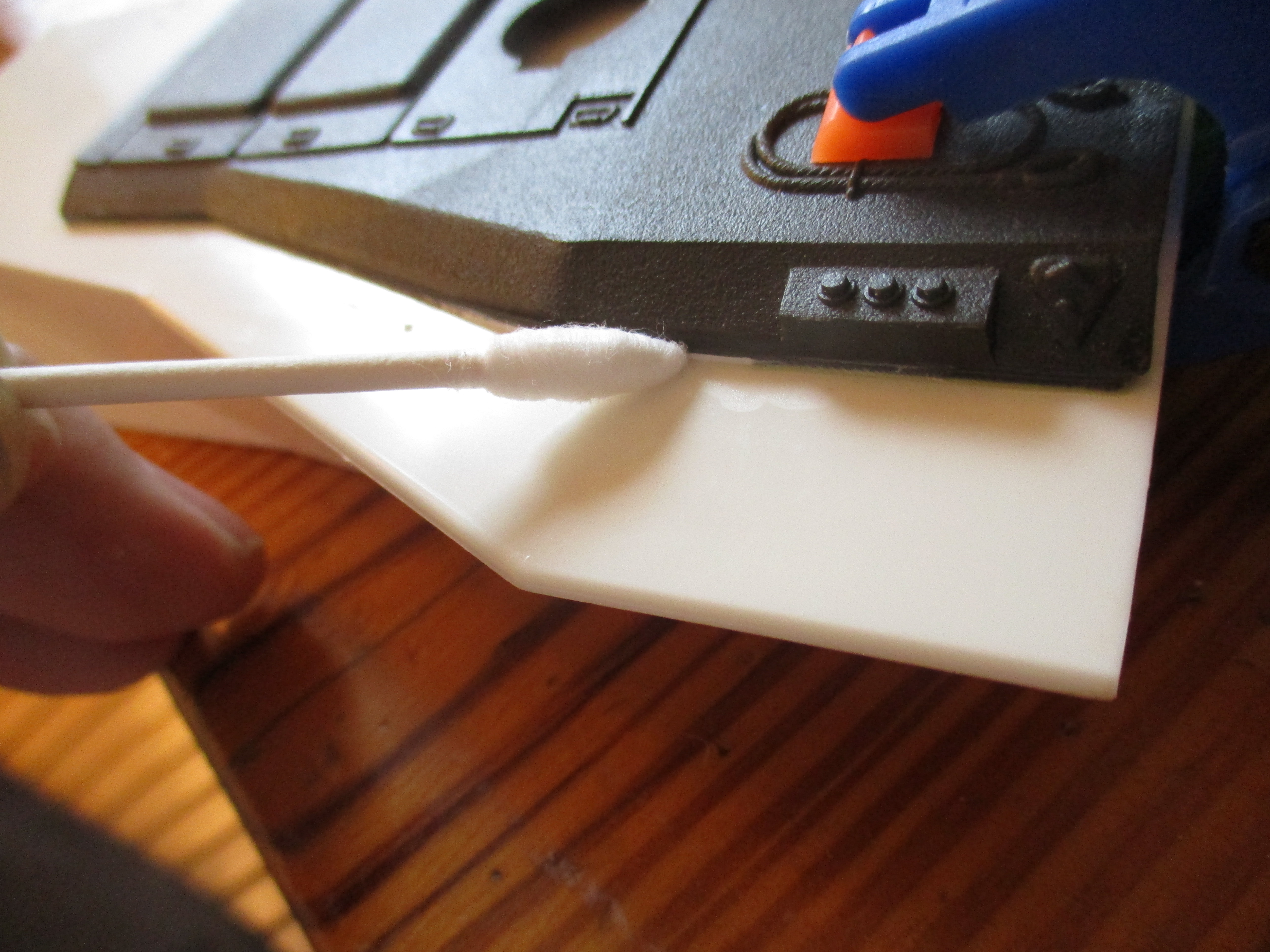

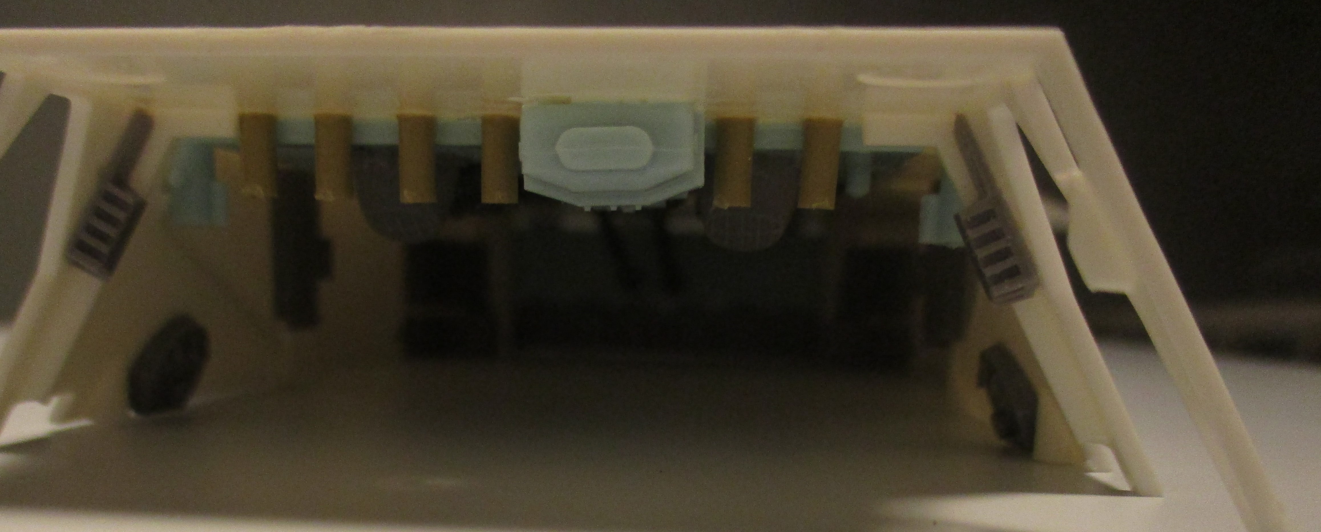

Under PRESSURE...

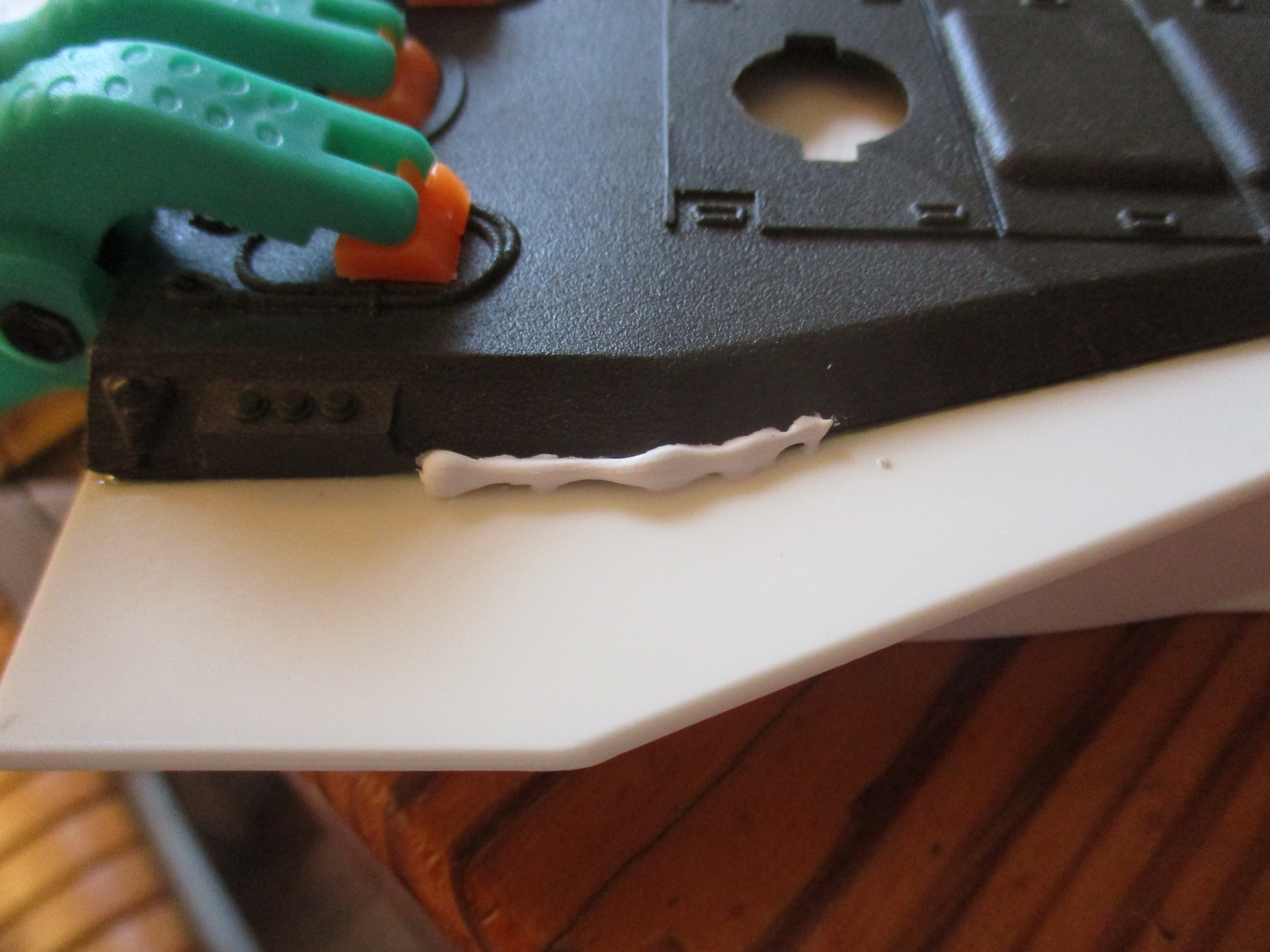

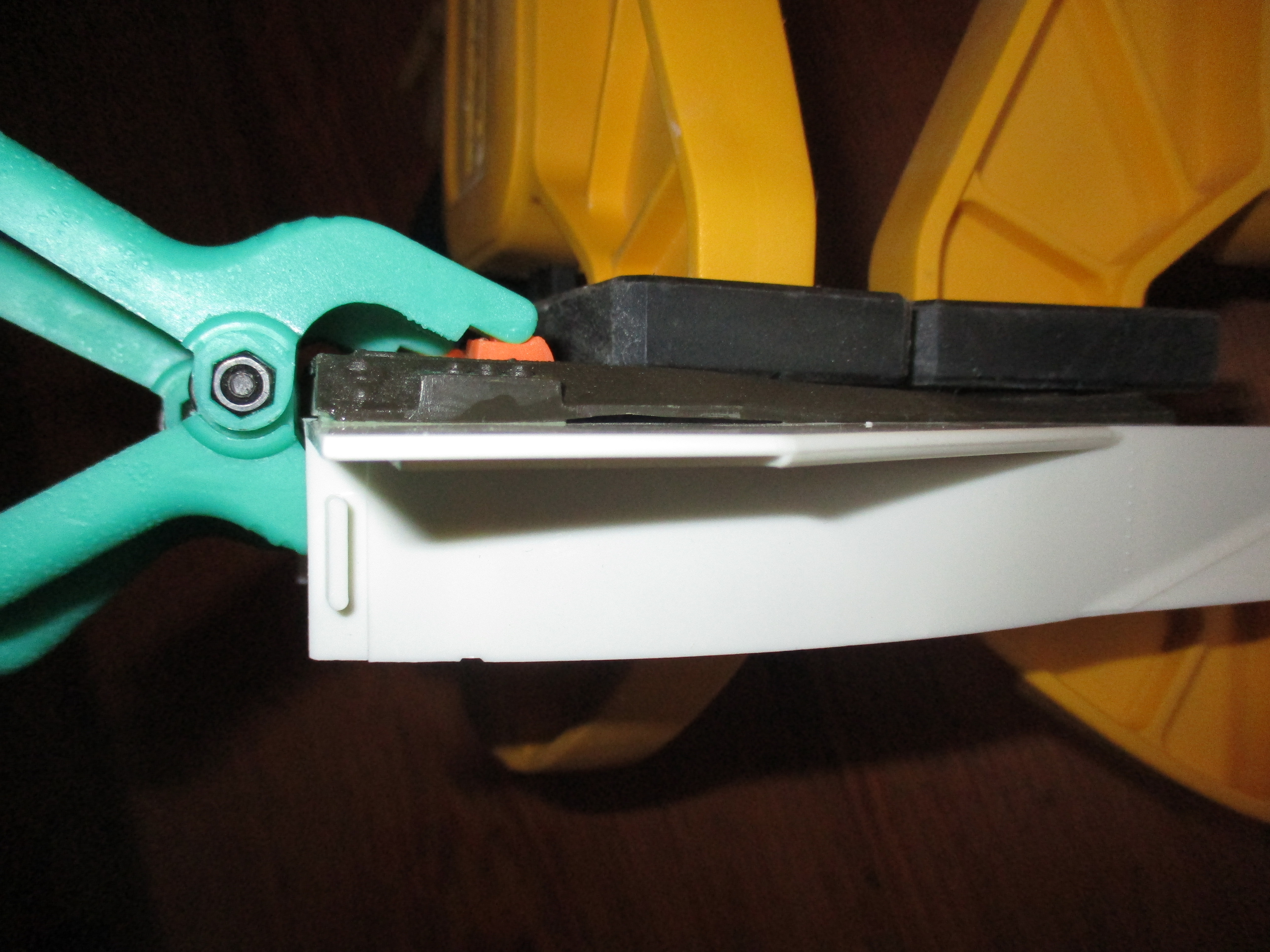

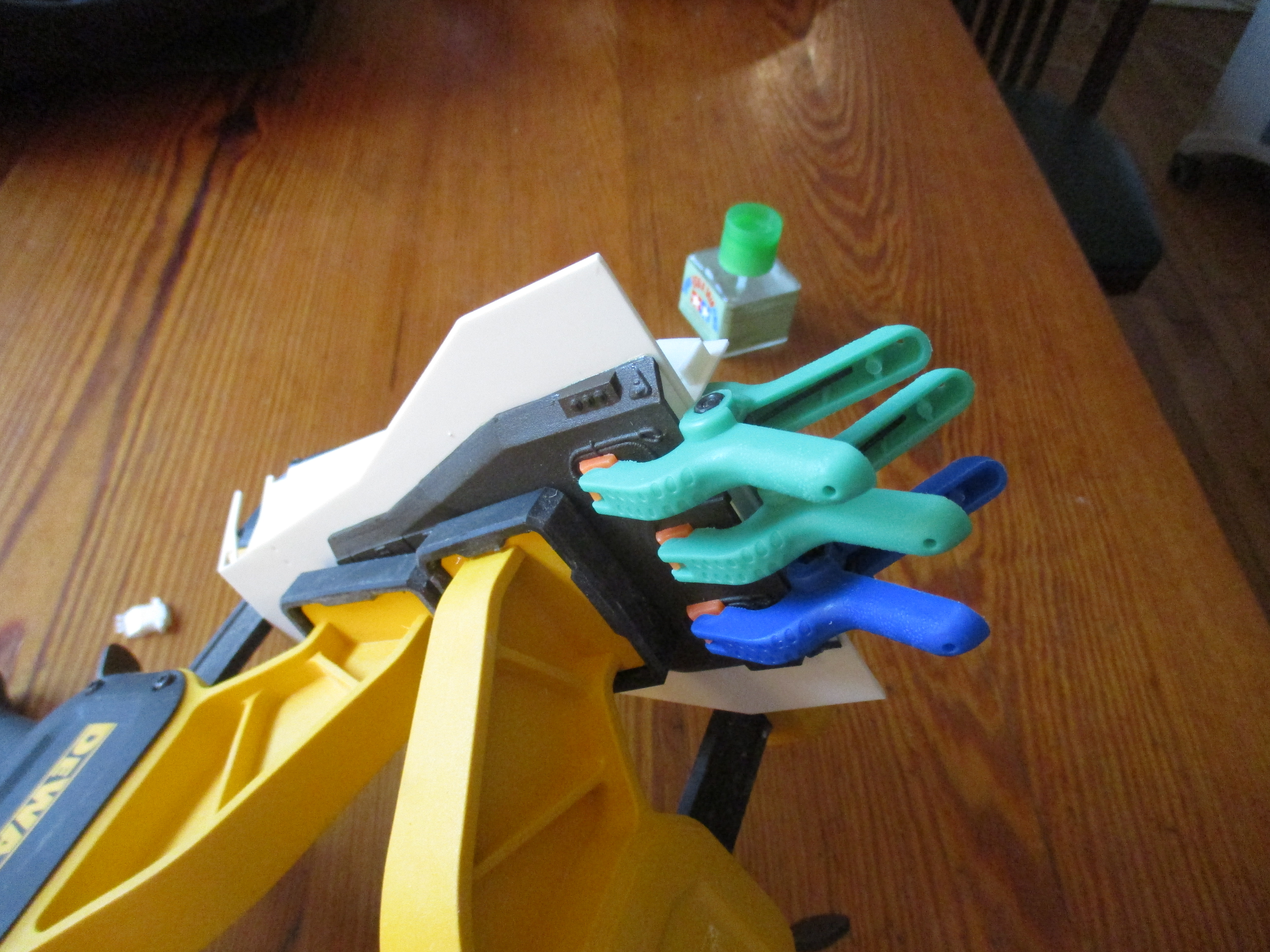

You need a LOT of lateral forces driving evenly down on your M60 upper deck section to get it tight and flush and flat with the upper flat surface of the Yardley McLaren M23 monocoque body.

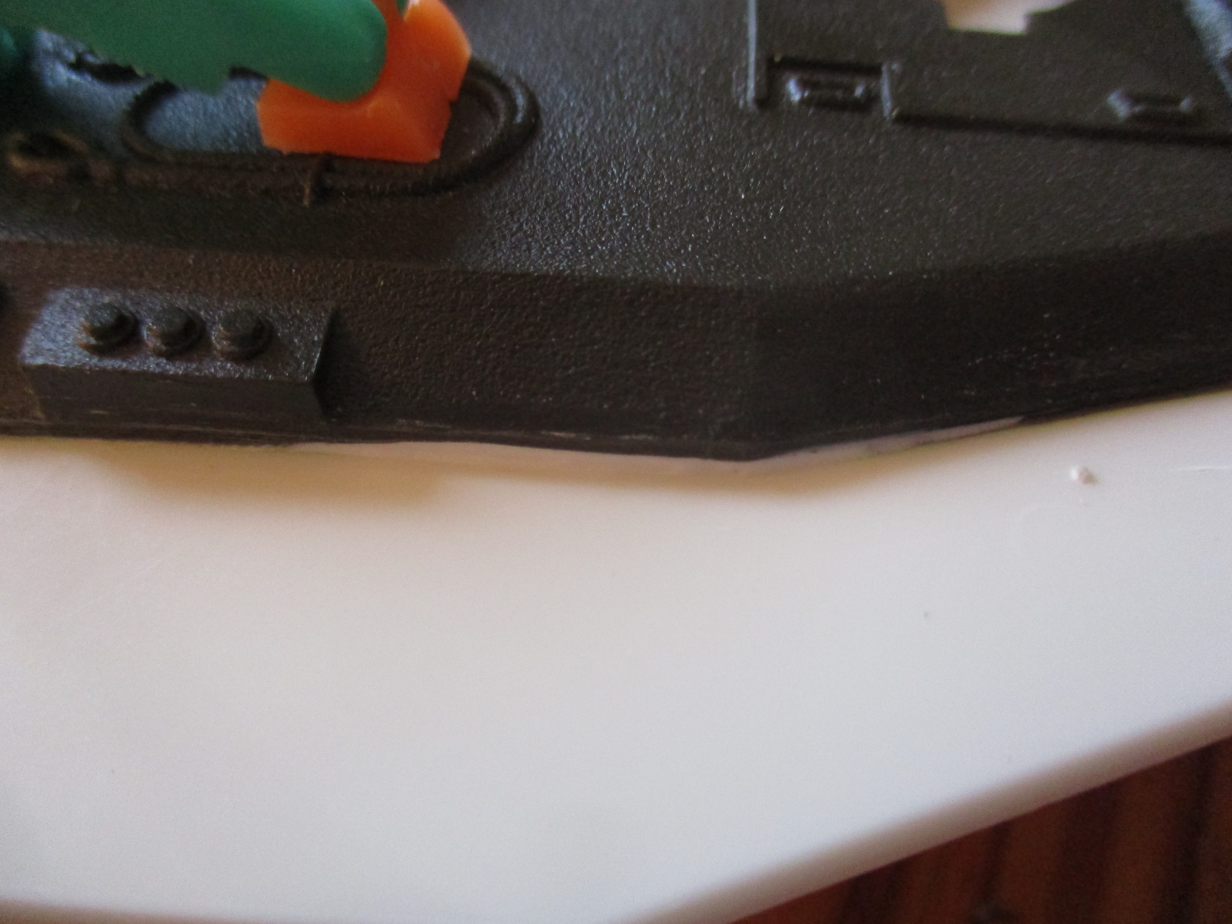

Even so, I had a small gap at the end...
So I had to use my favorite filler, Perfect Plastic Putty, to rescue my results...
And then my favorite disposable tool, the "Precision Tip" Q-Tip (no longer manufactured), to fair it all in and make it seamless:
Ditto for the other side...
But I'm happy with the results.
Next post, I'll show you how many greeblies go on the underside of this assembly, even though it never gets seen!
I recall it took some effort to seat the M60 part also, but with superglue & pressure holding it down & kicker... no problem.
You probably don't need the putty as the edge is wrapped in styrene rod acting as piping leading from the from down into the rear. ILM i would say added the piping to hide a not so good seam.
