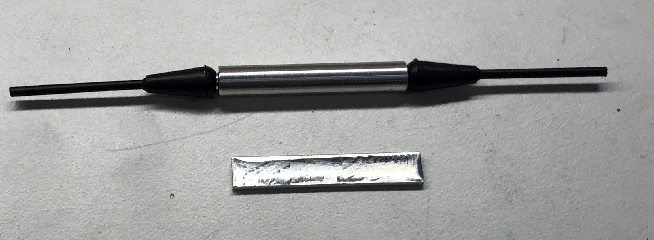

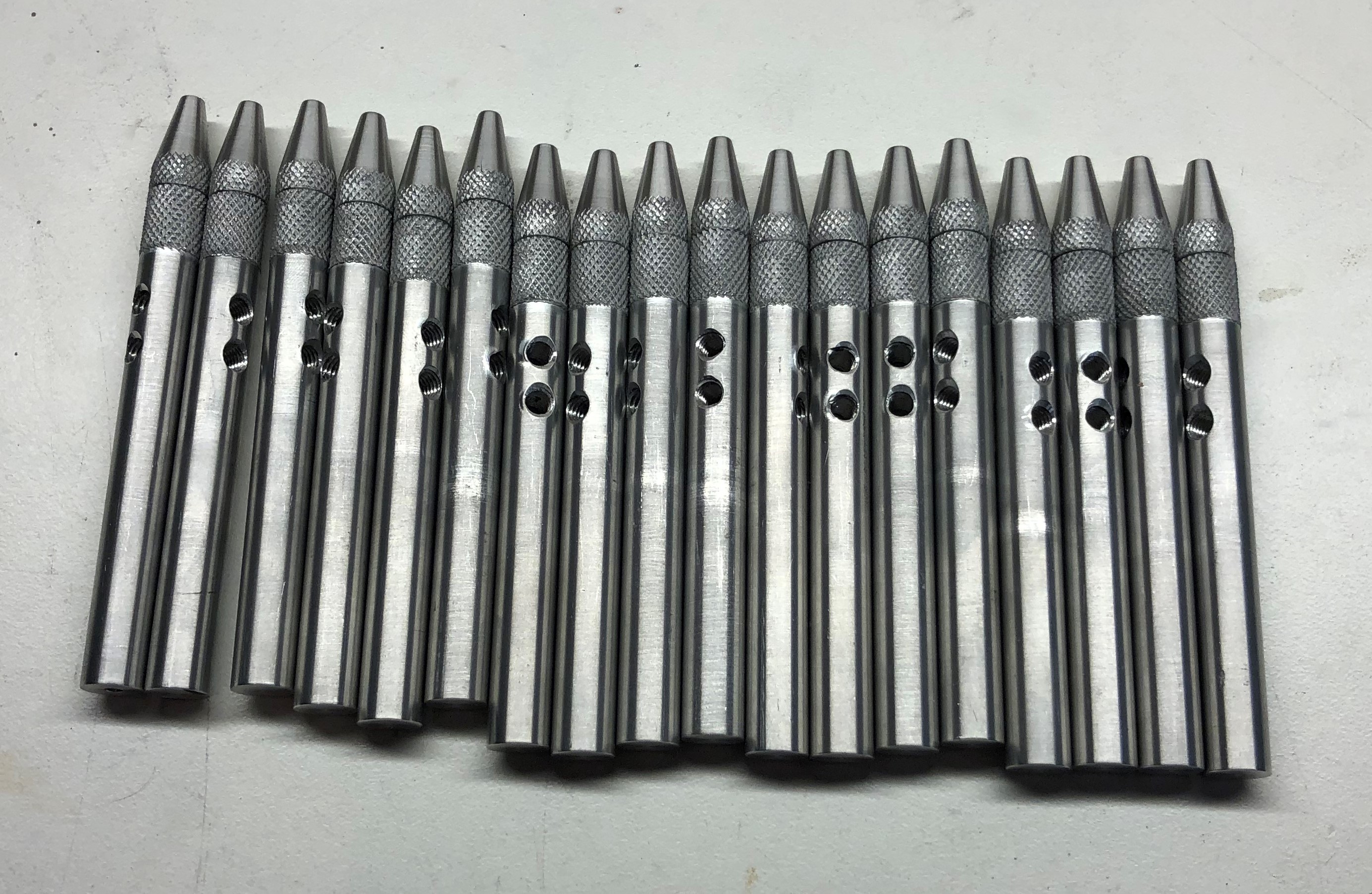

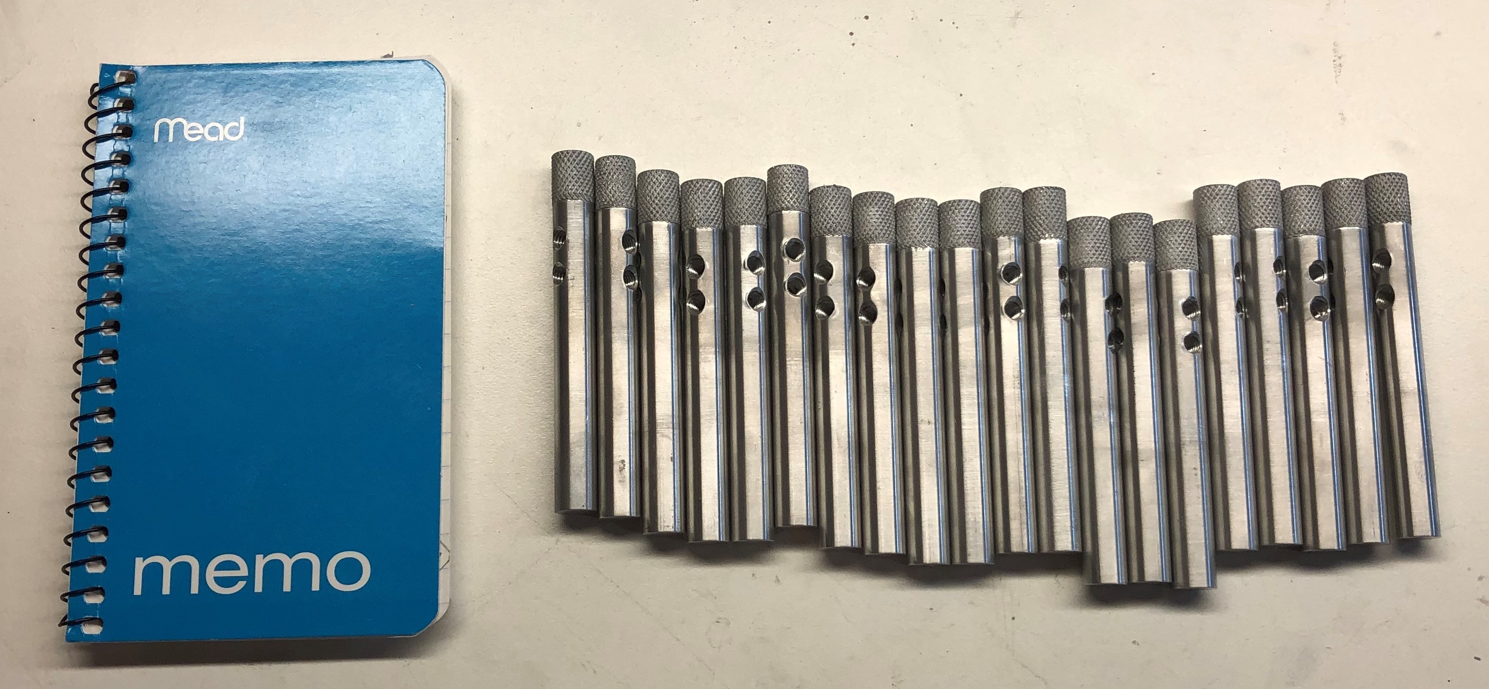

Side rods are done:

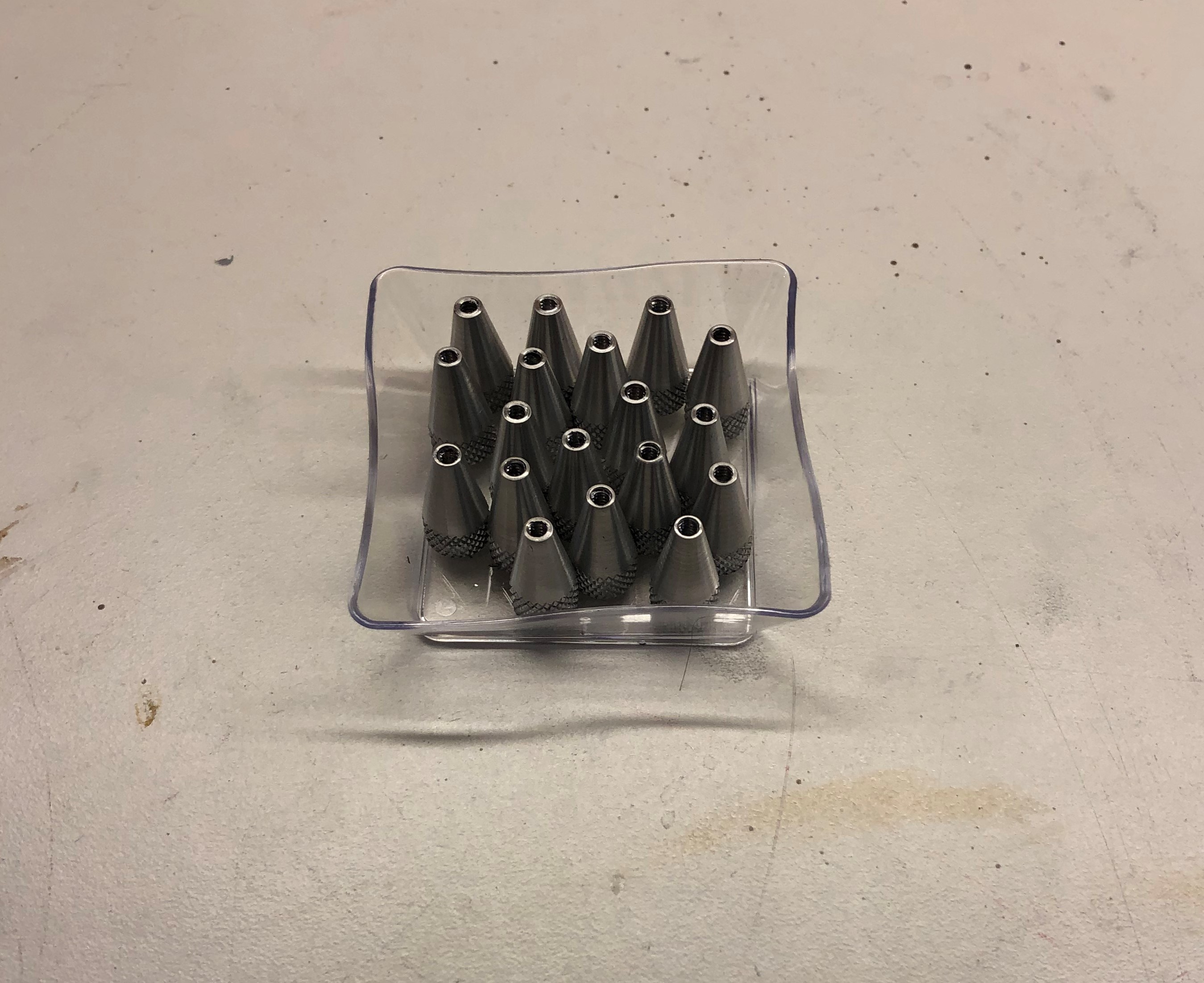

I've already started working on the points. I'm expecting those to take about a week or so to machine so I will put the pontoon mold on hold until next weekend.

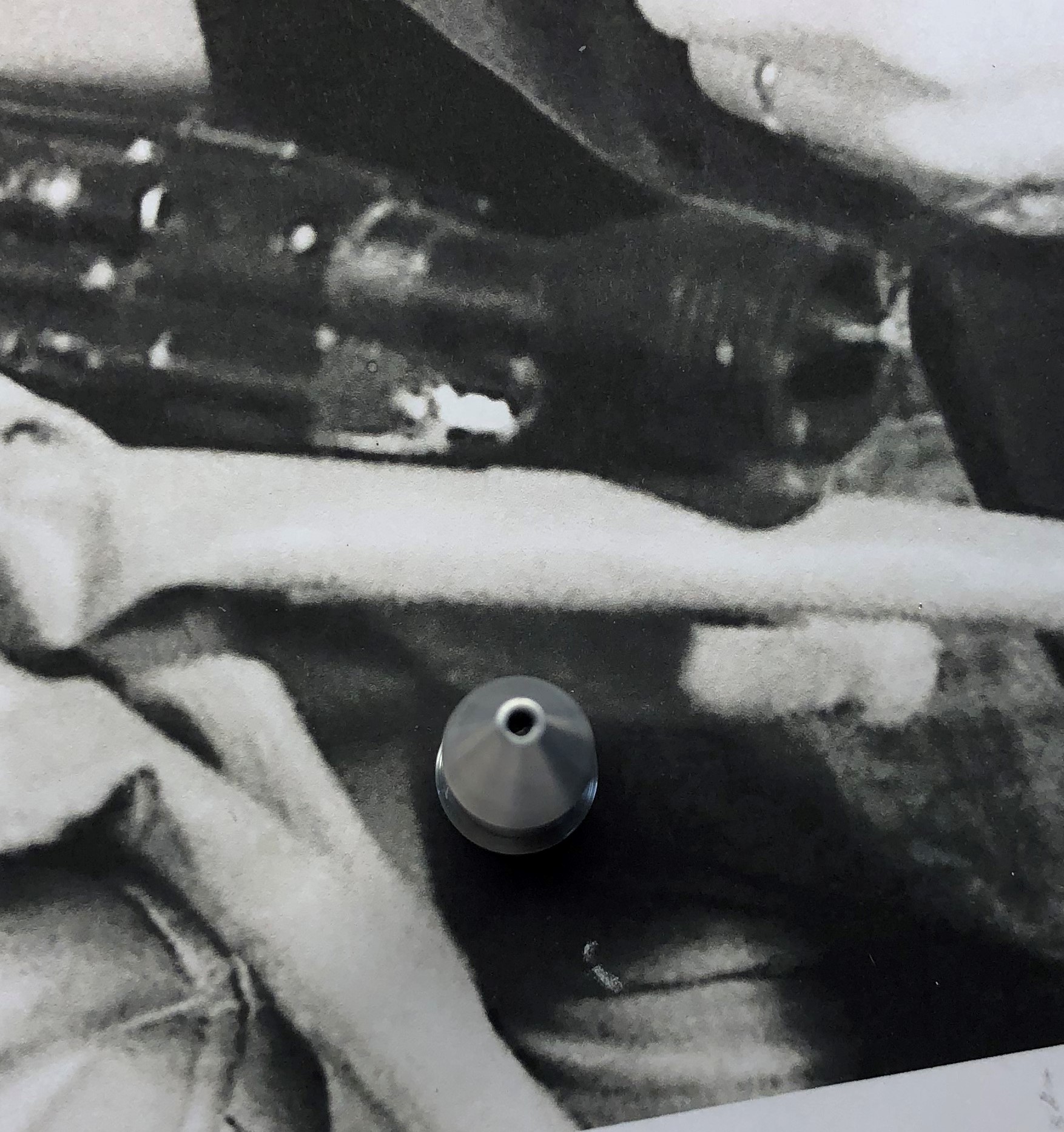

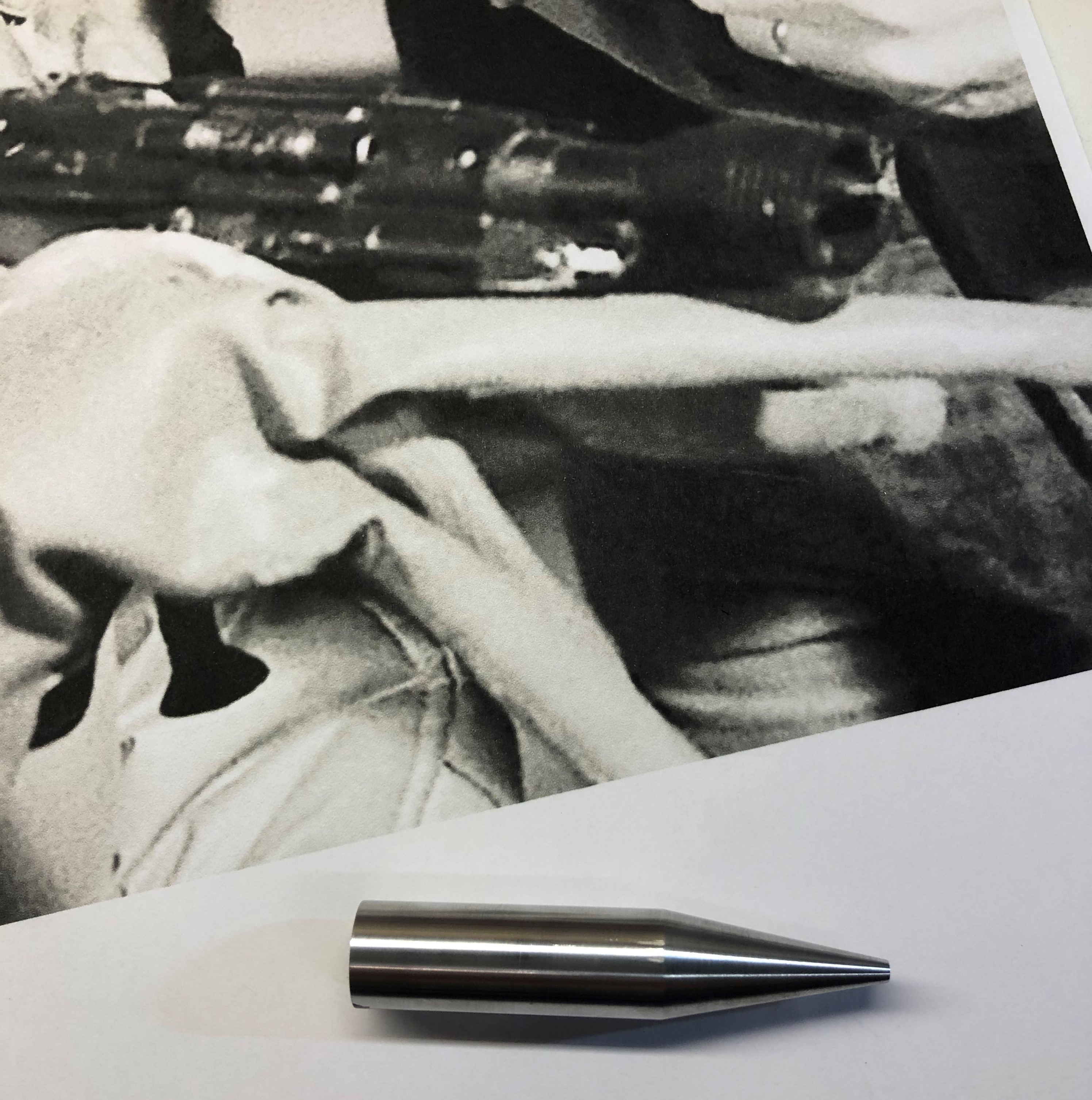

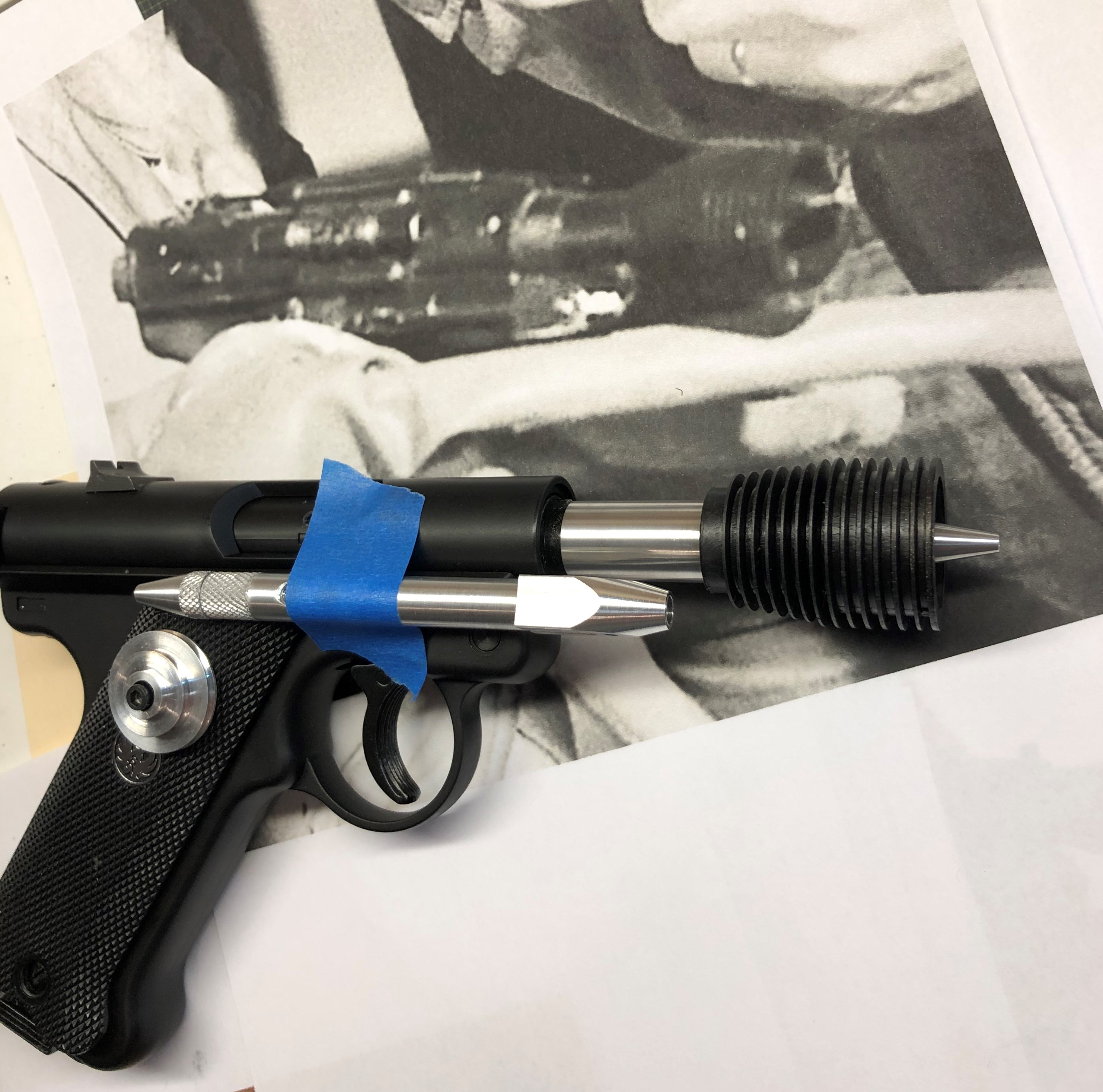

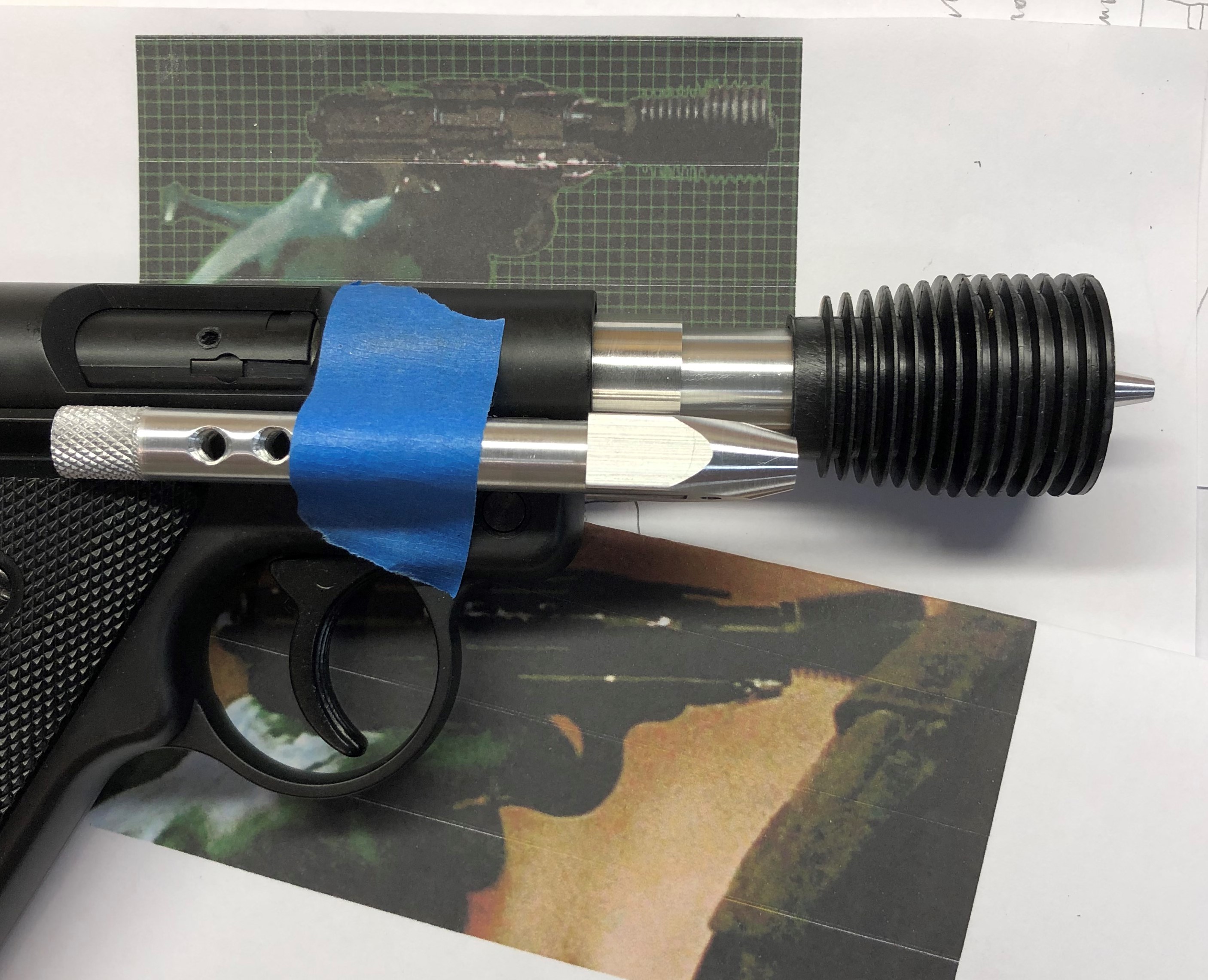

Here's some "early bird" shots of the prototype which is suppose to be for my blaster. My original idea was to machine a replica of an original stylus part and then test fit it in an original model part (flash hider). I discovered if I used a 5/8" drill bit (which is the inner diameter of the smaller end of the model part) the stylus part fit like a glove and sticks out of the end at the correct length, which is around 3/8" or 4 "fins".
So that it fits the replica Ruger correctly, the part needs to be cut down about 1/4" with a notch added. A "collar ring" will also need to be added. This may be something that can be machined into future parts, so it's just one piece.

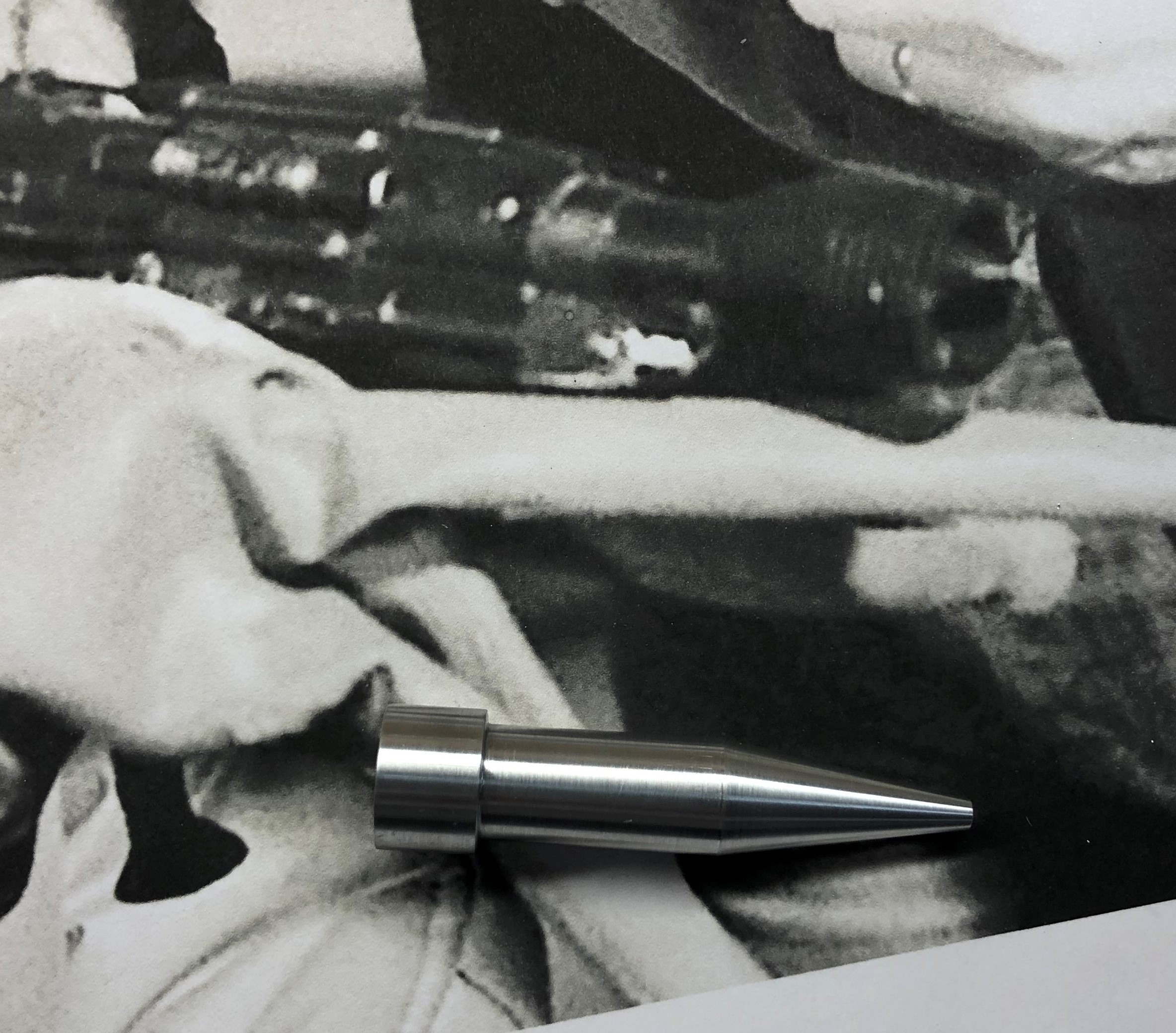

Here's a photo of the first barrel extension prototype that includes a ring. The next prototype will be one, solid part that includes the ring:

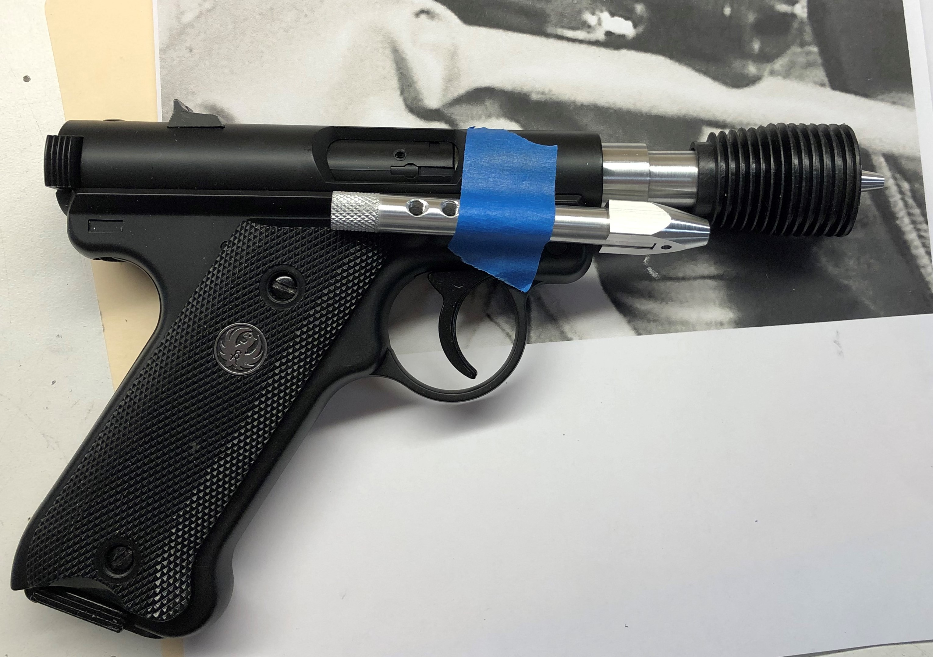

Barrel extension prototype #2:
Front:
Rear:
Installed:
One small item I forgot to include was a threaded hole with a bolt for easy installation. Because the Ruger MK I replica comes with a set screw for the existing barrel, this can easily be used with the Barrel extension.

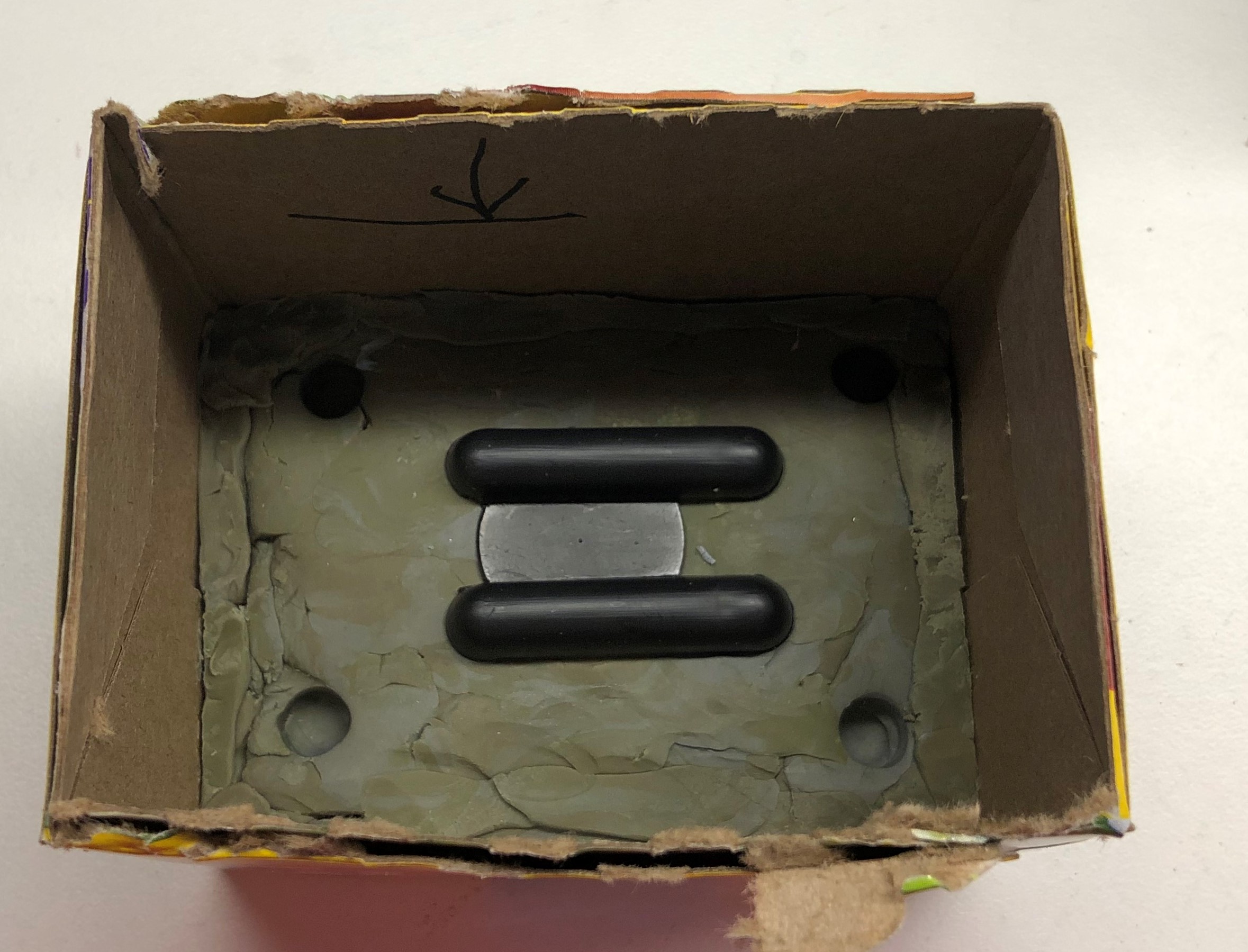

This will be a two-part mold so we can get all the nice detail on the flip side.

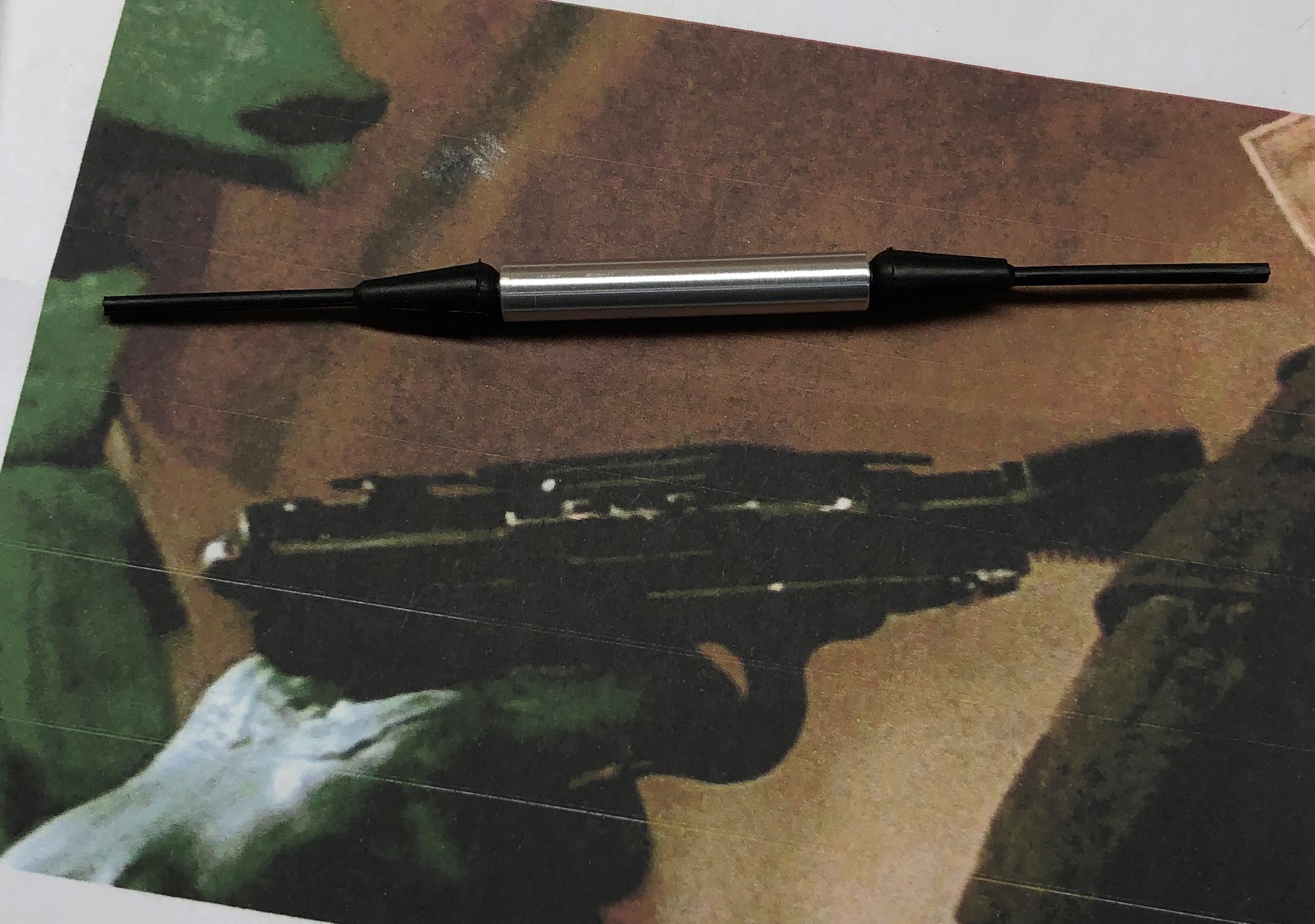

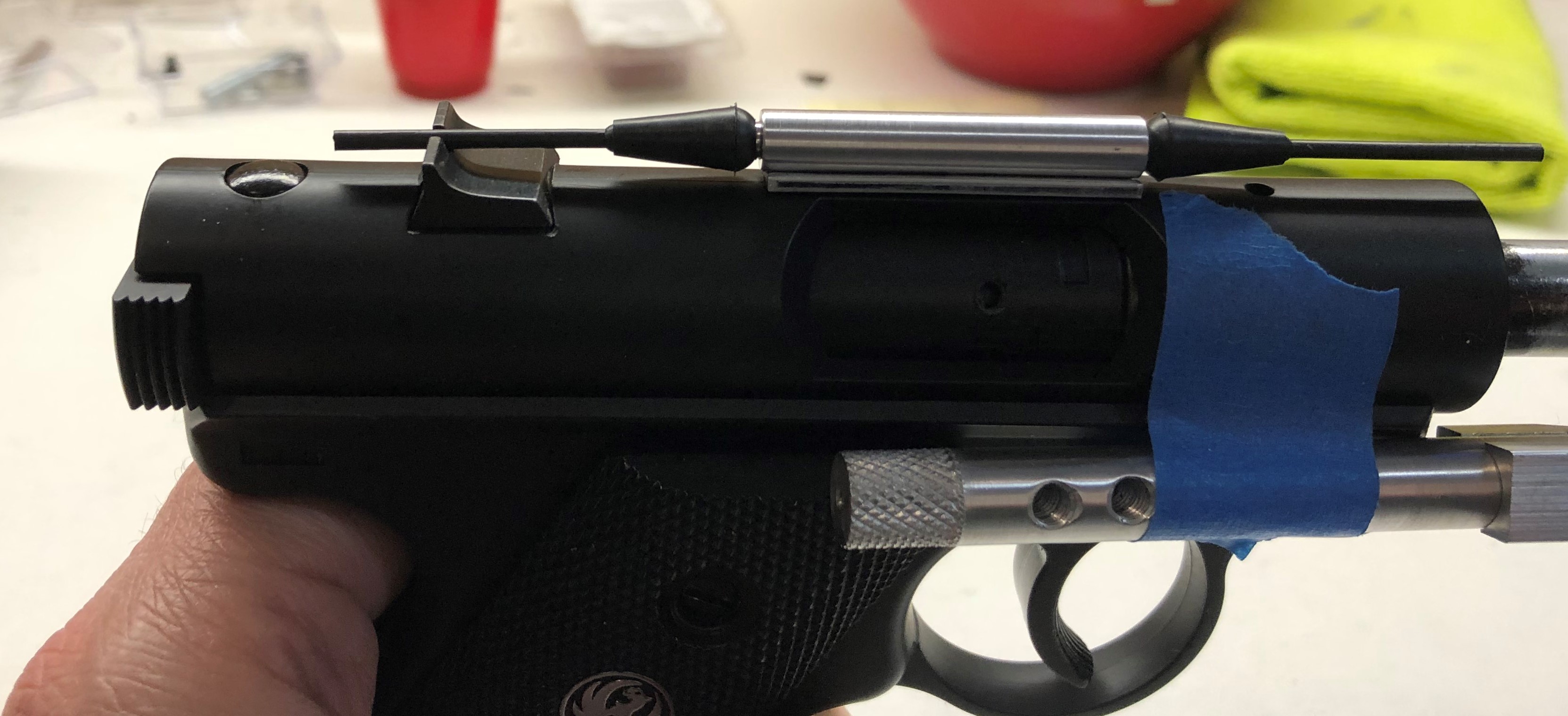

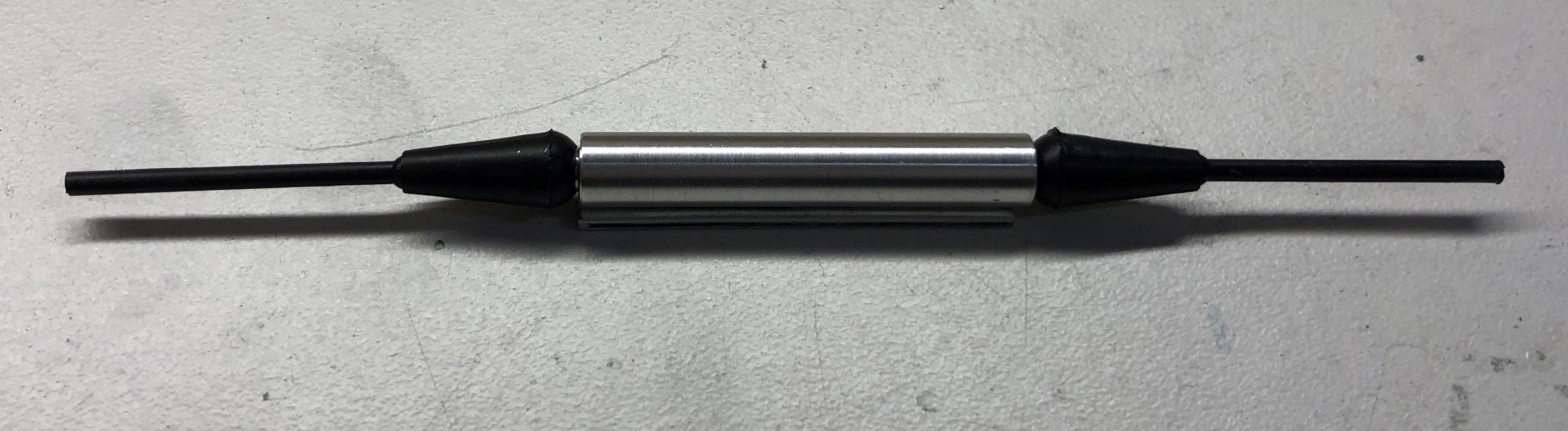

Sight rod prototype with Reade model parts:
And without the parts:
Price is set at $15 each. Once I do the actual run, I may be able to get that price down a bit, but it may even out once I add the mount.
Sight rod with mount:

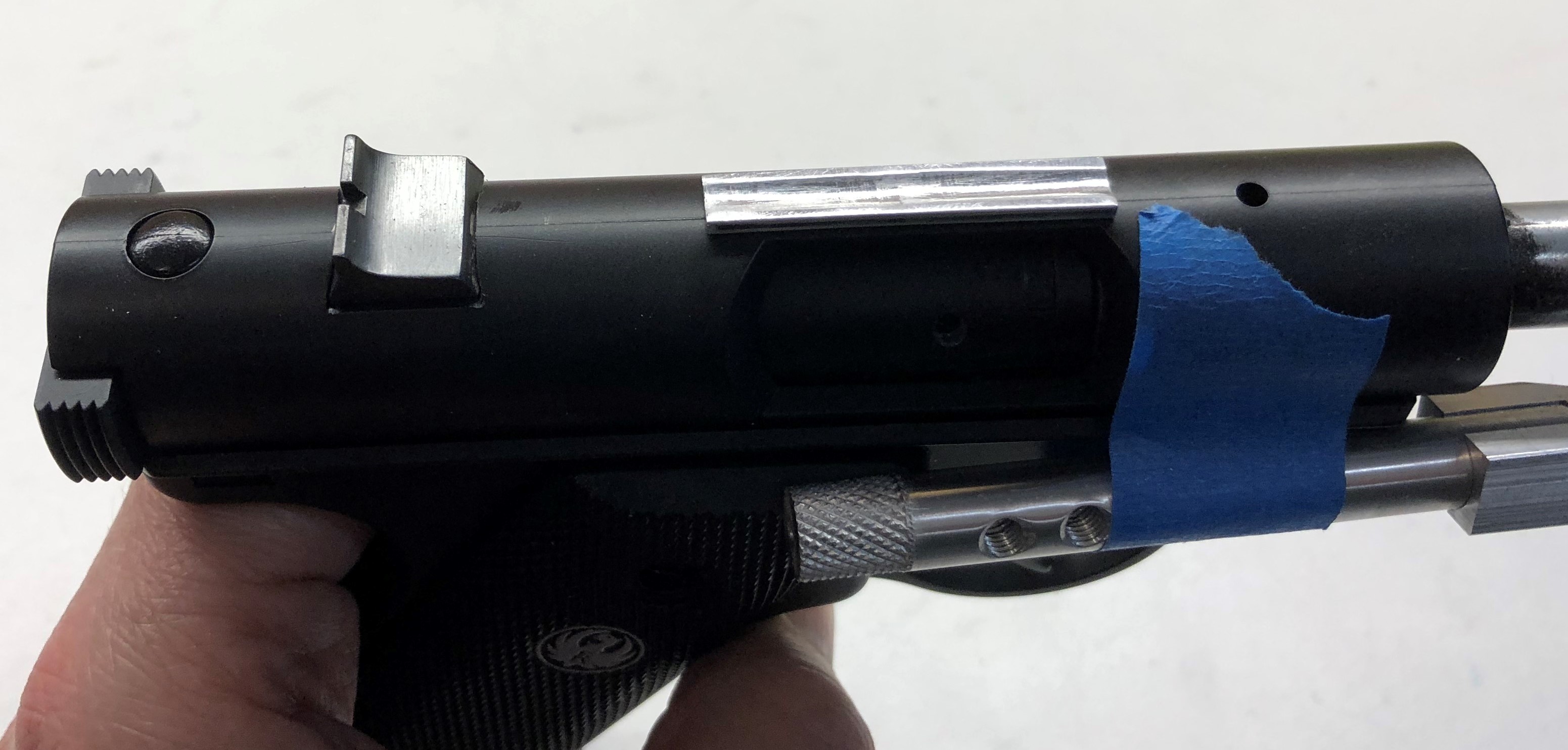

The mount turned out to be much thinner than I had originally realized, but despite that, I was able to machine two grooves on the top and bottom to help fit the sight rod to the gun barrel.

A mold for the pontoons has been completed. I'll be doing test pulls this week.

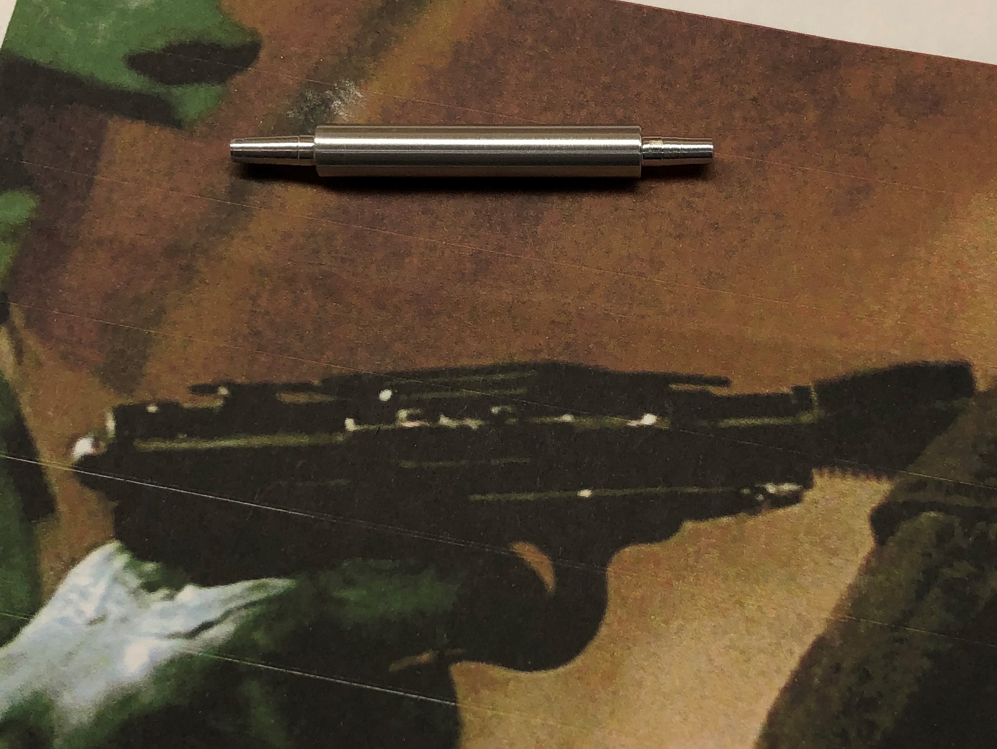

I also came up with an alternate way of machining the sight rods that may lower the price and provide a better way of attaching the model parts. I'll be working on that this week as well.
The mold turned out great along with the test pull.
I will post photos tonight. I think everyone will be very happy with these. :D
